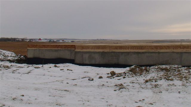

Well guys and gals it been a while but back at it, the pond is great, had a bad pour on the concrete basement, took a month to convince the contractor the concrete is poor, with open agregate and honeycombing its rough, figure its the enviroment of fast growth here in saskatchewan, too much work and little time, this week and next have a demolition crew removing the basement, then hopefully first week november re poured, we will miss the 15th november completion, looking like february now, have to dig a large hole for burying the concrete, my tractor will be buisy next few weeks, will take some pictures. On a good note our log home is standing, looks great but its 150 miles away and needs a home.

Laurence, Sorry to hear of your setback. Stuff happens. Hopefully you will be on site before and during the second pour to inspect the forms and observe the pour since the contractor may be in the mood to cut corners to salvage what little $ he can.
Bummer, dude, In by Christmas, roaring fire, etc. Oh well.
Much more important to get it right than to get it quick. You don't want the opportunity to regret at your leisure what you do or allow to be done in haste.
Hang in there.
Pat

Hi Pat, the concrete guy he used was told several times it did not look right, only told me it will be OK, well it was not, we had honeycombing all over, he got a engineer who as per building code the honeycombing can be 1 inch each side, in this case several areas were in excess of one inch so it comes out, I again will be watching the progress and definatly stop the guy if its not right, this was supose to be a no brainer and the first stage has issues, at least he knows what to do this time, figure the concrete guy had a few too many jobs on the go, cut corners and rushed the vibrating and this is the result. Digging a hole today, sure takes a while but at least we are out in the fresh air

Hi Pat, the concrete guy he used was told several times it did not look right, only told me it will be OK, well it was not, we had honeycombing all over,concrete guy had a few too many jobs on the go, cut corners and rushed the vibrating and this is the result. Digging a hole today, sure takes a while but at least we are out in the fresh air
There are WRONG ways to pour concrete that will tend to separate out the gravel from the "mud." One of many is improper use of a"back stop" board (typically a scrap of ply) to help keep the crete from overshooting the hole when dumping from a chute. Once separated out the gravel resists remixing by such methods as a vibratory concrete tamper and SHAZAM, honeycomb. I only got one very tiny little area of honeycomb, and it was just surface cosmetics, luckily. Wall was 12 inches thick so 1/2 inch of honeycomb on the surface of a small area was not too troubling.
Best of luck to you the second time around.

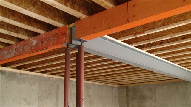

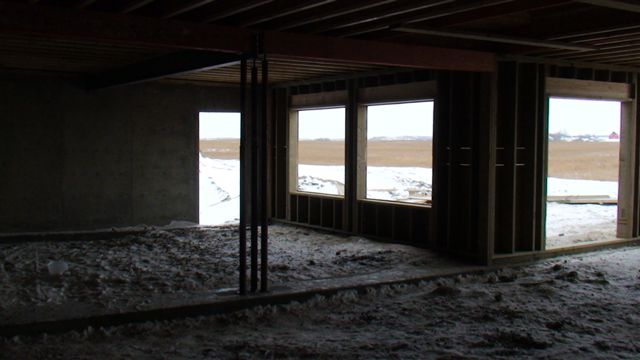

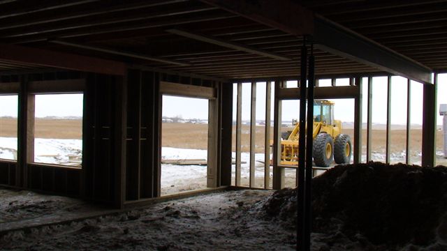

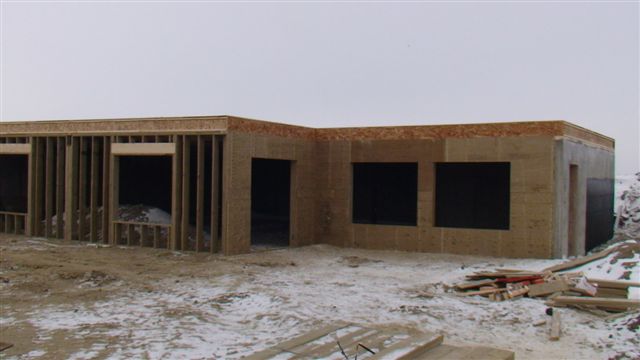

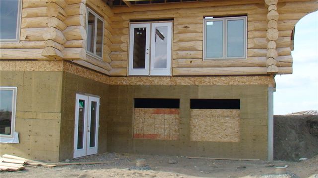

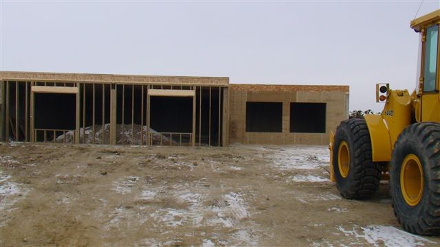

Well its going slow now, we demolished the first basement and re poured a second, way better and now we have the rear walkout wall built, floor above and the floor nailed good but then came the snow, we need good weather in the 0 to -10deg C, its been in the -20s last 3 weeks and lots of snow. These pictures were taken 3 weeks ago, today the snow has drifted in some 6 feet deep at the back

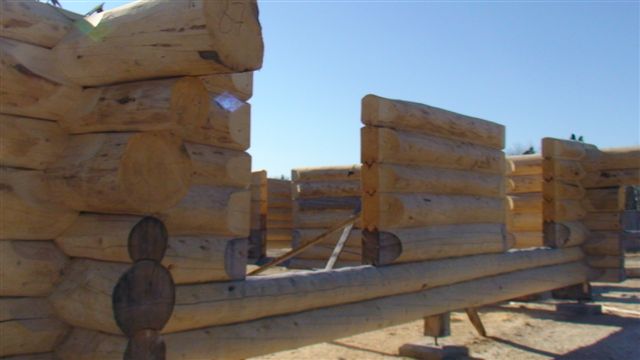

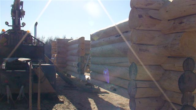

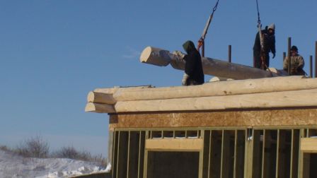

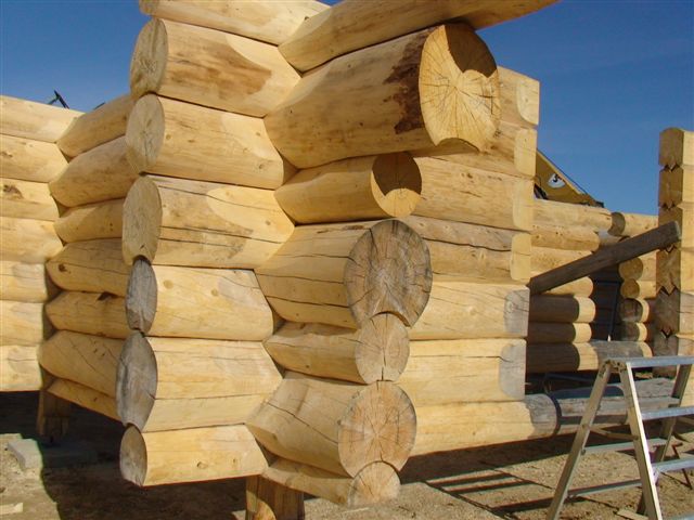

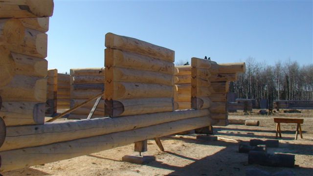

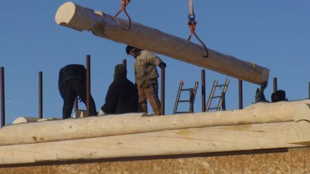

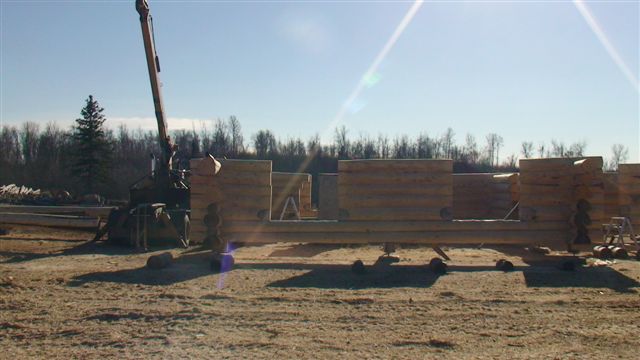

Here are some pictures of the log construction, it is being built about 175 miles north of us, then un assembled and like a large lego set assembled with seals and windows, thiugh with the snow here its looking like a project for early next year, we had a completion date of Nov 15th this year, we missed this, the basement was backfilled using a trackhoe and final to grade using the CK20, did not want heavy equipment packing the dirt around the basement walls due to pressure, nature will pack and settle the soil over time without point pressure on the walls
enjoy

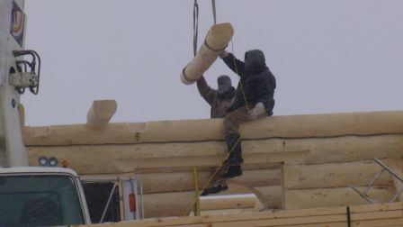

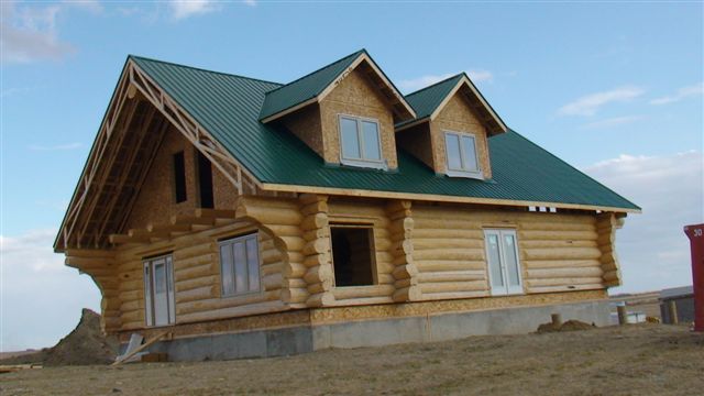

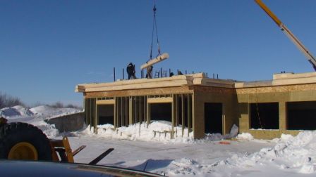

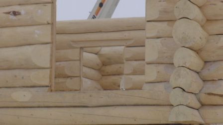

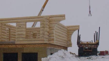

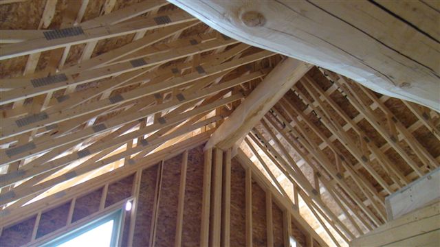

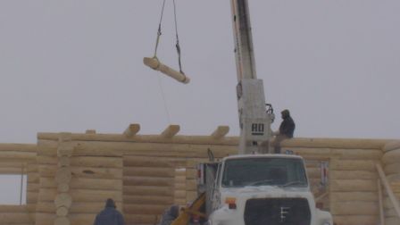

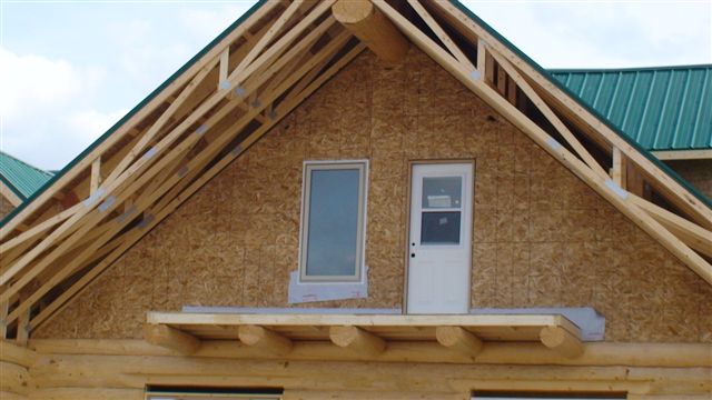

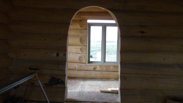

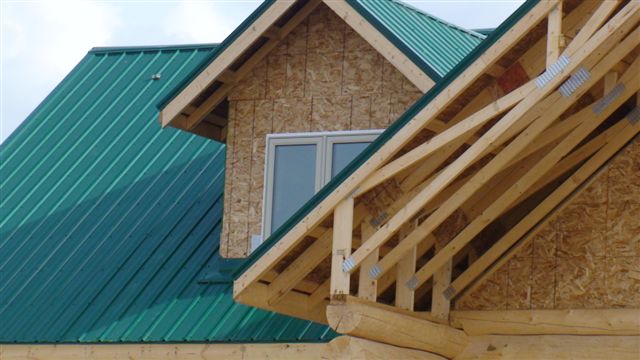

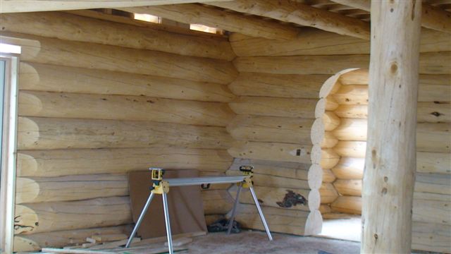

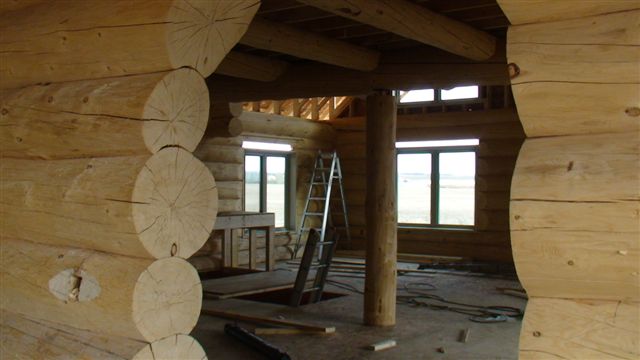

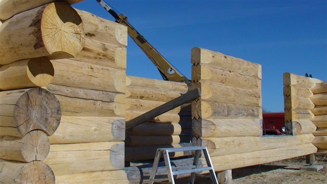

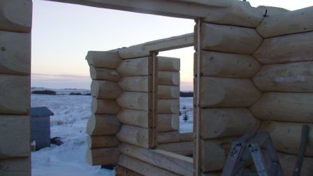

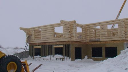

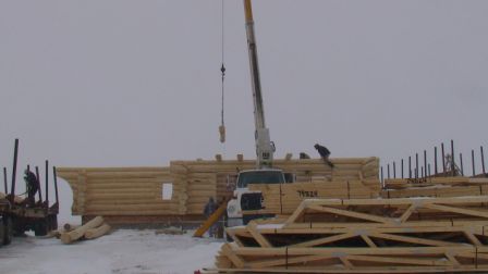

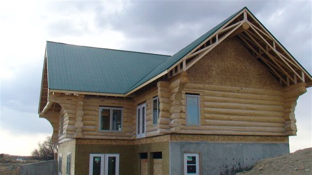

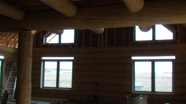

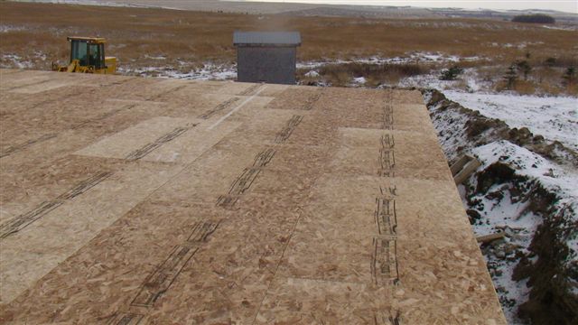

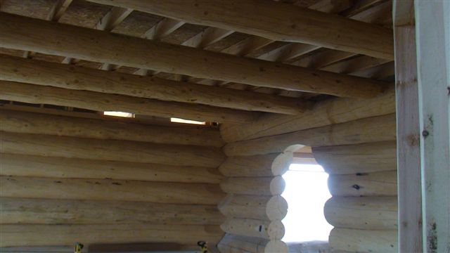

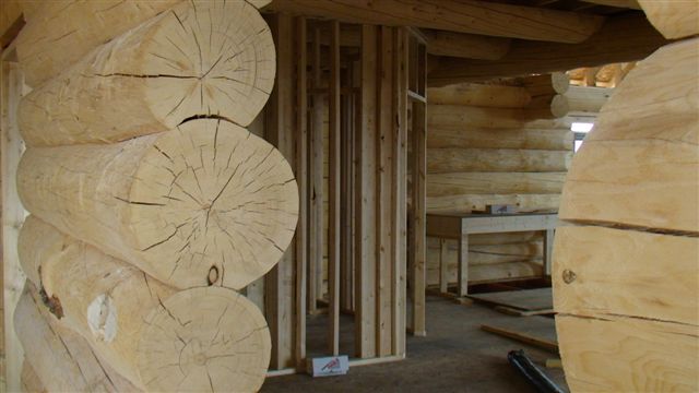

well its blowing snow and -20 deg C today and the last row of logs were set, saturday they set the second floor beams and the bulk of the log work is complete, its been a hard push with the project, sorry guys and gals my camera is a smaller SD card than the computer, will post pictures saturday night, by next week the roof trusses and all closed off, my CK20 is working overtime, the pictures will show the depth of snow, poor Deer 644 is out of action due to clod and no flow plugs.
/ log home and pond
#34

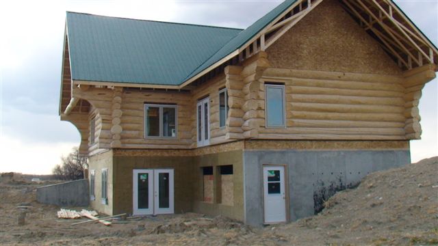

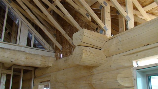

Well, here are a few pictures, the log work upto the second floor is complete, this week they will have the roof on and next windows, these guys braved -30 temperatures and strong wind, we had allmost whiteout conditions friday

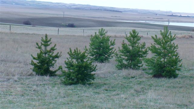

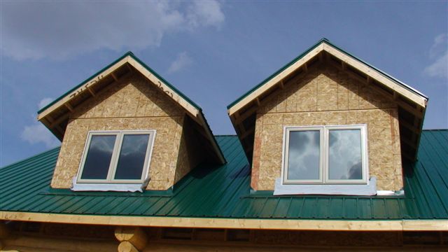

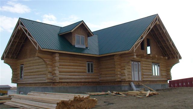

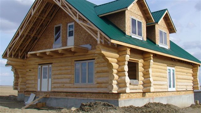

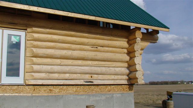

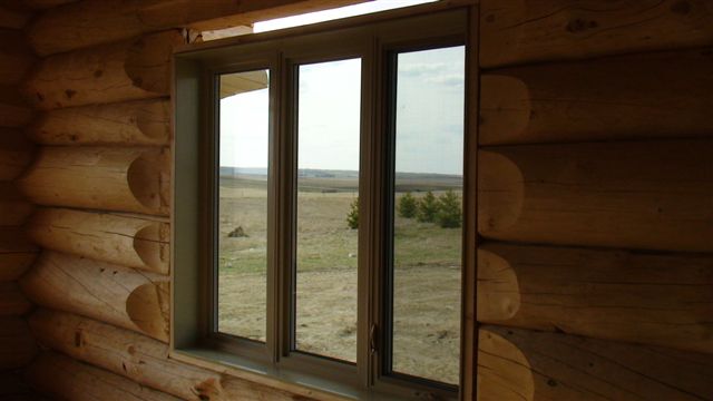

Well spring is here, work is progressing, the Kioti has been working with the backhoe planting several trees and trying to level the yard, here are a few shots as of last week, hoping to be in by year end
Laurence

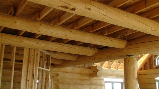

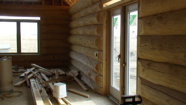

here are a few other shots

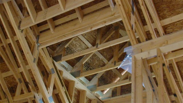

/ log home and pond #37
WOW, that looks great!!
/ log home and pond #39
Looking very good man.

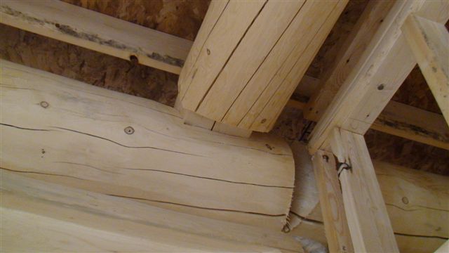

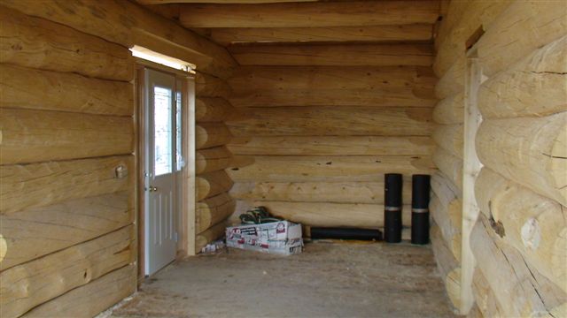

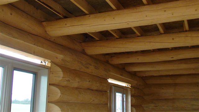

That's a lot of progress you made there. I see they're starting to finish the interior roof and such. It's very interesting to see the difference in log home construction between yours and mine, even in the style. Won't be long before you move in now. Mine should be done sometime in June this year.
/ log home and pond #40
Niiiiiiiiiiiiiiice! That's an interesting blend of construction styles -- hand-crafted log walls (instead of machined) but with a more conventional roofing system made of engineered trusses. I find the roofing most interesting...
A lot of log homes here in the US have gone to structural, insulated panels (SIPS) over purlins or rafters, or what's called a "built-up" roof where they deck the entire roof with T&G planks, then use 2Xs to frame above that, add the insulation layer beteen the 2Xs, then deck it again with OSB (or plywood) and roof it on top. Looks like your insulation will be installed between the trusses, then the interor ceilings (drywall or something) will be installed below that... I've never seen that method detailed. Please provide more pics as they complete that part of the project!
