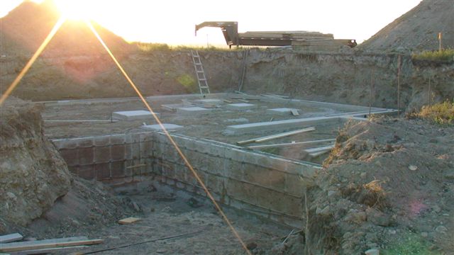

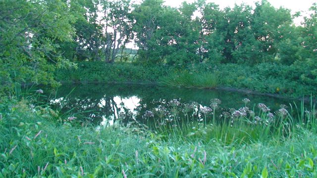

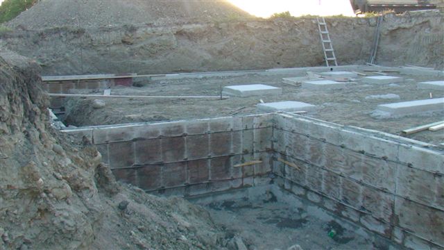

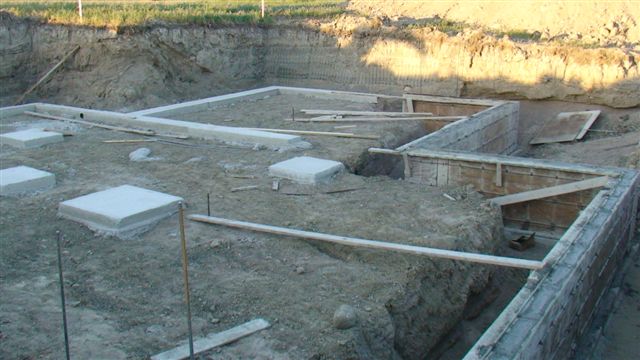

just a few pics of the pond, sunset from the soon to be sun room and foundation, forming the basement this weekend

for anyone curious why we poured a grade beam and wall below the basement floor in the 2 pictures, when drilling piles we ran into gravel at about 5 feet, there was no way to drill piles without it filling up so we dug footings and poured a wall, look at the picture 95 on the left lower you can see the gravel fallint into the trence leaving the 4 to 5 feet of clay solid, on the other side of the property I have been digging with the CK20 removing lots of gravel to build the road, there its about 2 feet down and the seam is at least 4 feet thick, who knew.

Picture # 95 with the sun behind the great pyramid of Saskatoon is quite spectacular!
Pat
Yes who indeed? I hired a soils engineer (PE) who brought out a sub with a drilling rig (for 6 inch diameter bore holes) and we took samples every 6 inches in depth. The idea was to be able to design a foundation from a position of knowledge and not just some good ole boys guess (standard practice around here is the good ole boy method). The engineer, his PE stamped report including the drilling sub's equipment and crew, lab work.. the whole enchilada.. was less than $1000 and bought a lots of peace of mind. It also tapped me into the PE's E&O insurance if there were some unforeseen difficulty.
We didn't find any useful materials, no free gravel, just ground water 5 ft below original grade where we were to dig a 12 ft hole in which to build a basement. We just had the wettest spring and summer since records were kept and the basement walls and floors remain bone dry. I credit this to the drain design the engineer recommended.
