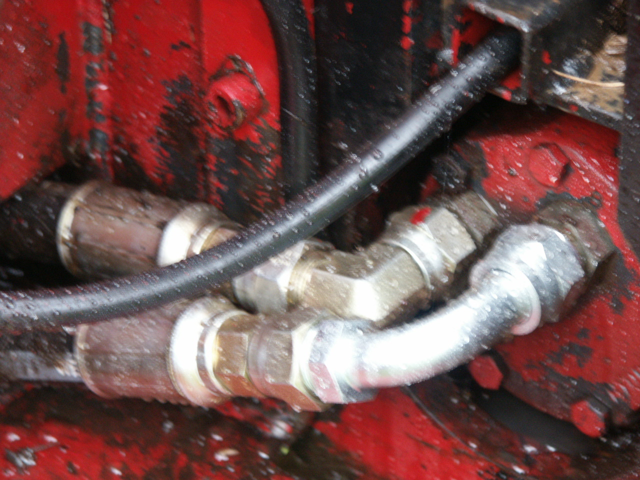

OK, now things are going to get weird.
First, I have no identification on my tractor as to serial or date. Those were removed. I need to dbl check with Ken, but who he (we) purchased from said it was a 2002 model. But, the guy was high as a kite so who knows.
Second, I do not have a visible brake system like the that 1850 that had been rolled in the lake. I just have wheel motors.
What has me really confused is that my wheel motors have 3 hoses runing to them (as I remember). Two large and one small. I always thought the small was the brake system, but it has to be the overflow/purge/whatever the name is I cannot remember.
So, I have NO clue how my systems brakes work. Here is a pix of the front drivers wheel and the hoses I see going to it (taken some time ago).
Maybe there is a 4th line (Case Drain, now I remember) that is hidden from this photo... Ken, Peter?

My 1445 has spring applied brakes internal to the hydraulic motors. They were the #1 reason that I bought a 1445, the #2 reason being that I didn't think I needed the 45 degree slope rating on the 1850. Whenever I spin out on a steep slope, I revisit that decision, but I have no plans on selling my machine!
