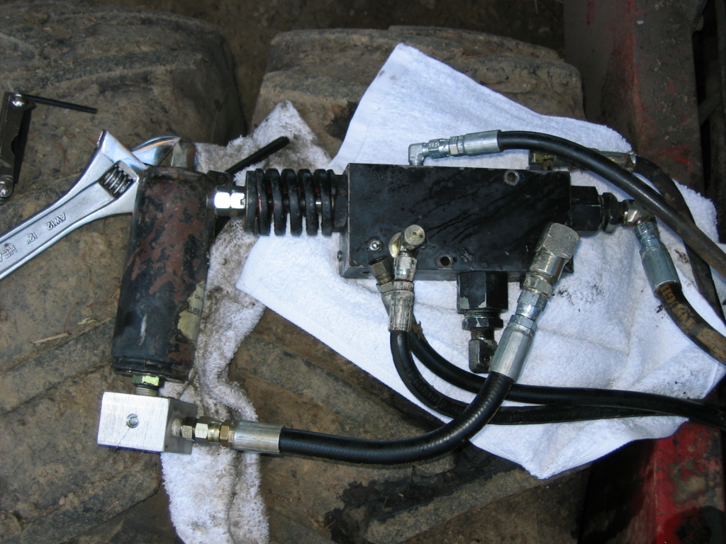

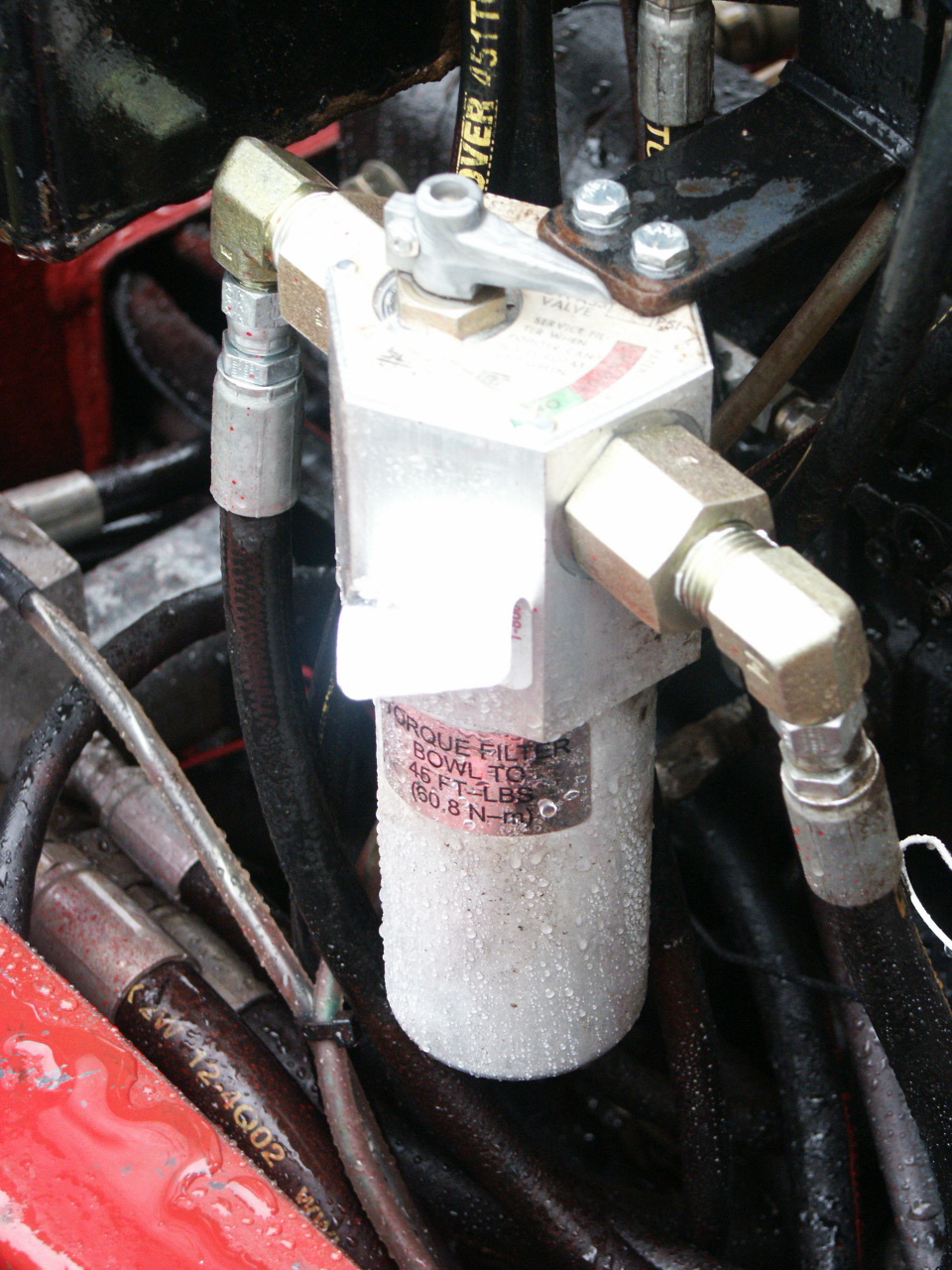

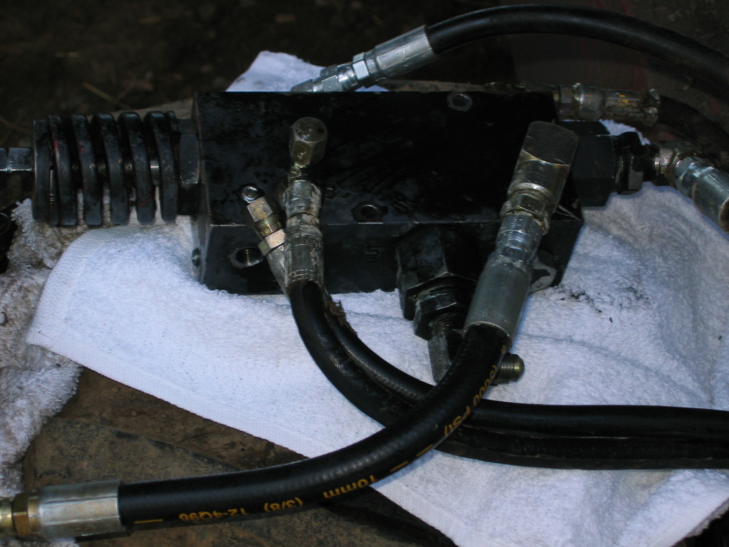

The block does have a name, it is in my manual but my manual is up north. I think I posted it in my tirade about this. I did the same thing, removed the elbow, pulled out the cap with the pinhole. I think the block is Aluminum, at least mine is.
I am really interested in what is going on with yours and what your resolution will be.
http://www.tractorbynet.com/forums/power-trac/130827-problem-lift-tilt-dump.html

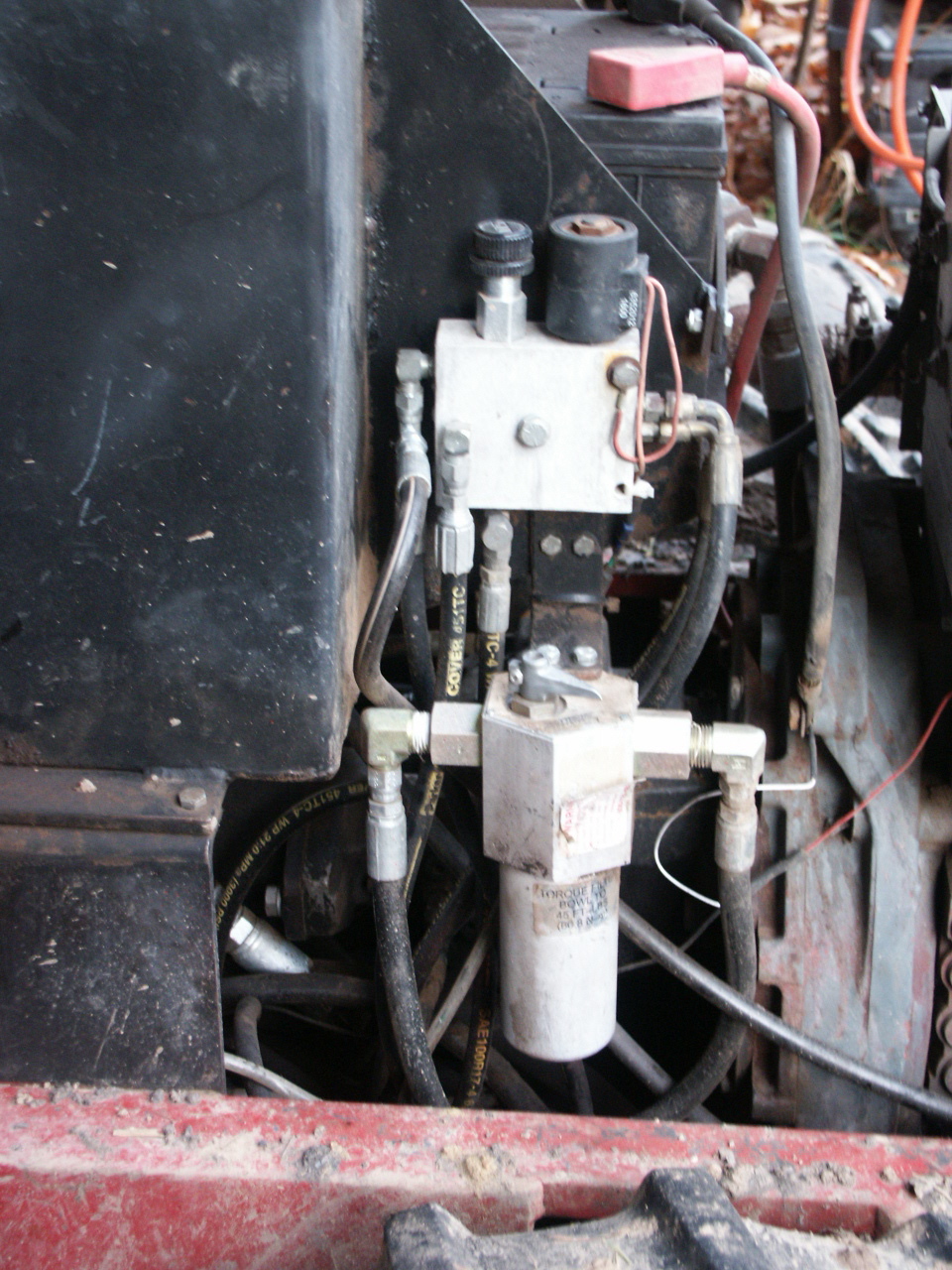

Here is a picture of the block removed, as well as a picture of my High Pressure filter.. It is located on the gas tank next to the battery under the draft control.
yes, this is where the tender hooks up. But it hooks up before this little pinhole valve, so the brakes will work but nothing else. Frustrating not having a diagram.
