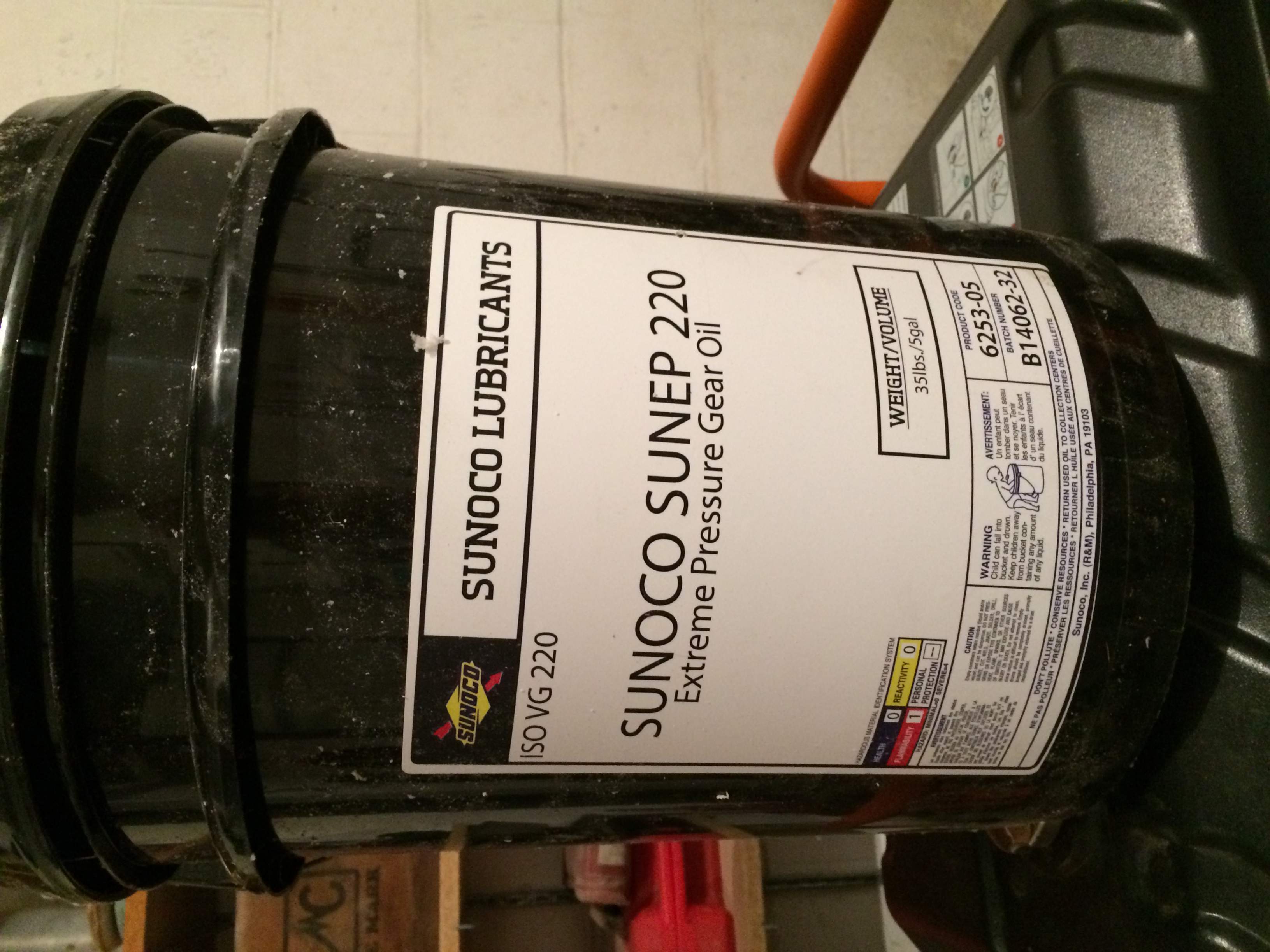

I purchased a 5 gallon bucket of AGMA 5 EP / ISO VG 220 today and used my 5 Oz from it so if anyone wants to buy some contact me through my Craigslist ad. Thanks! Jon
