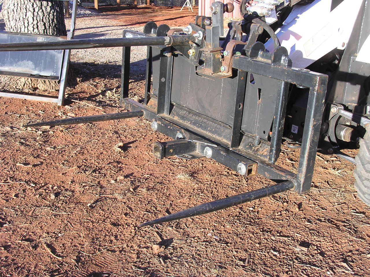

I can vouch for how handy the UltraFork is. It should work fine for the 4" bales.
I had to add a longer spear for the 1400 pound, 5x6 bales that we use.
I added angle brackets for picking up the 2000 pound feed bags, a light duty receiver hitch for moving bumper pull trailers and a heavy duty receiver hitch for gooseneck trailers.

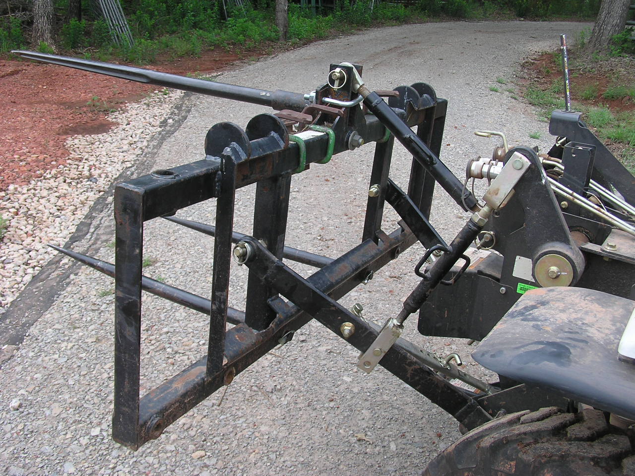

Put chain hooks on that fork...you will never regret it. I note that there is not a "roll back" barrier...so DO be careful when lifting ANYTHING very high....it can come back on you.
Putting a hydraulic top link on the tractor could be the single best additional item...really helps in getting the right "tilt" when using a bale fork on the 3ph. I have one, highly recommended.

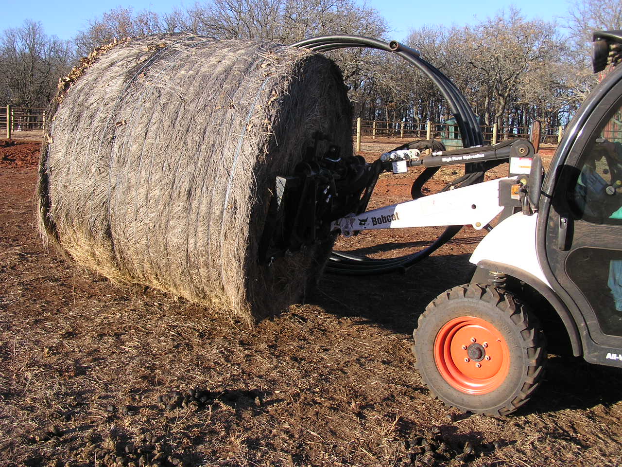

Xfaxman -
Thanks for the pictures and the recommendation!! I think for our use it will be a very handy item as well.

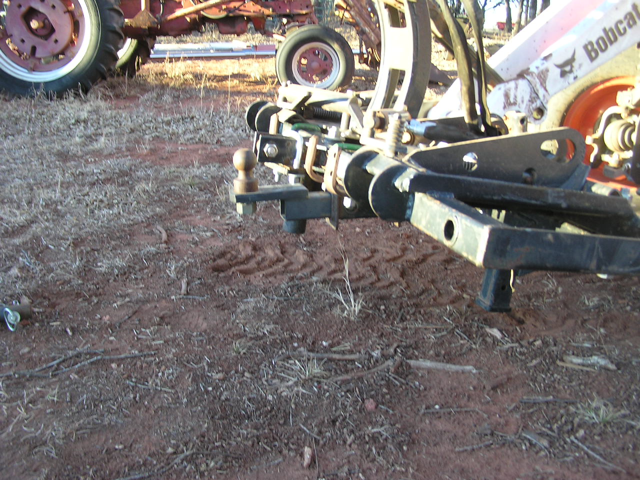

This is how I do it.... I put a rear mount (3ph) spear on the back and spear up a round for ballast then I have a front spear that goes on my bucket so one on the back and then one on the front. Got both spears at TSC BTW. Now, I typically handle high density 4x6's but my tractor is much larger than yours. (Kubota M9000).
I'd go with the front and rear spears plus the rear spear has a 2 1/2" ball on the top for moving gooseneck trailers around....

I have the Bobcat vesrion of the CK27, same frame & wieght but little different loader. I handle 4X4 mixed grass bales 1 per week with no problem. My R1rear tires are filled and set out to same outside width as R4s. I have on ocassion picked up a bale to feed with no rear ballast but when I do I make sure I am not lifting to dump it in the bunk while setting on any side slope. My loader is rated @ 1480 lbs. compared to your 1074# but my max lift height is 3" less. Stability at full lift height is part of the capacity calculation, no idea how much the additional 3" lift reduces actual abilty.
I have no problem in height to unload from a trailer. My hay supplier brings it in on 30" Goose neck trailer and loads 2 high on traailer plus 1 bale on the upper deck and I can lift them off easily.
If you get that combination fork/bale spear, spear the bale to pick it up. Much easier to pickup and keep control of the bale versus using pallet forks. I do use my pallet forks occasionally but seldom, bale spear works so much nicer.
I will be getting some 4X5 bales later in March because my regular supplier ran out. I know I can pick them and move OK, just have to go slower.
For the few bales you plan to handle you should be fine, just don't get in a hurry and use adequate rear ballast on the 3pt.
