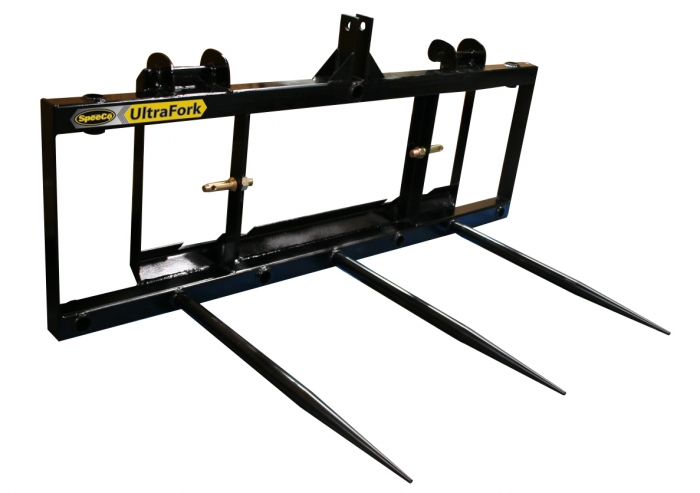

Right now this one (SpeeCo Ultra Fork) is my leading choice as we can use either the loader or the 3pt as the size/weight dictates for bale movement, still have limited pallet fork capabilities, and also use the forks to move some brush / debris.
Thanks again for the advice and info. Please keep it coming.

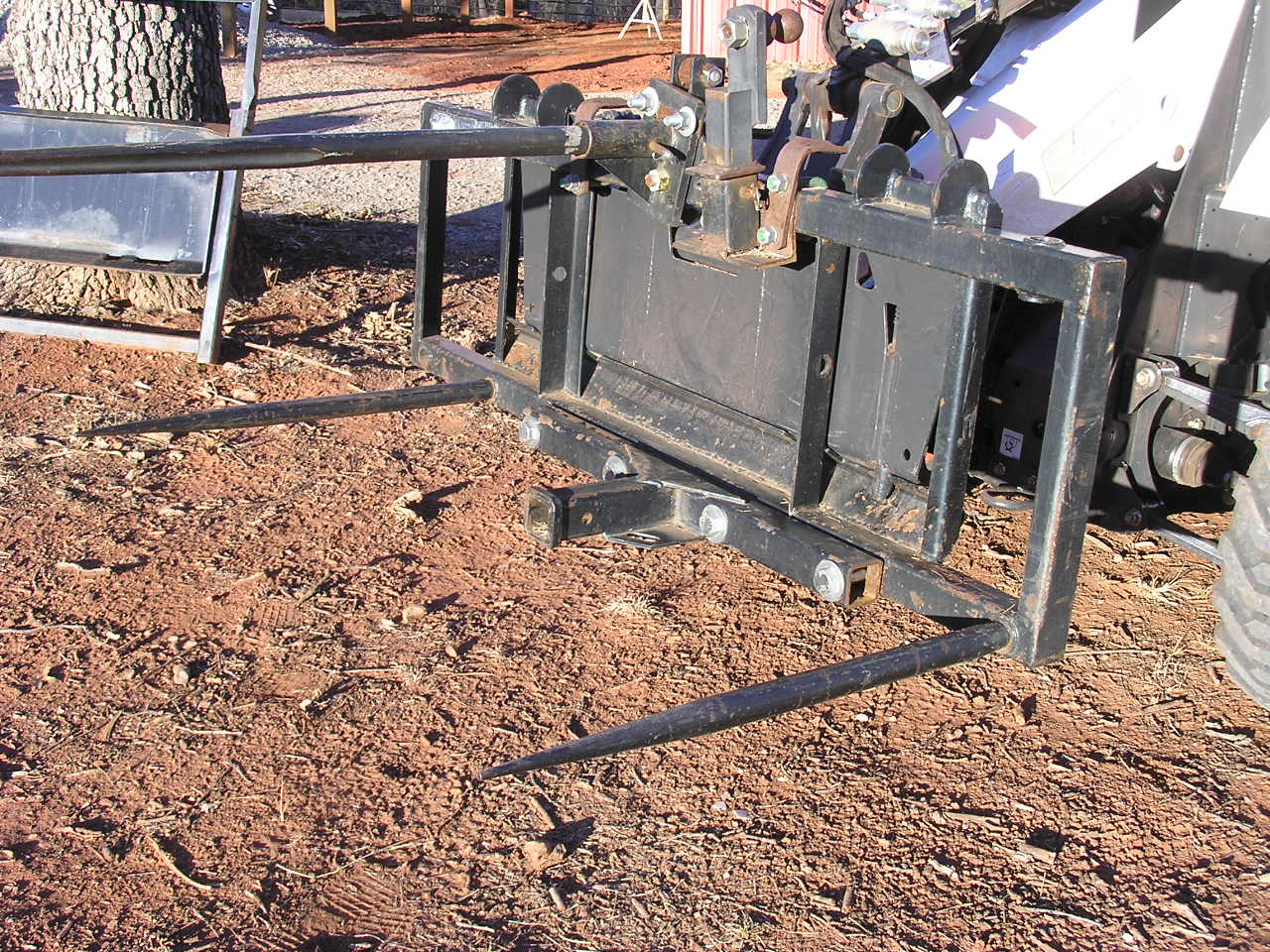

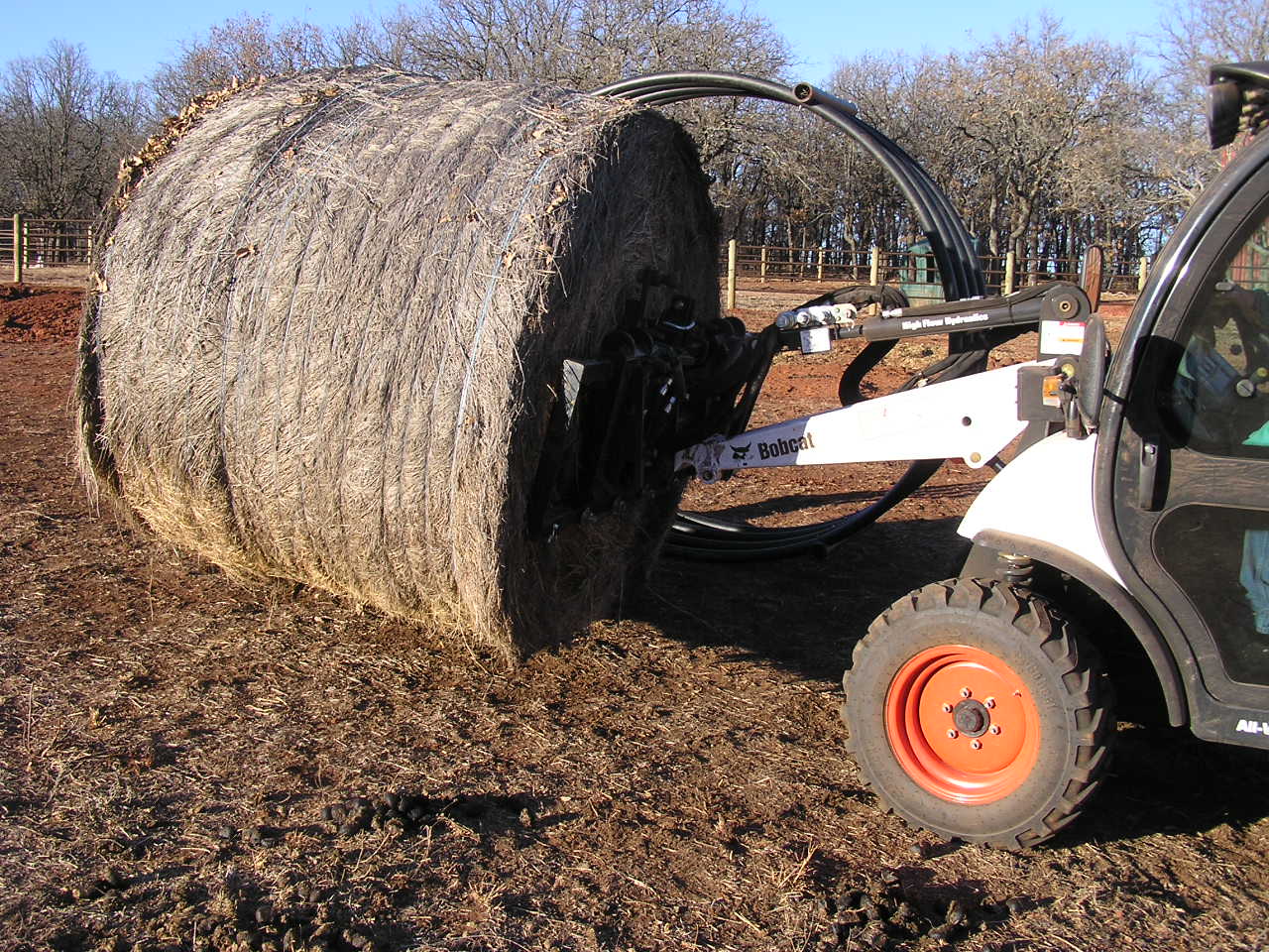

I can vouch for how handy the UltraFork is. It should work fine for the 4" bales.
I had to add a longer spear for the 1400 pound, 5x6 bales that we use.
I added angle brackets for picking up the 2000 pound feed bags, a light duty receiver hitch for moving bumper pull trailers and a heavy duty receiver hitch for gooseneck trailers.

Xfaxman -
Thanks for the pictures and the recommendation!! I think for our use it will be a very handy item as well.

I have the Bobcat vesrion of the CK27, same frame & wieght but little different loader. I handle 4X4 mixed grass bales 1 per week with no problem. My R1rear tires are filled and set out to same outside width as R4s. I have on ocassion picked up a bale to feed with no rear ballast but when I do I make sure I am not lifting to dump it in the bunk while setting on any side slope. My loader is rated @ 1480 lbs. compared to your 1074# but my max lift height is 3" less. Stability at full lift height is part of the capacity calculation, no idea how much the additional 3" lift reduces actual abilty.
I have no problem in height to unload from a trailer. My hay supplier brings it in on 30" Goose neck trailer and loads 2 high on traailer plus 1 bale on the upper deck and I can lift them off easily.
If you get that combination fork/bale spear, spear the bale to pick it up. Much easier to pickup and keep control of the bale versus using pallet forks. I do use my pallet forks occasionally but seldom, bale spear works so much nicer.

Wow!! $675 for the UltraFork. Ouch. Think I'd rather buy a cheap(er) 3pt spear and put the rest of the $ toward a grapple. LOL
