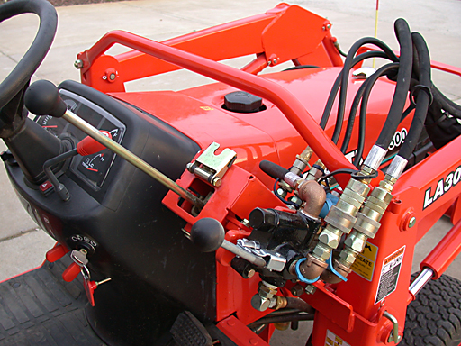

ok i dont mean to sound dense but how do i add that to my tractor? i only have 4 lines on my tractor loader up and down and curl. Mabey i am just confused to where the 3rd function would connect. I am starting to get what your saying, it goes inline and on my curl remote i put a momentary on switch to power say a selonid valve?
Do a search in the hydraulics forum for the term "diverter"

You're on the right track. The solenoid valve will have 6 hose ports. 2 will connect to the normal curl cirucit of the laoder valve, 2 for staight thru (open) will connect to the curl cylinder, the other 2 will connect 1 line to each of the single action cylinders on the plow. When hold down the button move your curl to lever to angle the blade.

i already have one solenoid valve, can i just get another one and make my own diverter? I can place a momentary on switch on my remote's controls to power the solenoids? I have to check to see if the valve i have already is a 2 or 3 port.

Now I'm the one not following you... Most loaders I am familiar with have a joystick valve that has up-down and L-R movements to control the bucket raise/lower and curl/dump. Is yours different? Perhaps you can post a few pictures of your setup so we can see what you are talking about better.
The attachment shows the use of a diverter valve, from Fasse - the guys I bought mine from.

I cant find my digital camera i will take some with my phone. No i have two levers next to my seat, one controls my up and down on my main rams, The other controls my curls, like i said my system is alot older then most of these forums, i will have to get some picts in the am.
I was thinking if i got my self one of those multifunction controls like you got, then again i cant i dont have live hydraulics.

This photo shows the controls for my remotes.
The controls in the back control the pto and the three point lift.
The next two photos show the remotes.
/ Loader Snowplow #31
Sorry man, but I have no clue what I am looking at...
/ Loader Snowplow
#32
in the first picture the inside lever controls my lift the out side lever controls my curls. The back picts are where the feed and return lines attach for the loader.
/ Loader Snowplow
#33
so as you guys can see my valve body is in the rear end of the tractor off of the main pump. I dont have the normal multicontrol stick of the new style loaders. I am thinking if i wire up some selonoid valves i can still do it off of the internal pumps, I would have to do it on the curls.

With that said, a diverter is what you are describing. You "divert" the bucket curl/dump to another function (usually a grapple open/close) temporarily with an electrical solenoid that diverts the hydraulic flow from the curl dump to your auxiliary circuit. It seems like it would work with what I THINK I am looking at, but I just am not that experienced to figure it out by a couple pics over the internet. Sorry man

I added a 3rd remote to a setup similar to yours (I think). Purchased from "Add-a Valve". I mounted the valve bodies (I think they're just an electromagnetic switch) up on the cross bar of my loader frame (sort of where my hydraulic lines already were). I put the valves "inline" with my curl function (ie - tapped into those lines for hydraulics) so hydraulic fluid goes thru the valve to my curl cylinders UNLESS I hold down the button on my curl function lever while curling - then the 3rd function gets the hydraulic flow instead. Works pretty good - the weakest part of the whole setup is the button/handle that came with it to mount on my curl lever.
