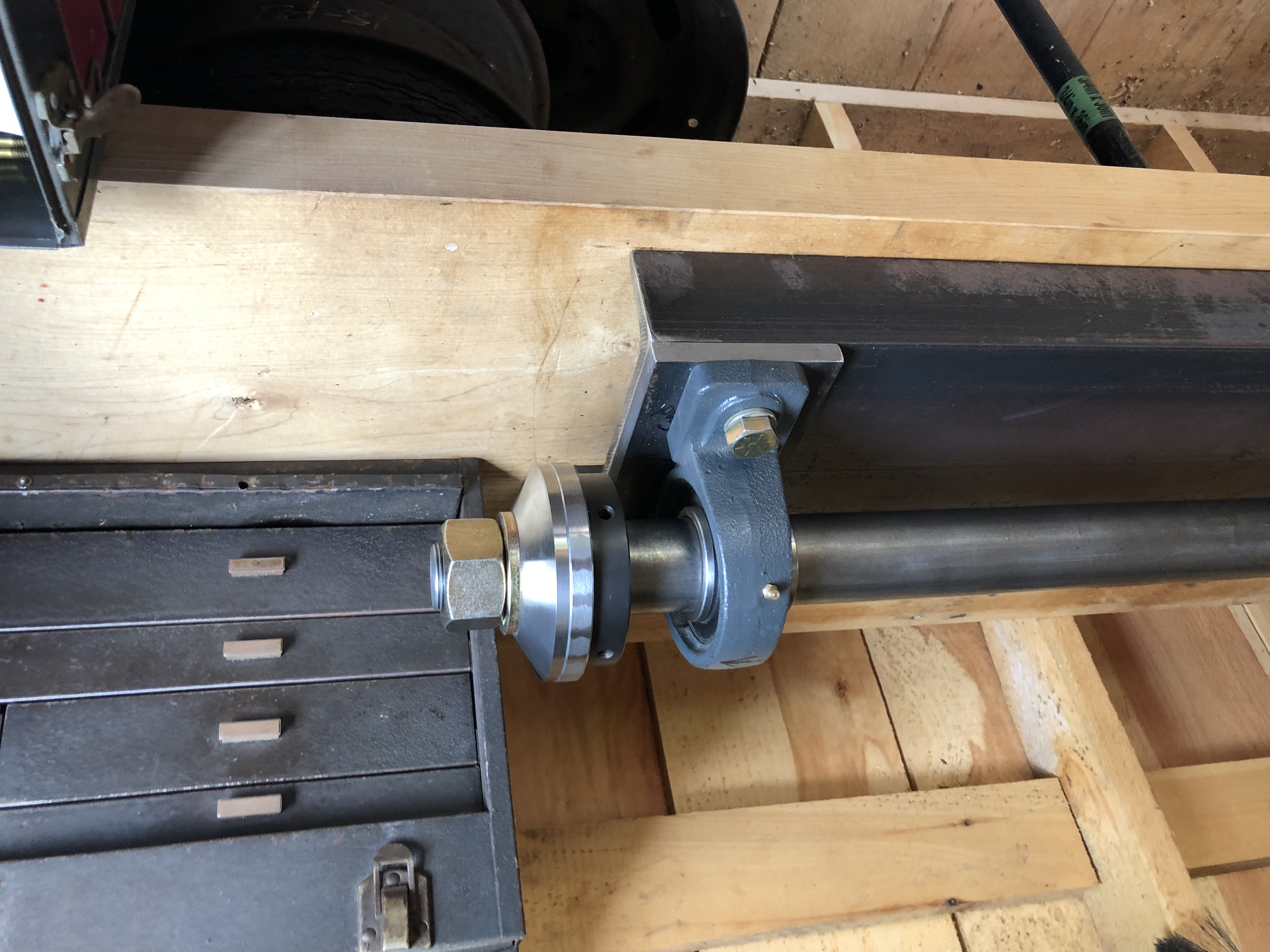

Hopefully this photo will help. 2 shaft turned down to 1.375 to accept saw blade bore. Milled a key seat in the turned down portion and used a keyed chain sprocket with the teeth knocked off as a drive flange. Then a big custom washer under the nut to spread out the clamping forces C9A34A01-B743-4A95-B2C0-E8E42CD87CC5.jpeg
   / Loader mounted brush saw #12
Hopefully this photo will help. 2 shaft turned down to 1.375 to accept saw blade bore. Milled a key seat in the turned down portion and used a keyed chain sprocket with the teeth knocked off as a drive flange. Then a big custom washer under the nut to spread out the clamping forces View attachment 590177
What rpm hydraulic motor are you using ?

Calculated RPM at my flow rate came out to just North of 700.

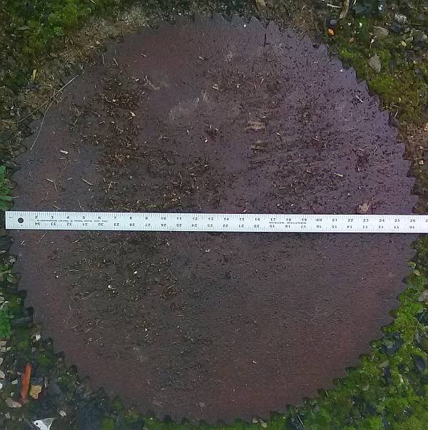

If my math is right, at 700rpm, that 30” blade is turning at a rate of 1100 inches of cutting teeth per second.
I don’t know what OP’s hydraulic flow rate is, but I bet that motor is developing at least 5hp. I bet that blade will go through a 4” tree limb in about 2 seconds without even slowing down.

Exactly! When I designed it I calculated 66,000 inches per minute. Which happens to be the same as 1100 inches per second. I liked the IPM number because it’s bigger and sounds more impressive :laughing: but yes it’s theoretically about 6 HP if I remember all my original design details based on flow and pressure when I speced the motor. And I have cut some pretty big stuff with it no problem.
   / Loader mounted brush saw #20
Andy, do you know what that type of blade is called? It doesn't have any "hook" to the tooth like a crosscut, rip, or chainsaw, so it's probably not as grabby. In fact, it looks like it would cut as well in either direction.
