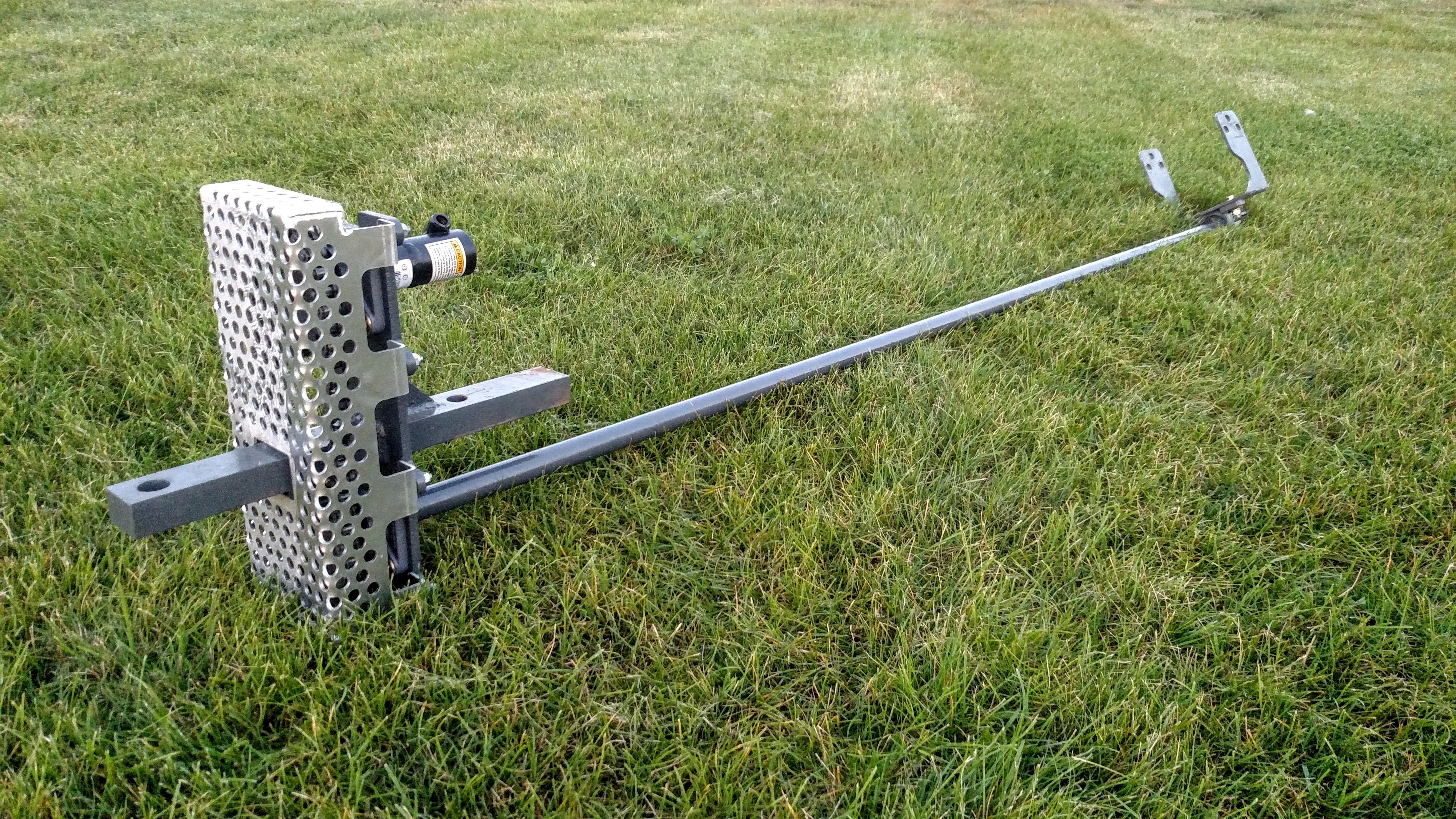

So, I decided to run the blower off the rear PTO of the tractor, which has the added feature of being able to run at either 540 or 1000 rpm. That way, if the snow is light enough, I figured I could run the tractor at half of PTO rpm and make a lot less noise/burn less fuel. Here's what I came up with to transfer power from the rear PTO to the front of the tractor:
A piece of 1.25" x 2" steel bar replaces the drawbar. All the PTO splines/sprockets/bearings came from Surplus Center. It is a 1:1 ratio that slides into the rear hitch receiver and bolts in the front using the same location as the MMM. I was able to have a few steel tabs and the aluminum cover laser cut at work.

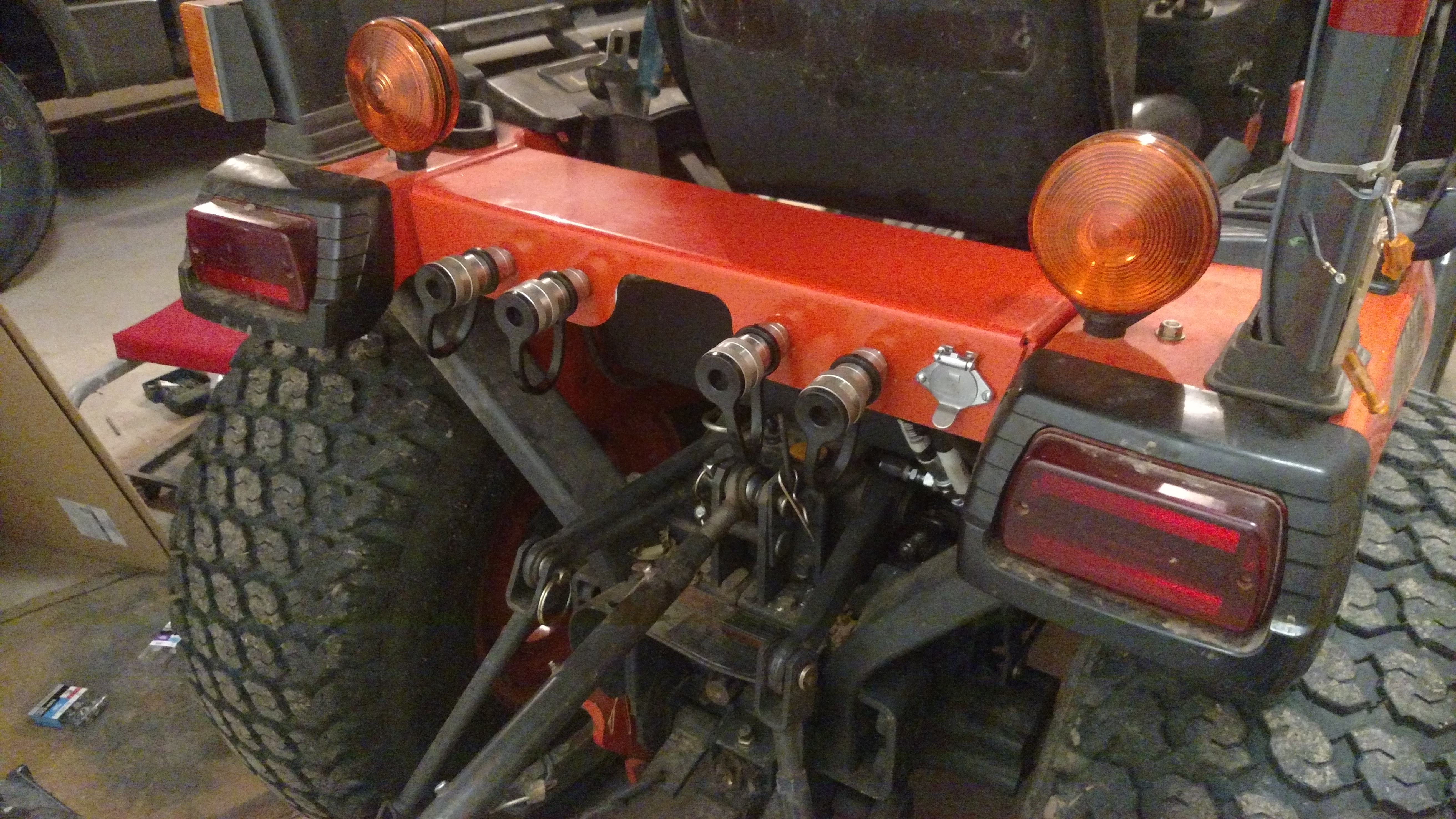

Once I knew the blower was going to work mechanically, I decided to add auxiliary hydraulics to the tractor so that I could control the chute rotation, since the blower was already set up for it. But 1 front hydraulic circuit turned into 2 front and 2 rear (what can I say?). I bought the valve block from Northern Tool, the fittings from Surplus Center, and the hoses are stock length 3/8" from Fleet Farm. I decided to also add a hydraulic tilt to the blower chute while I was at it. The 1/4" hoses to the snowblower are also from Surplus Center. Some orifices slow down the motion of the blower chute.
The whole setup works great, and was done at pretty minimal cost. I didn't have to have any parts machined, but I did have some cut on a laser (which I have available at work). Everything else was fabricated using a drill press, chop saw, die grinder, or MIG welder.

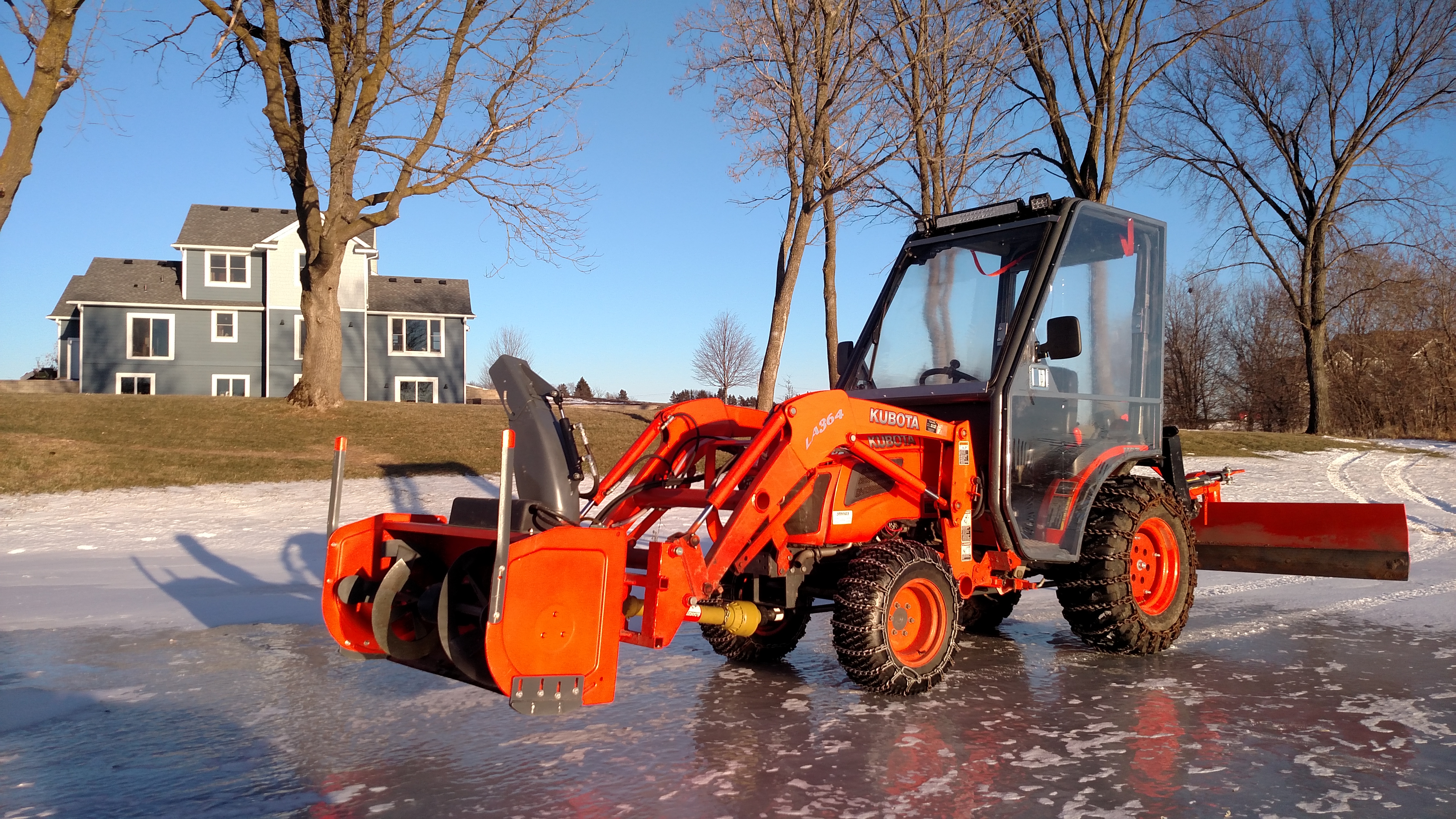

Here's the final product:
When going down the driveway, I tend to run the blower an inch or so off the ground. I then use the blade to clean up the last inch. That way, I can do the whole width of the drive in only two passes and I minimize the gravel picked up.
