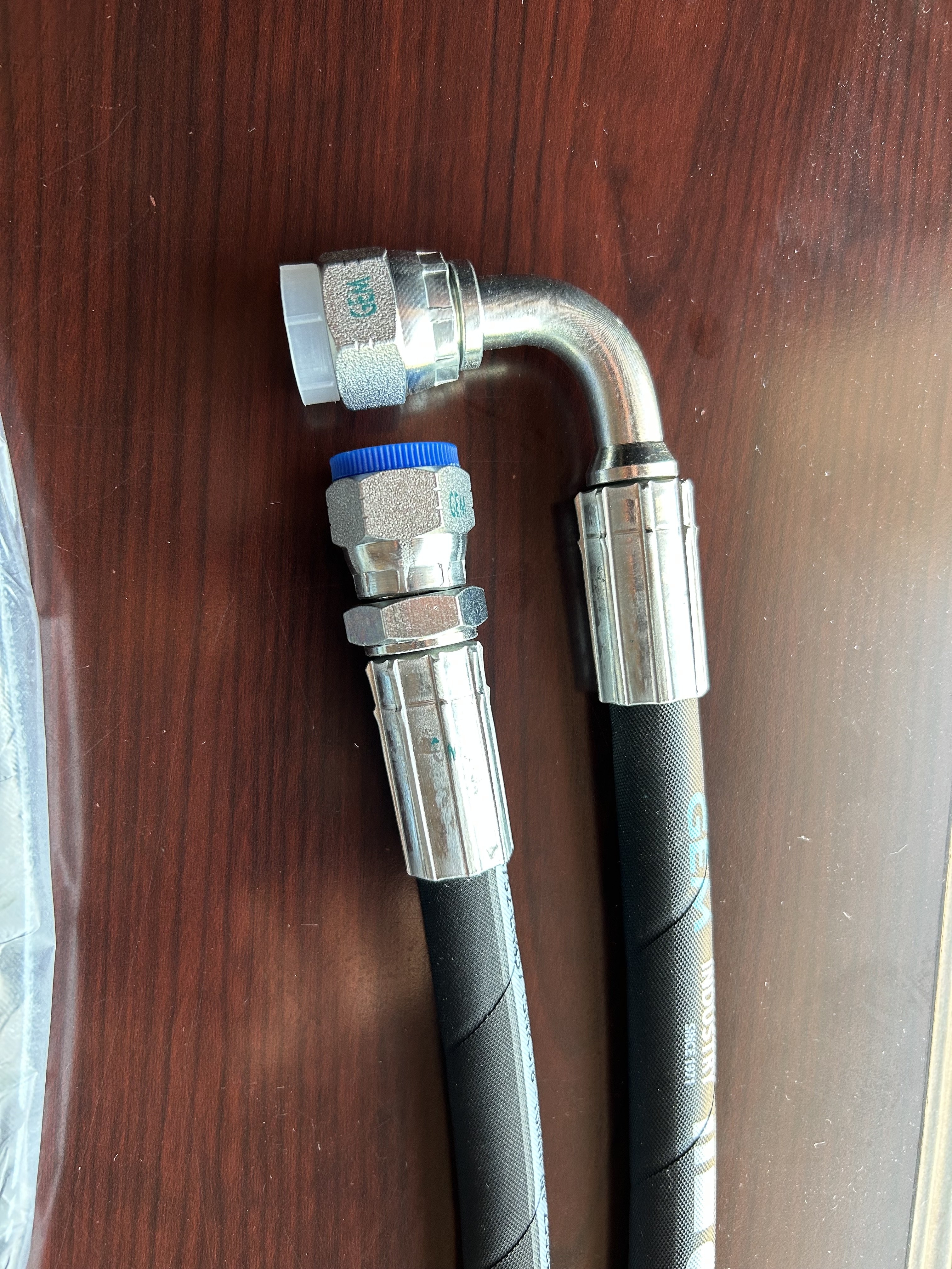

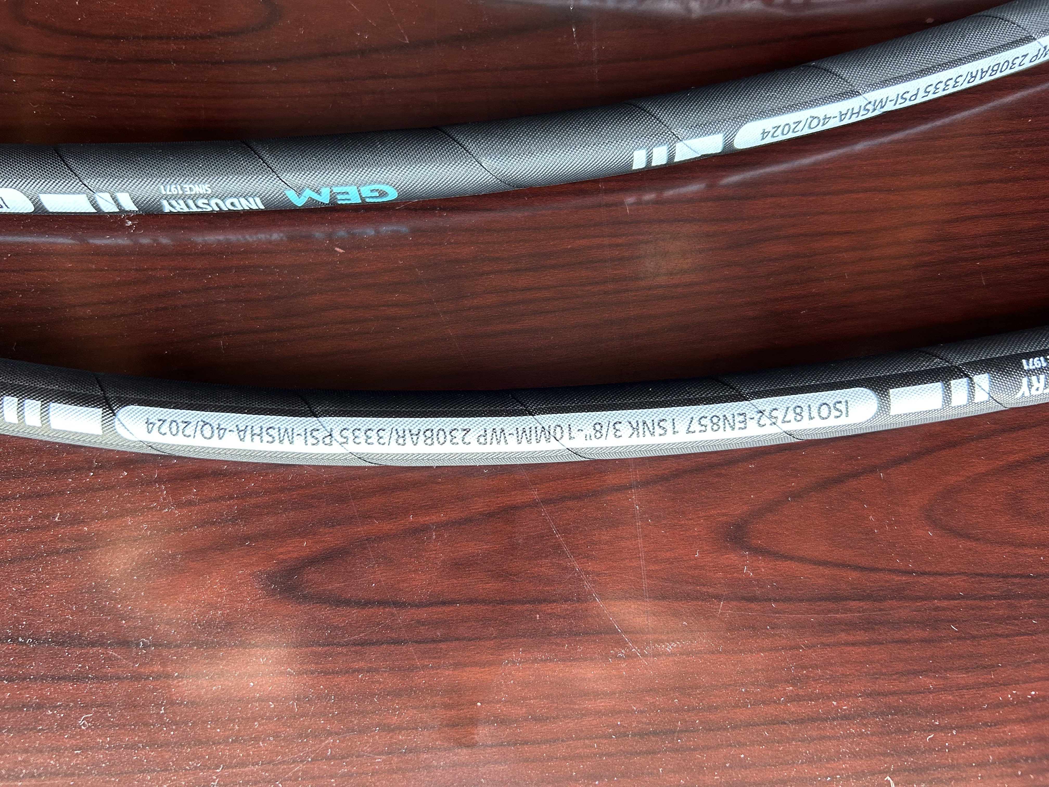

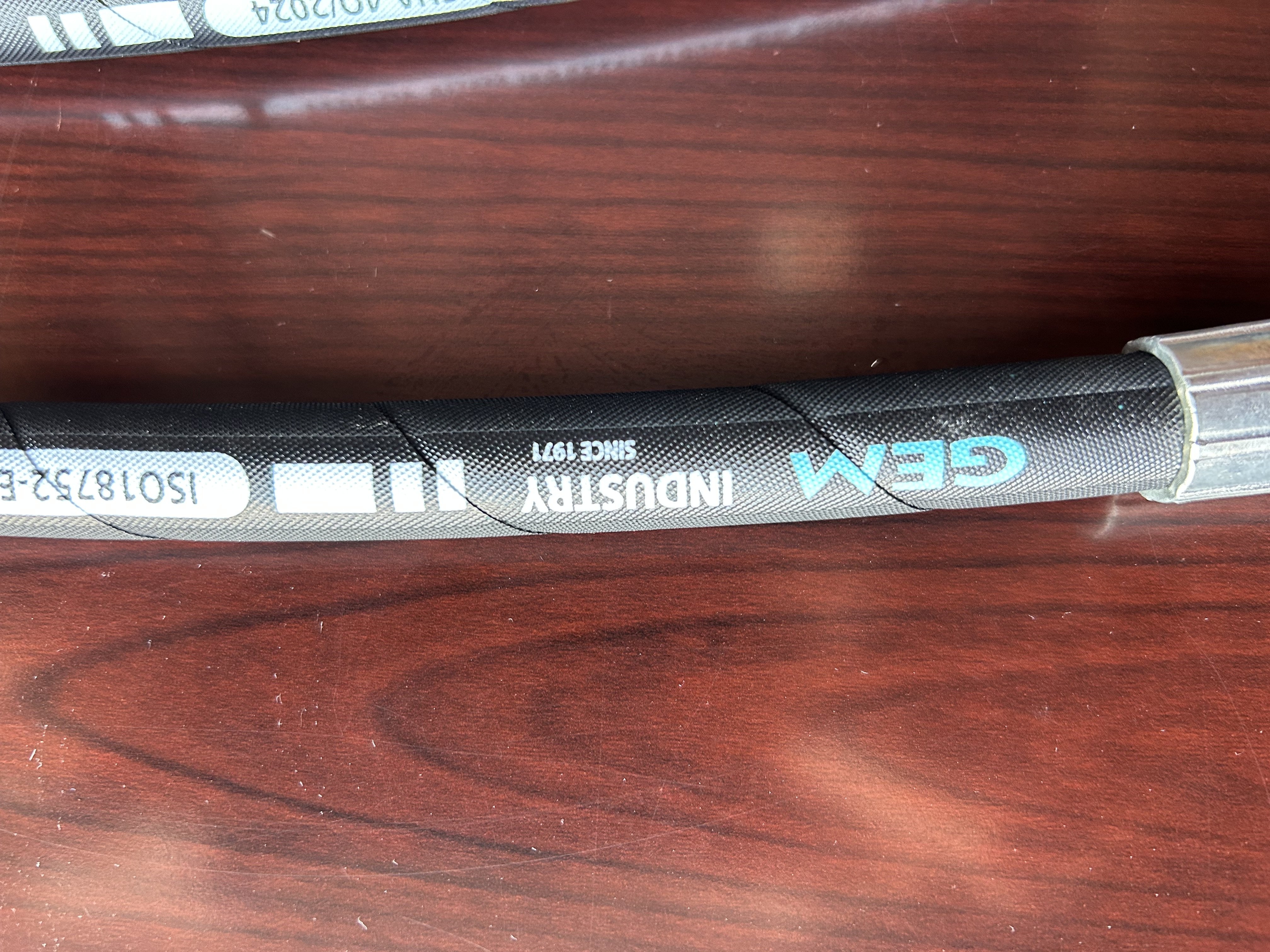

I got my hose “kit” for my B7800 today. They look good and everyone is an exact match for length and fitting. $145.00 delivered for 8 hoses!

Orezok - great deal - low cost too, where did you source from?

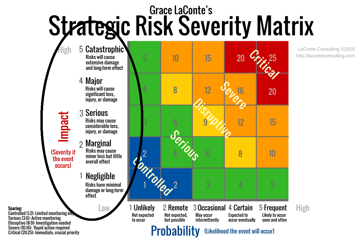

That old probability vs. impact debate, of risk analysis:
I don't know who Grace LaConte is, this is just the first image I pilfered off Google, but I used to have to fill out dozens of these for every government contract job.
