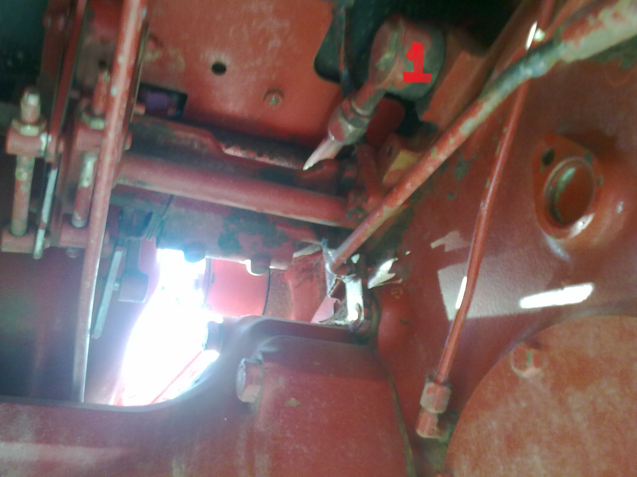

greek
international harvester 585
my tractor has neither hydraulic flow nor extra valve back for accessories.i want to put valve with double action with control.also i want to put a loader on the front.from where i will take oils for the control and where will be reterned the oils?i am looking for a photo or a plan.thank you

If you have 3pt hyd, then you have a hyd pump, and or a hyd system.
This what you have now.
Hydraulics:
Type: open center
Capacity: 9 gal [34.1 L]
Valves: 1 or 2
Pump flow: 15.1 gpm [57.2 lpm]
Can you see the hyd pump and output/pressure line?
Is it hose or metal LINE going back to the 3pt?
If you can easily get to the pump output, you can add a loader valve and then a remote valve for the back with QD's for attachments..
http://www.tractordata.com/farm-tractors/001/1/5/1152-caseih-585.html
Show some pictures of the pump area and right side of tractor up close.
/ loader for international 585 #3
I am surprised that your tractor does not already have at least 1 auxilliary valve?? Are you sure?? A photo of the console on the r/hand side of the seat, below the seat would be helpful
If a valve is fitted then there is the possibility of using a "High Pressure Carry Over" ( HPCO) to power your loader and attachments.
Return can go to HPCO, ( dependant on type??) or to return port under r/hand axle, (already on tractor with large plug in it.
Where in Greece are you located?? I used to visit Greece 2004 --2007 for McCormick tractors!!.
/ loader for international 585 #4
You have newer tractor than my 574, BUT the loader hyd on it was hooked under the tractor (right side just under the seat) and had a single stick 2050 loader on it!---when loader was taken off, a hose was hanging and the other end went up along the right side of the rear end housing and connected up to a plug that is on or near the hyd valve on the tractor!---yours may be there but handle removed for some strange reason! I could look closer on my 574 for exact location and post findings if you need them!
Like JJ said you got hydraulics on that tractor and all you need is to mount loader and plumb it up! thanks; sonny580

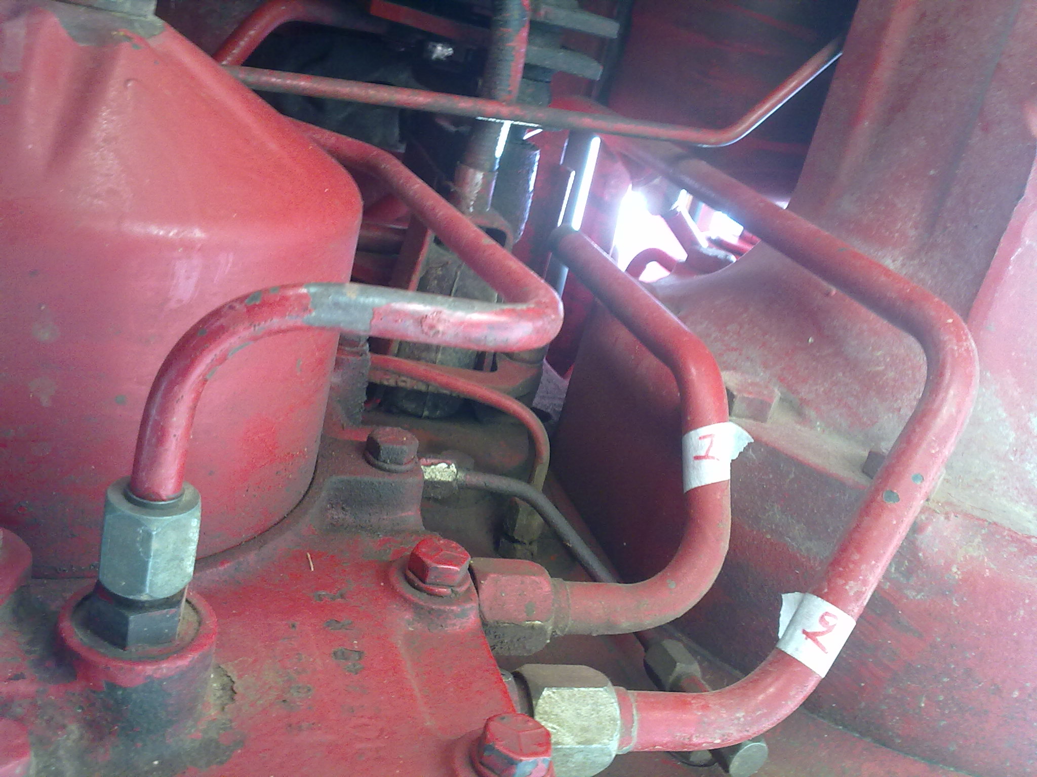

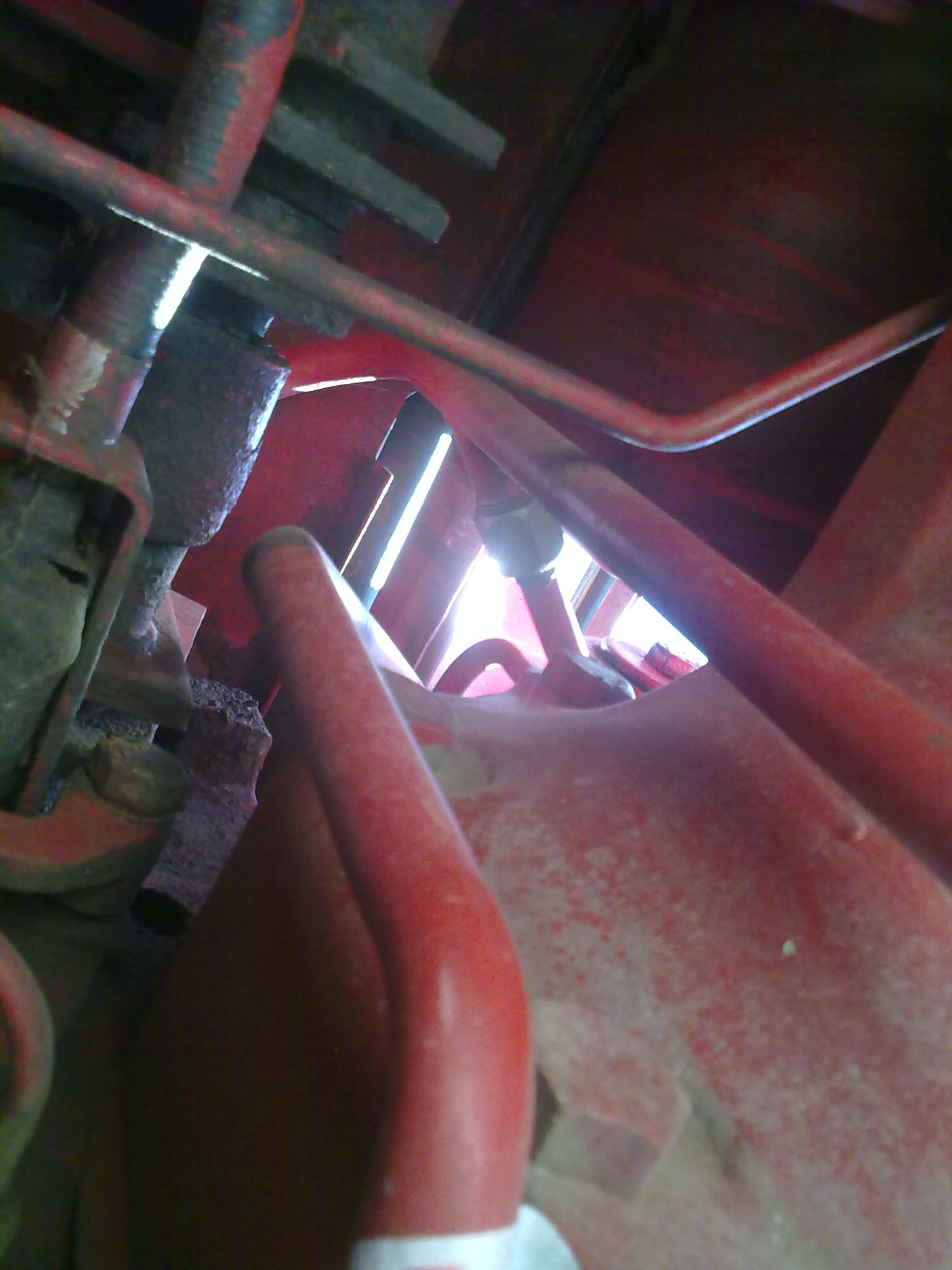

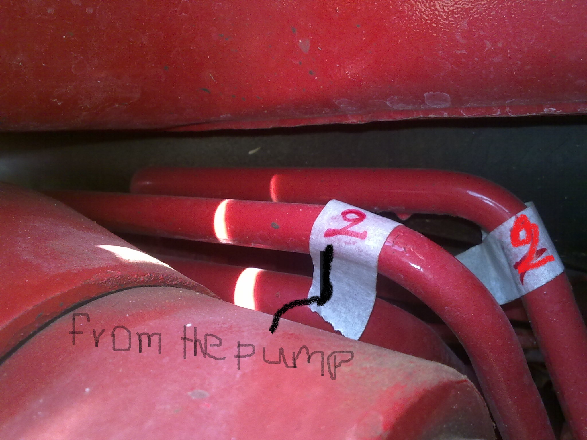

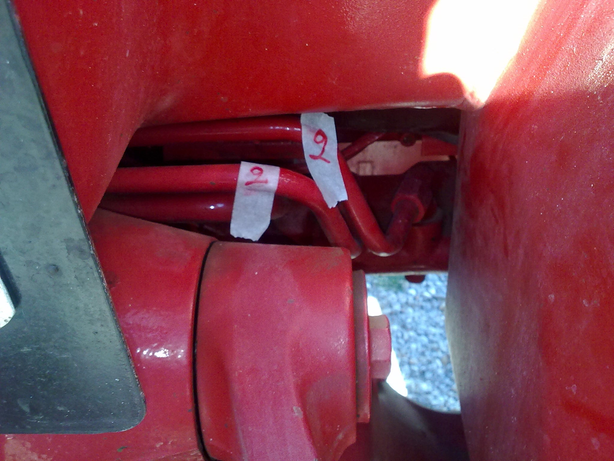

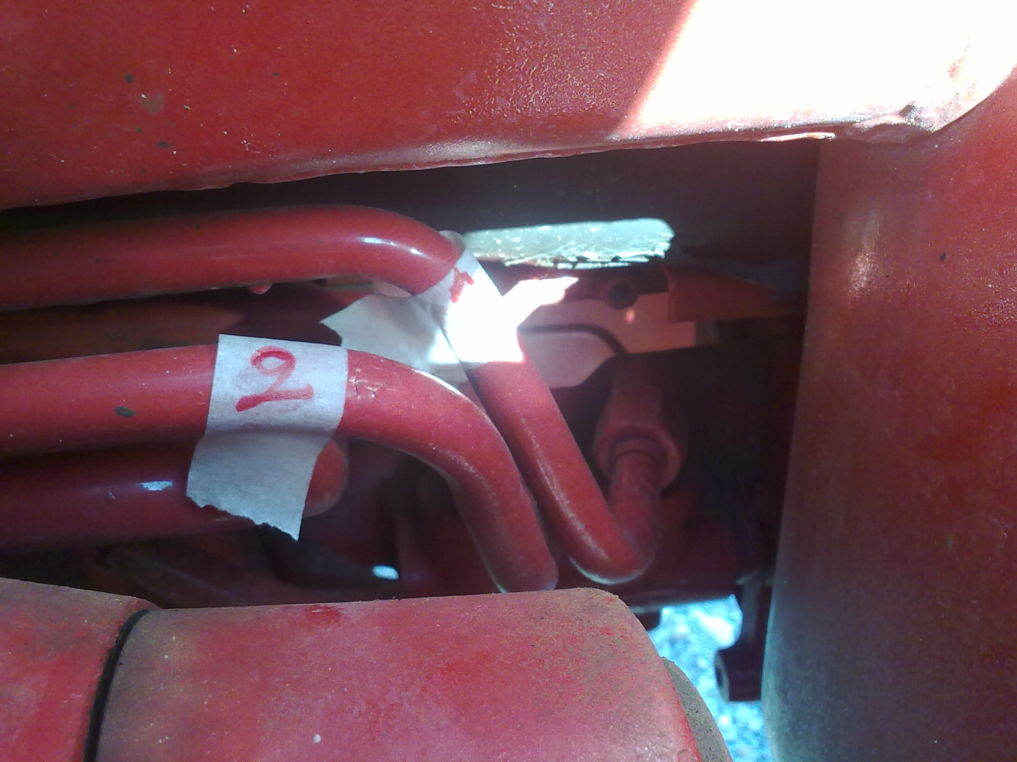

10032013786.jpg10032013781.jpg10032013793.jpg10032013787.jpg10032013783.jpg10032013796.jpg10032013790.jpg10032013785.jpg10032013802.jpg10032013791.jpgthese are the photos from the pump,the valve and the control.i want to know from when i will i take the oils and from when the oils return
/ loader for international 585 #9
Thanks for the photo,s
I still need a bit more informationto advise you!!as the build without auxulliary valvesis unusual??
Can u remove the seat, and under the seat is a panel in the deck of the cab, remove this panel then photograph the valves you can see , particullarly towards the r/hand side of the opening.
I have some documents to send to you so i need your E Mail address, please send me a P M with the details.
Do you have a service manual?? I sell PDF copies of the genuine IH manuals??
/ loader for international 585 #10
