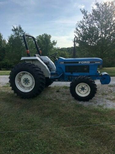

I have just purchased a Ford 2120 tractor and have been looking at loaders for it. The loader that Ford put on it was really beefy, (7109, later 7309) Has about a 2400lb lift capacity at the pin. Quote from Westendorf was $7400+ freight. Anybody have any suggestions? I am looking into building my own, but just wanted to see others thoughts. Tractor doesn't have the SCV for a loader either, so I will have to deal with that as well.

It's not difficult to install a 3 hose power beyond capable joystick valve on a 2120. Make all 3 connections at the distribution block near the brake pedals.

Westendorf is a high dollar brand that typically makes loaders for much bigger tractors than a 2120. Retrofitting a 20+ year old tractor is probably a build-to-order deal, at least for the bracketry. I'd dig a little harder. Woods, Ansung, KMW may be less costly.

I have a 1620 and just went through the same pain in rear. I bought the tractor with the factory front blower and no loader. I hunted for a few months calling every new tractor dealer anywhere remotely near, watching fb marketplace, Craigslist, etc. I also got a quote from westendoef for $4700 with a quick attach setup.
I finally found a complete 1520 with a loader and a transmission leak inside the bellhousing for $4k at a new holland dealer 2 hours away. I immediately went and picked it up and had the loader on my tractor within an hour of getting back. I purchased a universal quick attach retrofit kit for $240 from Vevor and cut the pin on brackets off the bucket and welded them onto the quick attach parts.
