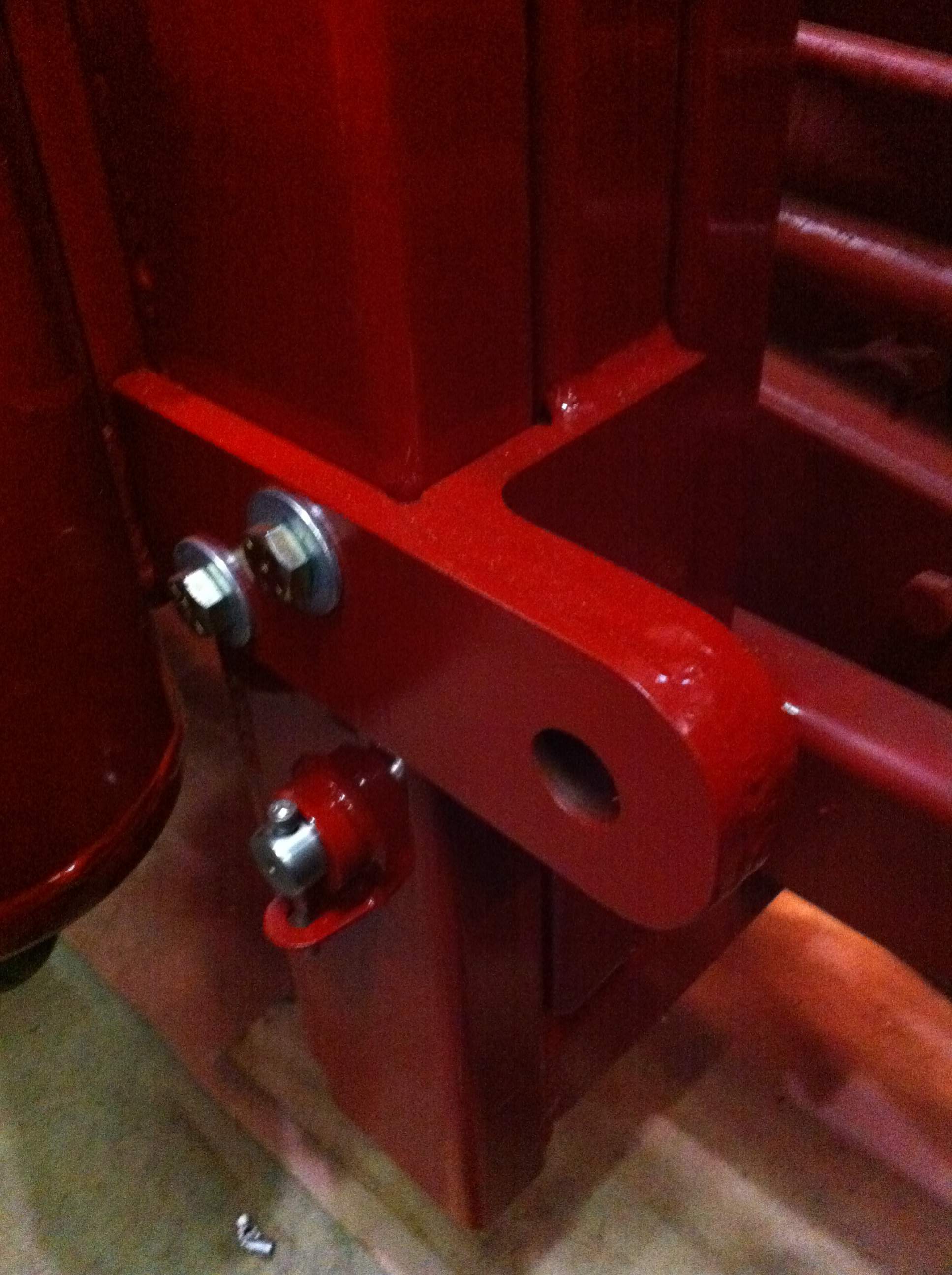

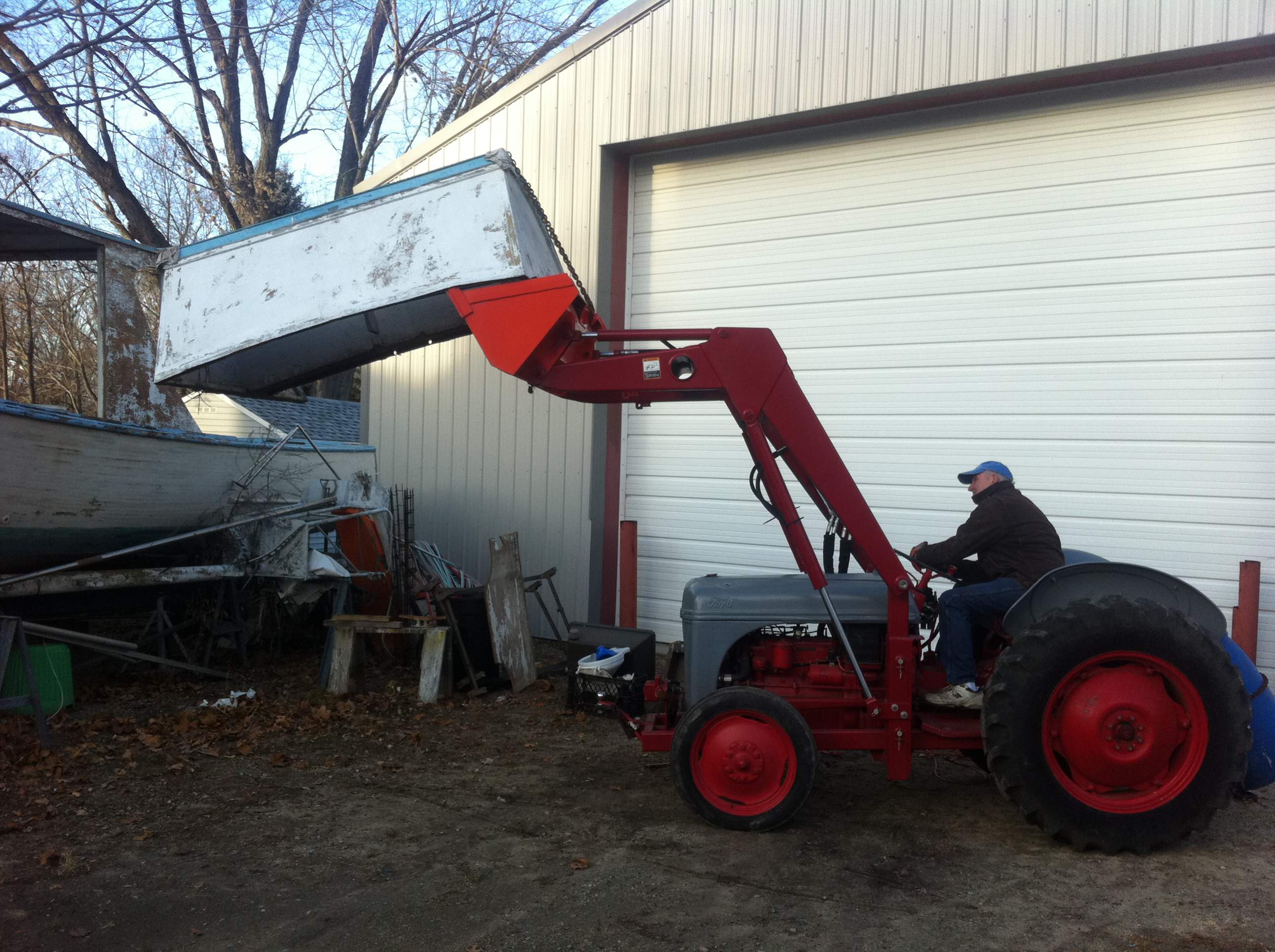

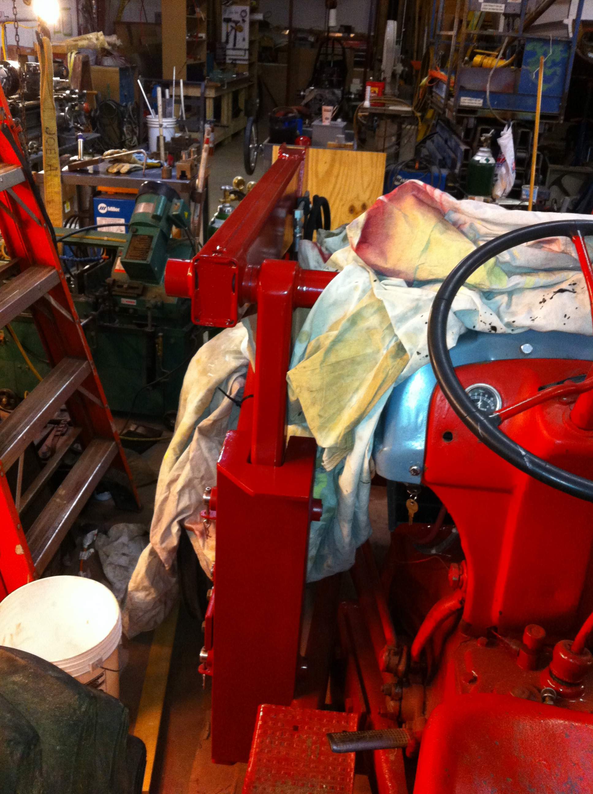

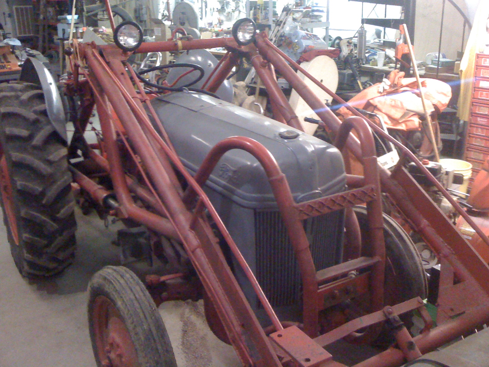

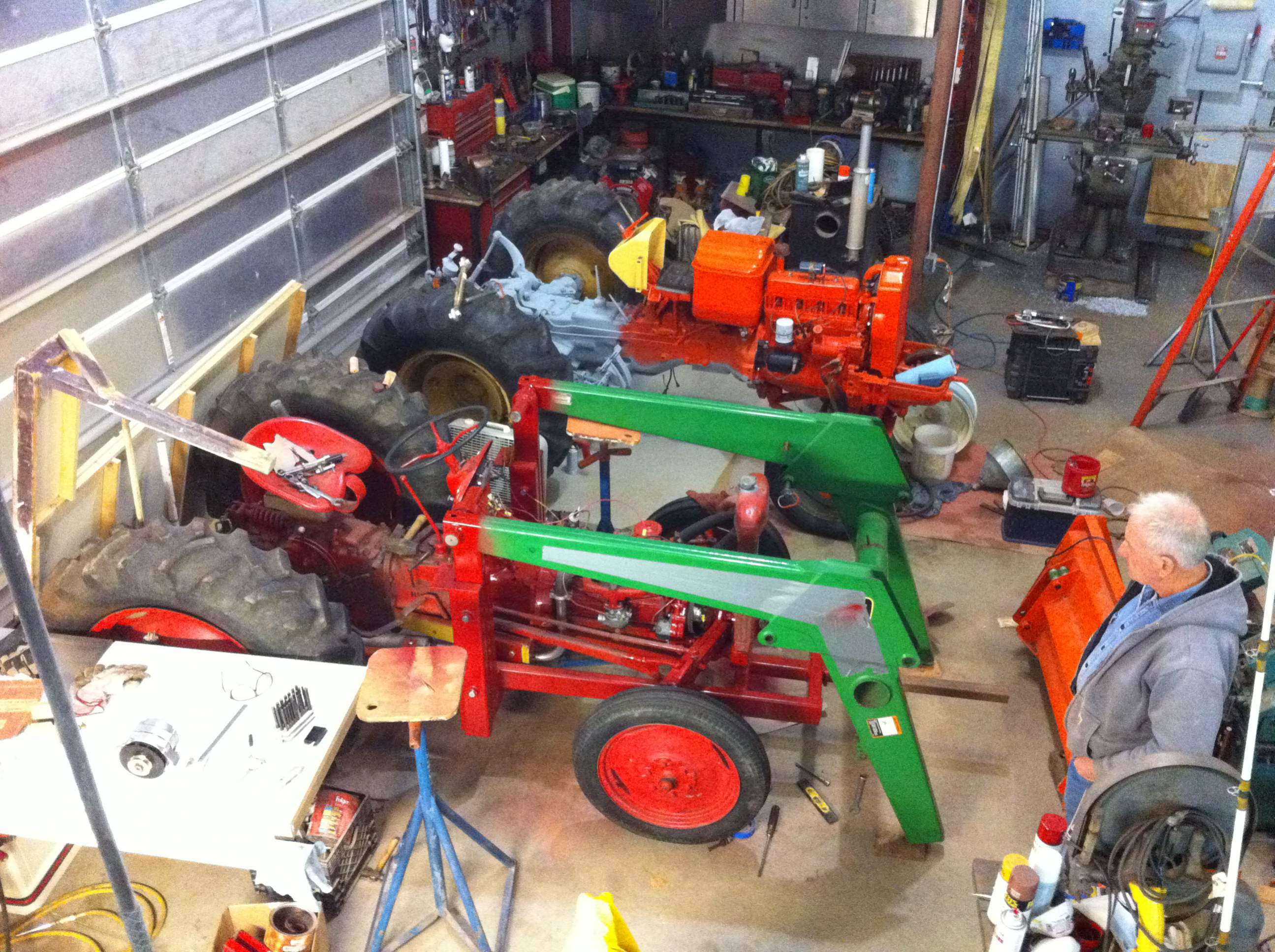

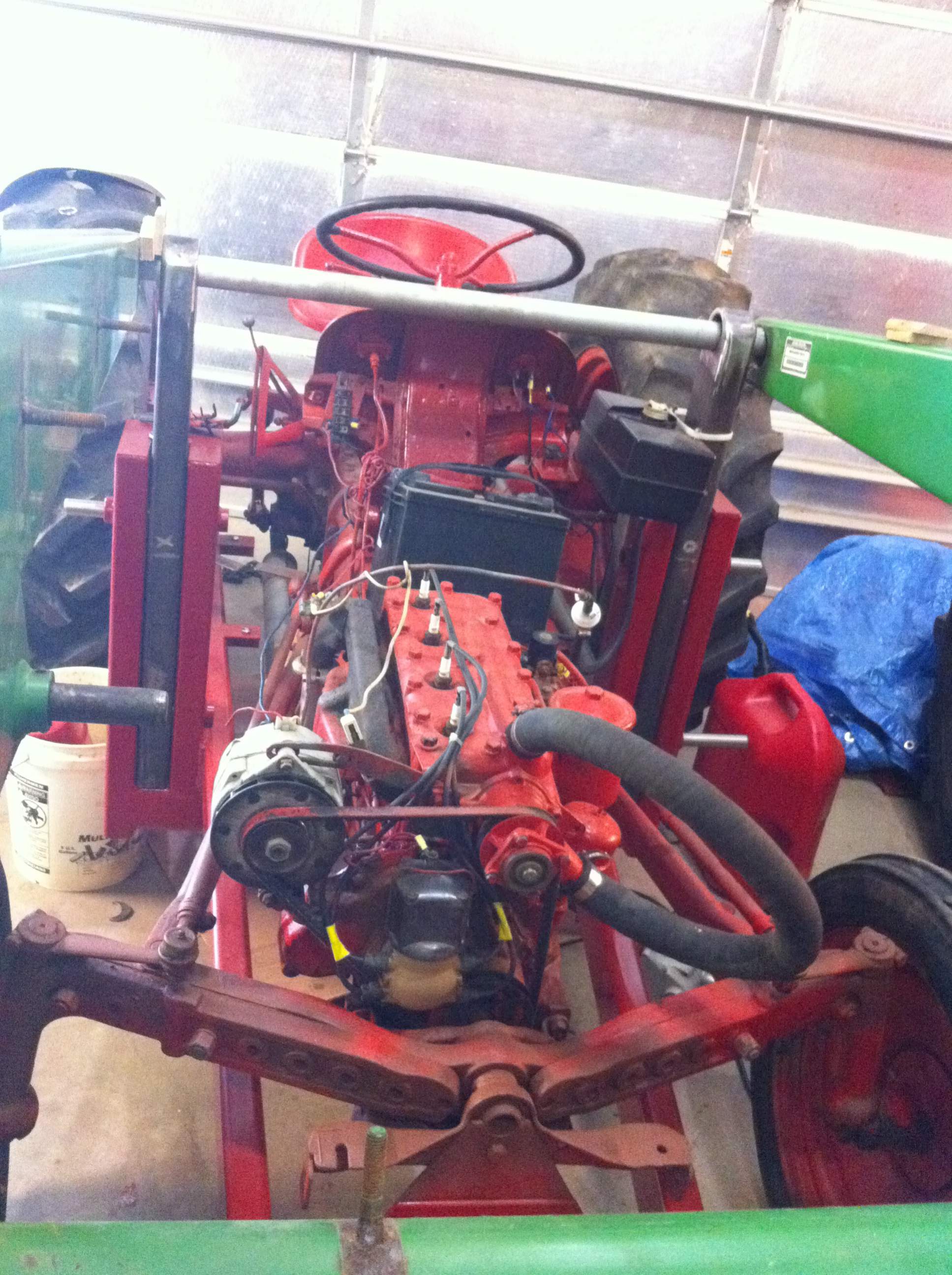

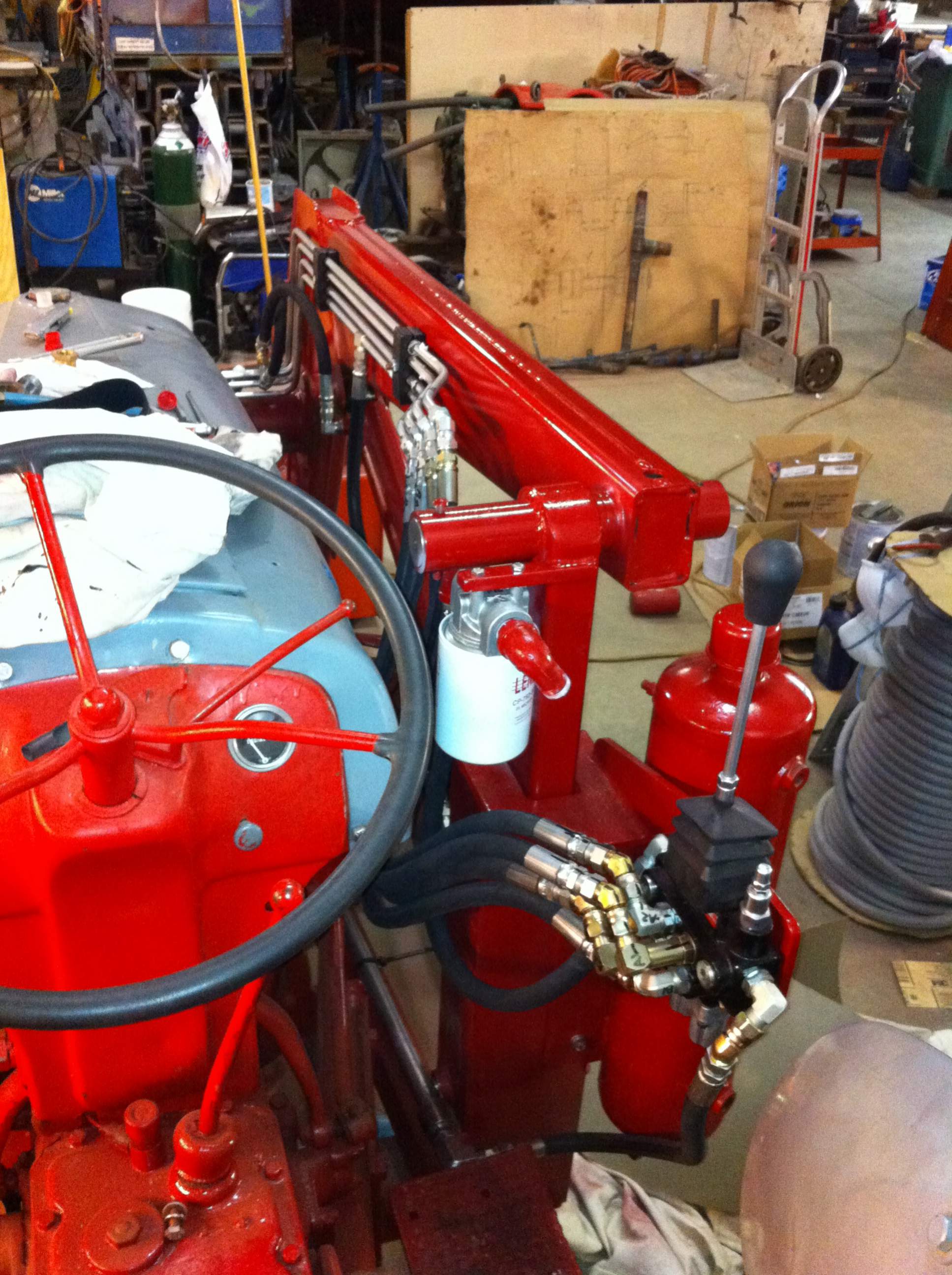

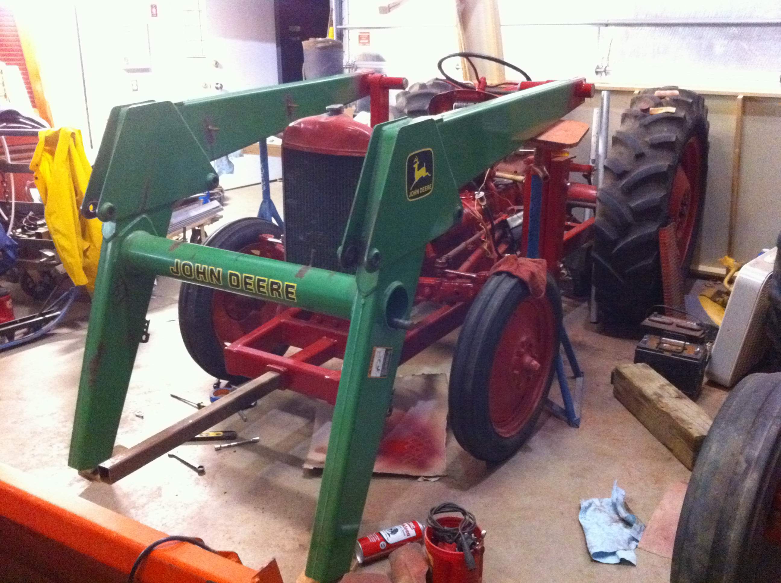

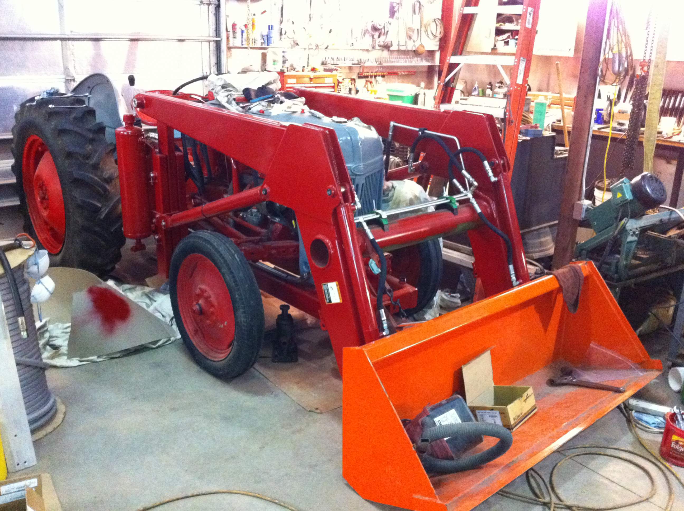

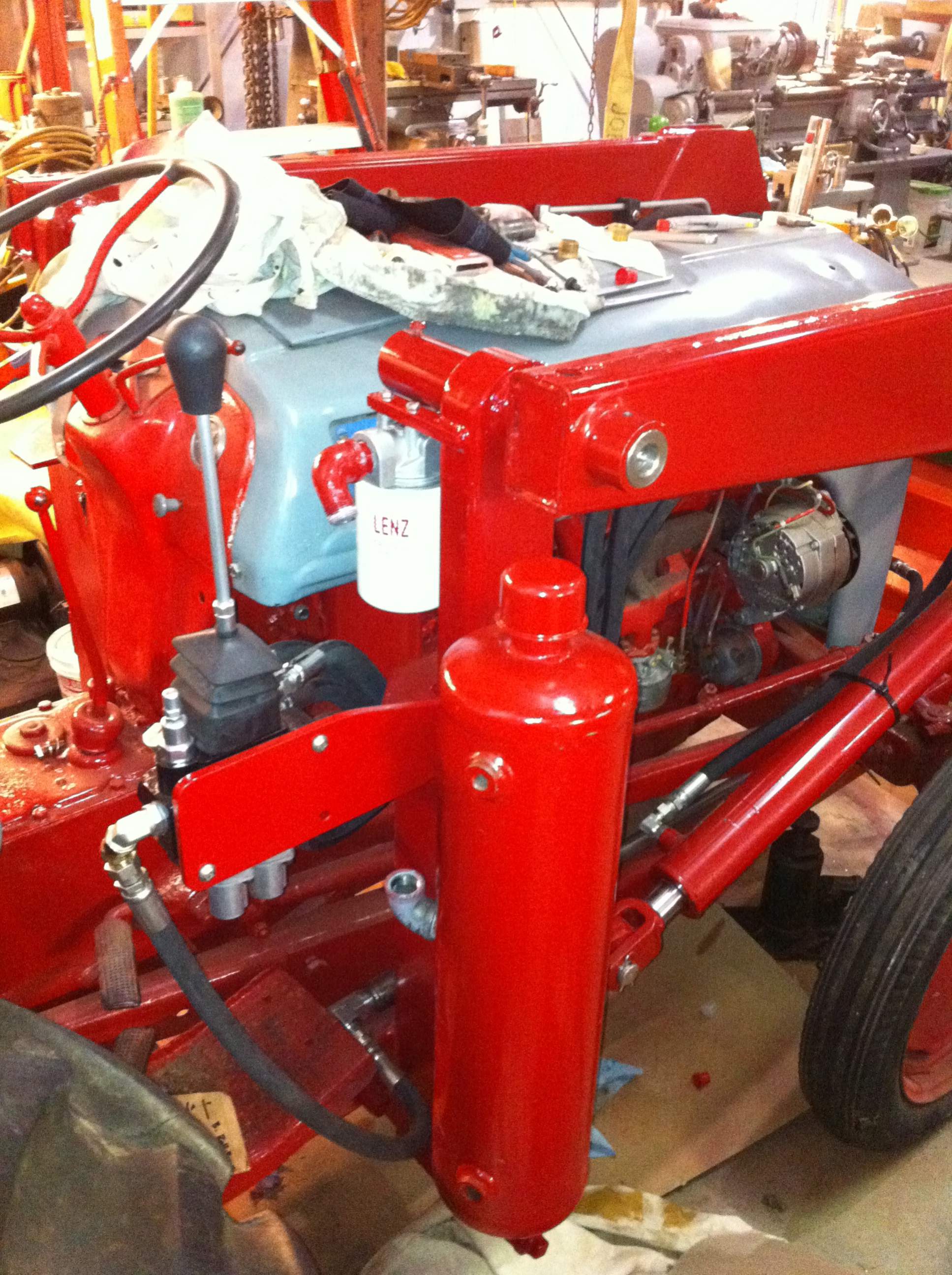

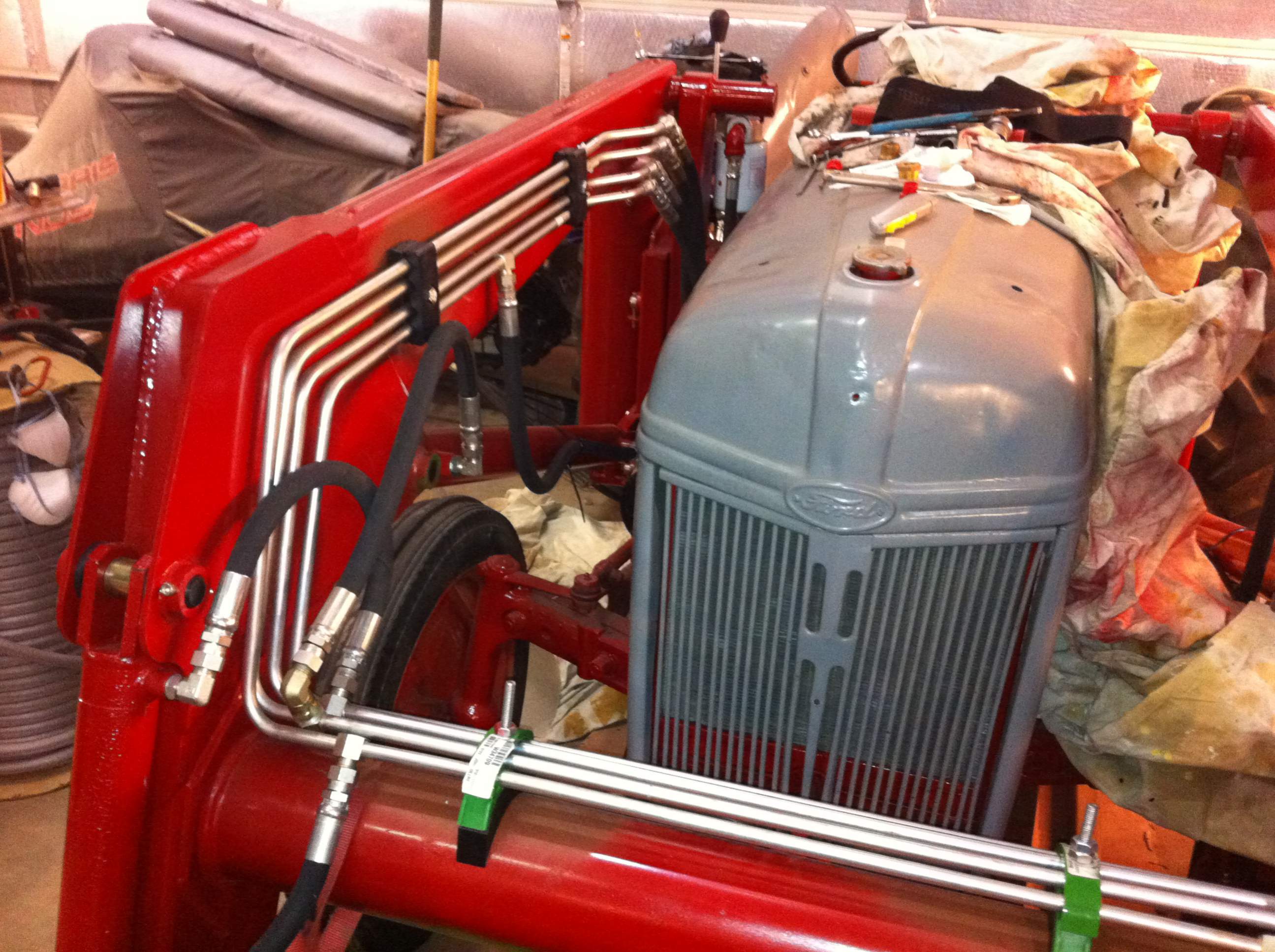

Built a complete loader attachment for a Ford 8N and shortened the Deere loader arms.
Note the full subframe under the stock 8N.

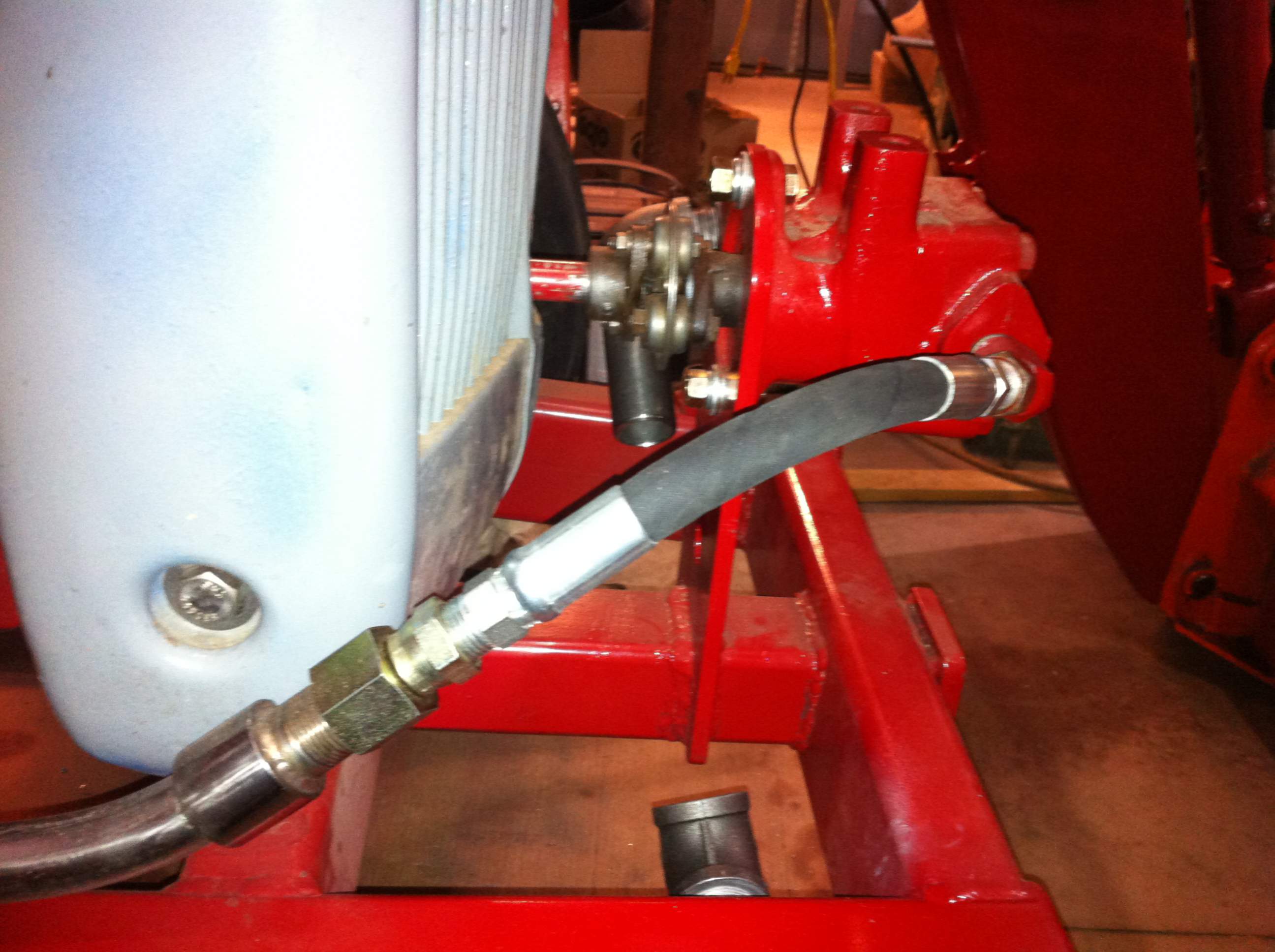

What's your gpm with that set up?
/ Loader for Ford 8N
Thats the stock pump that came with the old loader. Not sure of the GPM but its fast and seems plenty powerful.

Thanks, it was a ton of fun building it. The tractor is for sale if anyone's interested.

Is the front axle and/or tires up to handling the weight of the loader and whatever it can lift?

Ok, I get it... But lets keep things in in perspective. My 75 year old father can't move things the way he use to, so we built a loader for one of the tractors he owns as a project to do together as well as some utility. Between his Deere B, the 8N and my old case 310b he can get plenty of work done. And if we need more I have an ASV PT-60 to fill in the gap.
This loader is less weight on the front than the original, but we have contimplated attaching a HD axle right under the new subframe, not that much work involved.

Just making room for more projects. And yes the loader is built to be removable but the subframe stays in place.

How does it steer? both loaded and empty?

It steers the same as the stock loader, you need to start moving when you turn the wheel. Would be easy to add hydraulic steering to the subframe.
