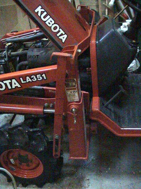

Yes its the cylinders leaking internally. There is no loss of hydraulic fluid. I assume it is leaking past the piston within the cylinder. On the tractor the leak down could be caused by either the valve or the cylinders. When disconnected it has to be the cylinders or the check valves in the hydraulic hoses. If it was the check valves, I would expect to see puddles of hydraulic fluid. With no puddles I am left with the cylinders.
The leak down occurs in both my bucket curl cylinders and my bucket lift cylinders.
The loader has hinged flat bars and feet which drop down from the crossbar in the rear. An attached photo shows the support foot in the stowed position.
It does not have the bars which connect close to the bucket to support the loader.

OK, Ed, I was looking at your picture and the ones in my service manual. Now it does make me wonder whether the seals are bad in all 4 cylinders. Now I'll admit I've never changed the seals (never needed to), but from looking at the service manual, sure doesn't look like any big deal. Of course you'd have to be very careful to keep everything clean, and of course visually inspect the cylinder tube for signs of scoring or damage. If the whole thing cylinder had to be replaced, I'd bet that would get expensive.

The FEL on my 2001 B2910 (with about 130 hours on it), has about the same bleed-down rate that Ed mentions with his (and I have no active leaks per se). I also remember the threads on this subject, and I am not convinced that Ed's seals are bad or need replacement. From listening to the feedback in this forum on this subject, as well as talking with the service department manager at my dealer, and a number of "professional" folks who have commercial-sized and equipped backhoe/loaders (and similar equipment), it seems like the prevailing opinion is that there can be quite a lot of variability relating to hydraulic system bleed-down rates for FEL's or otherwise ... especially when considering the relatively low-cost equipment we are running (i.e., without the benefit of cost-prohibitive cylinders, valves, and seals that resist or prevent bleed-down altogether).
Although I am no tractor nor hydraulic system expert, I have come to the conclusion that a 2 hour to overnight FEL bleed-down rate is not technically "out-of-spec", and those of you that can leave their FEL up for days and weeks without noticeable bleed-down are "lucky" and represent the exception rather than the rule. (And at the very least, this opinion makes me feel a little better about my FEL and its expeditious bleed-down habits). /w3tcompact/icons/crazy.gif /w3tcompact/icons/tongue.gif
