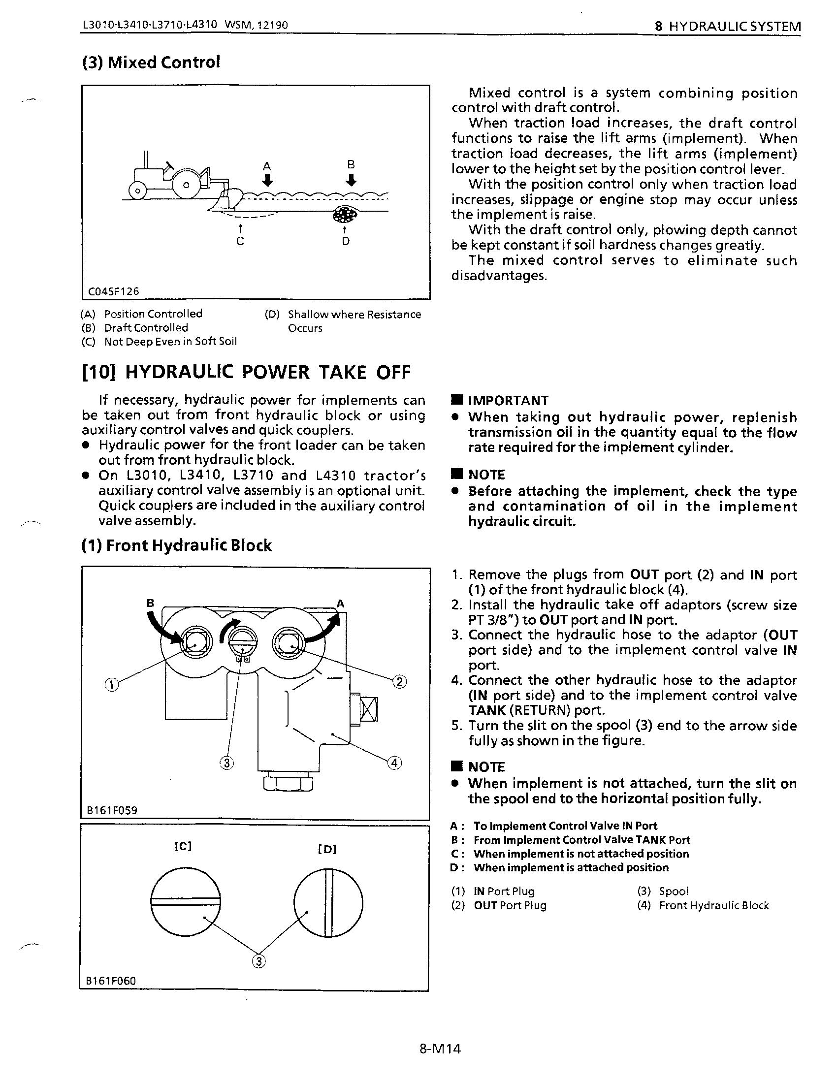

I looked at the tractor today. The loader is working normal but the three pt hitch is still not working. I am not sure where to look next.
/ Loader Bucket rises slow #5
I'll look tomorrow in the manual and see what way the hyd block valve should be turned. I can't remember if it shuts down the 3pt if turned wrong. Bty it's under your right foot.

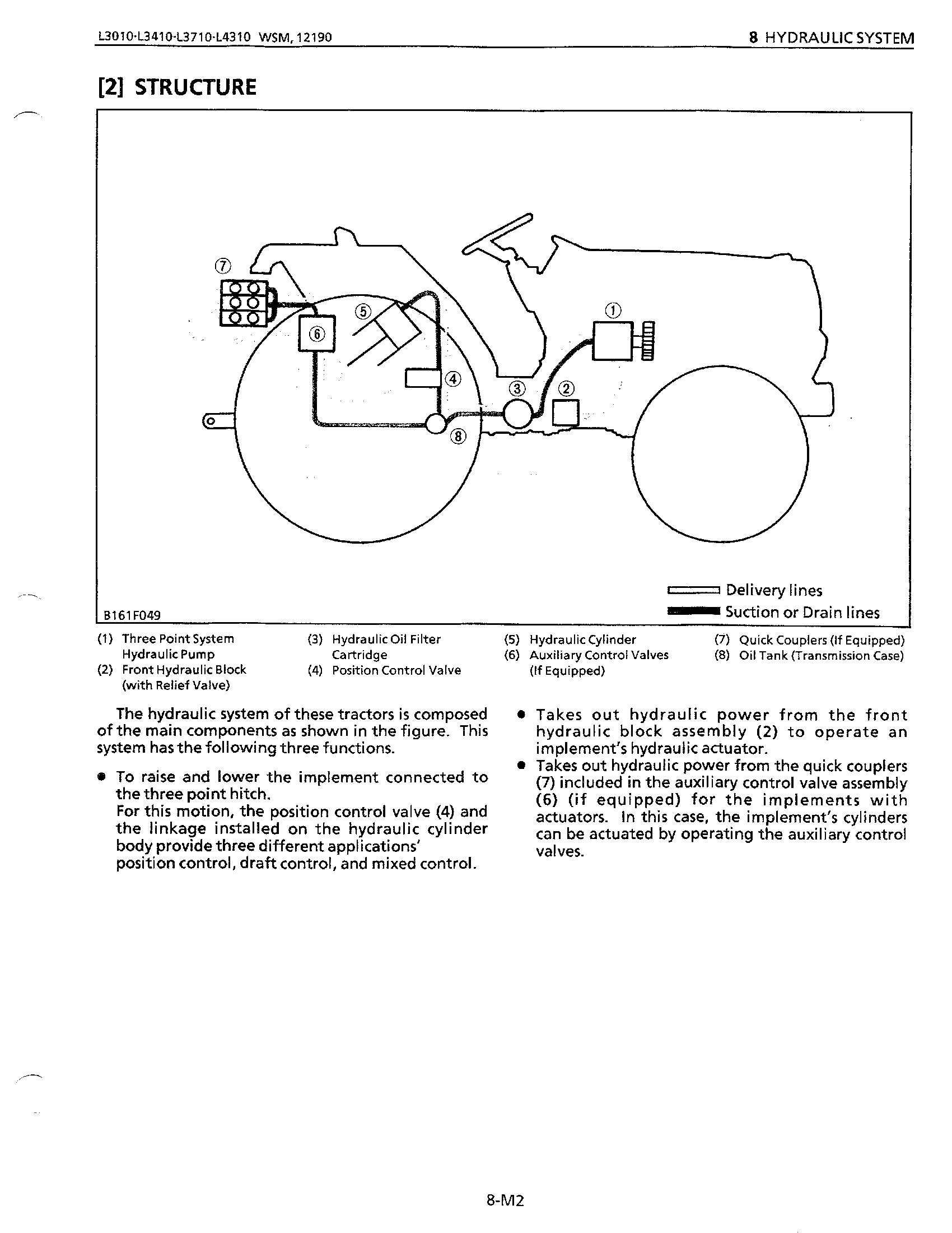

/ Loader Bucket rises slow #11
The picture is just so you can see the system, if you don't have rear remotes then #2 would go right to #4.
The other picture is the hyd block. After reading it does seem to shut down the 3pt if you do not have rear remotes.
WOW it didn't scan the red line. There should be a red line from #1 to #2 then to #6, from #6 to #7 and also from #6 to #4 then last one #5
