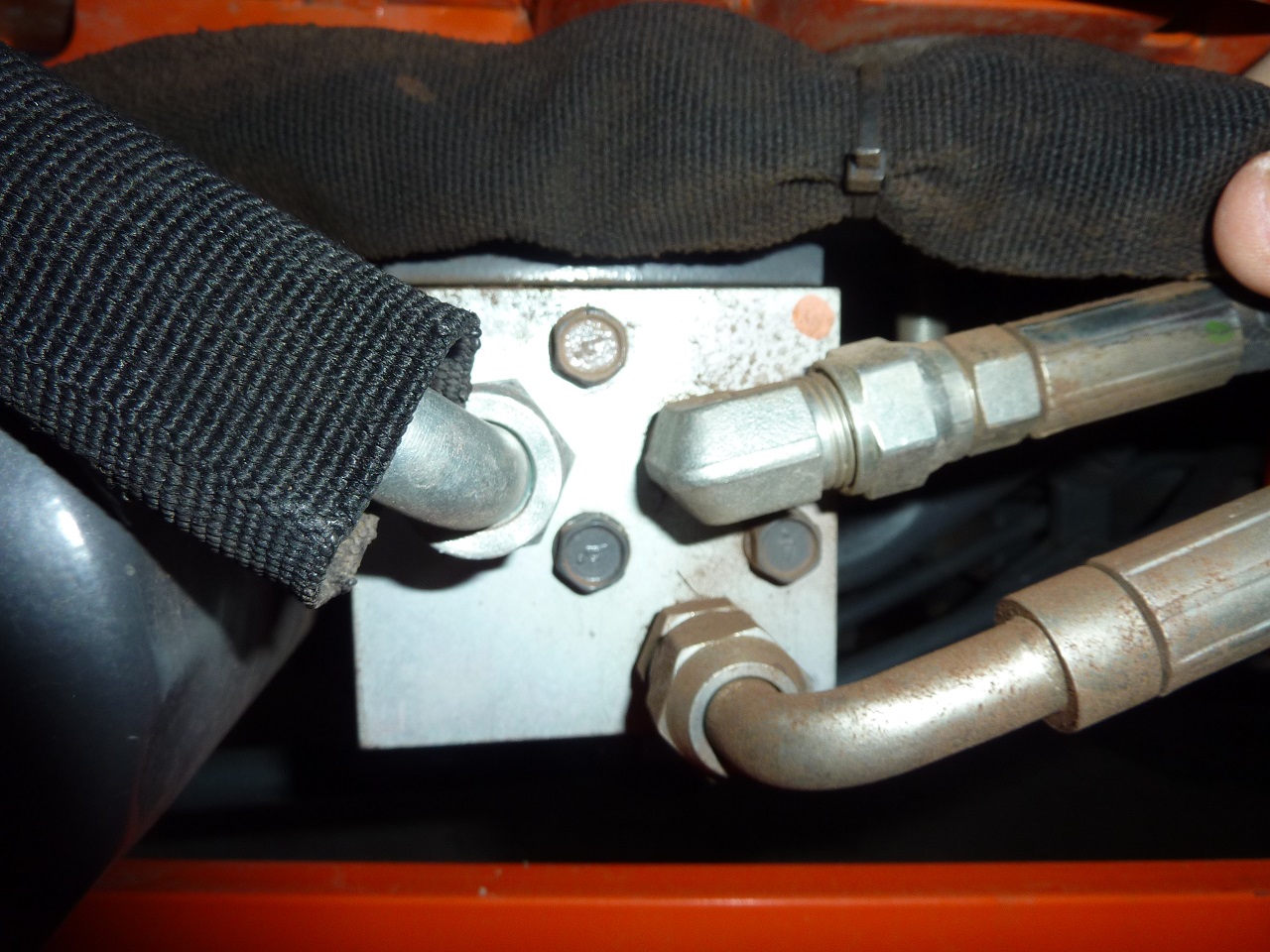

First check the pressure, 10% is the golden rule, it will make a huge difference. seriously
I wouldnt say golden rule.....but 10% is still probably within the safety design of everything.
A ~2600psi rating from factor......+ a 260psi increase......still only 2860psi and still well under 3000psi component limitations.
And 10% boost in pressure is a good bit more than 10% increase in actual usable capacity.

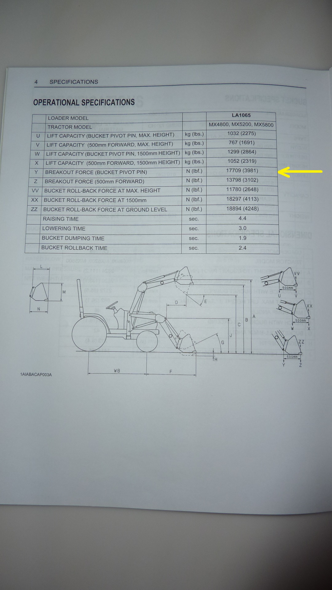

If You look at the Kubota Specs, the breakout force for the LA723 is 2605#. For the LA1065, it's 3981# or a 52.8% increase.
Both tractors were equipped with SSQA.
I agree about technique as I said. I also can fill a bucket with one pass in certain types of material. I deal mostly with rocky rooted hardpan and red shale where it isn't so easy. Just a modest increase in breakout will make a big difference for me. Thanks to what I've learned from the posters here, I should be able to get some improvement through hydraulic pressure adjustment.
Im not seeing the 3981 number.
Im seeing 3102 vs 2605.......a 19% increase
and 2275 vs 1870 for lift to full height at pin.......a 21.6% increase
and lift to full height at 500mm forward.....1691 vs 1400.......a 20.7% increase....
AND.....kubotas loader model numbers indicate their lift capacity. Make the last number a ZERO and thats your lift capacity in KG. (last number is revision)
BUT......sometime about 3 or 4 years ago....kubota changed WHERE they measure that at for model # purposes. It used to be at bucket center.....
So the 723 loader is 720kg......3rd revision.........and 720 kg = 1584# at bucket center.....(about midway between the 1400lbs at 500mm and the 1870 at the pins).
Dont know if they still do....but kubota manuals used to list ALL 3 numbers for lift. Bucket edge (500mm), bucket center, AND pins. They also usually include a graph (curve) because a loader is MUCH stronger at ground level. Usually the "breakout" force is what the loader can lift at ground level with the lift cylinders. MUCH MUCH higher than at max height.
Now your LA1065 loader.....is newer. remember I mentioned they changed where they measure for model purposes. On your model.....1060kg refers to lift at pins in KG. or 2332# (pretty close to the actual spec of 2275...probably some rounding up involved) And its the 5th revision.
The previous loader on the MX (same loader different stickers) was an LA854. 850kg....4th revision.
So you are comparing a 720kg loader to a 850kg loader.
Gotta understand marketing......and just how loaders are rated. Because it can all get very confusing.
Just trust me when I tell you....that your MX loader is no where near 50% stronger than the LA723. The 20% stronger that I said......thats reality.

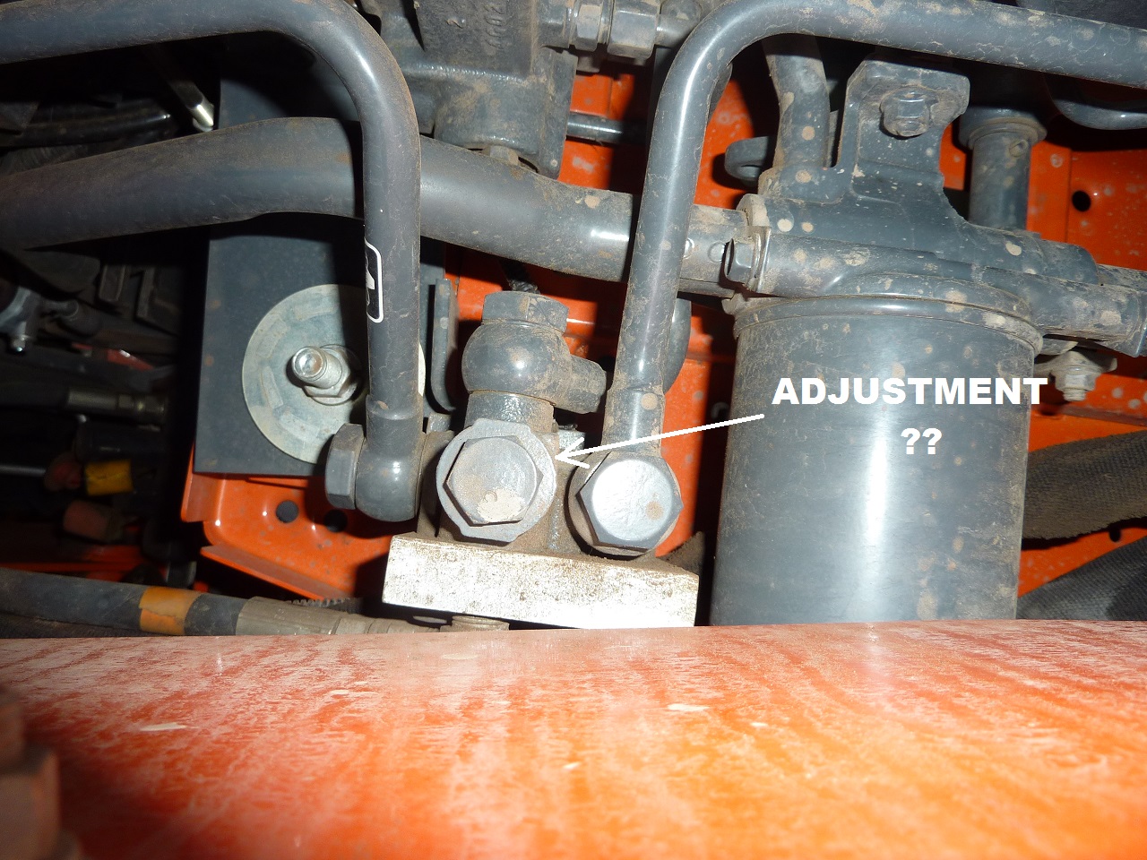

...Cant see how you can add more power safely without the risk of overturning the machine rather easily.
There is a chance that the PSI was set too low... would like to know the "before" PSI...
Don't disagree at all - if it is in spec the machine seems to have plenty of power for its weight/size. I have mine within spec but if I recall it was just very slightly under the max recommended.

This is quite upsetting. I didn't expect a 50% increase in the overall strength of the MX / LA1065 (lifting capacity etc.) That's not what this post is about. My main concern is ground level breakout force.
I bought the MX primarily due to the dealers assurance the breakout force on the LA1065 was about 50% higher than the LA723. He showed me specs from the respective FEL manuals for the ground level breakout force measured at the pivot point. The LA1065 was rated at 3981# (see pics) and the LA723, 2605#. It seemed a fair comparison.
You are obviously more knowledgeable about Kubota FEL performance than either myself or the dealer. I've been a good customer at this dealership for many years and I don't deserve to be lied to. I'm going out there this week to pick up some filters and I'm going to confront them with your math.
This thread has been very educational for me and thank you for sharing your knowledge.
View attachment 536551 View attachment 536550
Yea, I dont think it was intentional.
But I believe the 2605# for the LA723 is at 500MM......so that compares to one line further down in your manual.
As I said.....many people get hung up on the confusing specs.
Capacities at Pins? vs Bucket center? vs 500mm forward.... (and on larger tractors that is at 800mm forward).
then at what lift heights? Max height? Ground level? Somewhere in between?
And like I said....you basically have the newer version of a 854 loader. Going from the 723 to the 854 isnt much of a stem.
And it apears not as much of a step as you were lead to believe. Trust me....its only 20% more loader and not 50%.
But doubt there is anything the dealer can do now.....if he even remembers. But you may be able to talk him into checking system pressure on the house.....and boosting it to max spec.
I notice you also have a L6060. Do you have the LA1055 loader on it? Basically same specs on that loader. Notice any difference?
And unfortunatally.......you have the BIGGEST tractor you can get from kubota with a loader AND HST. Next step up puts you into GST trans.
Test pressure first and foremost.
