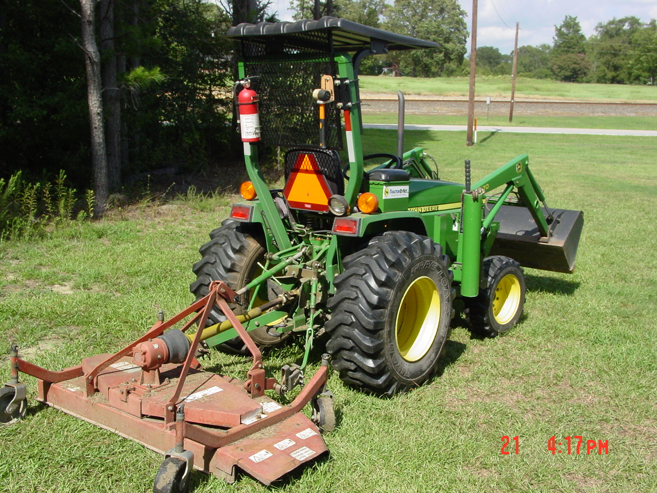

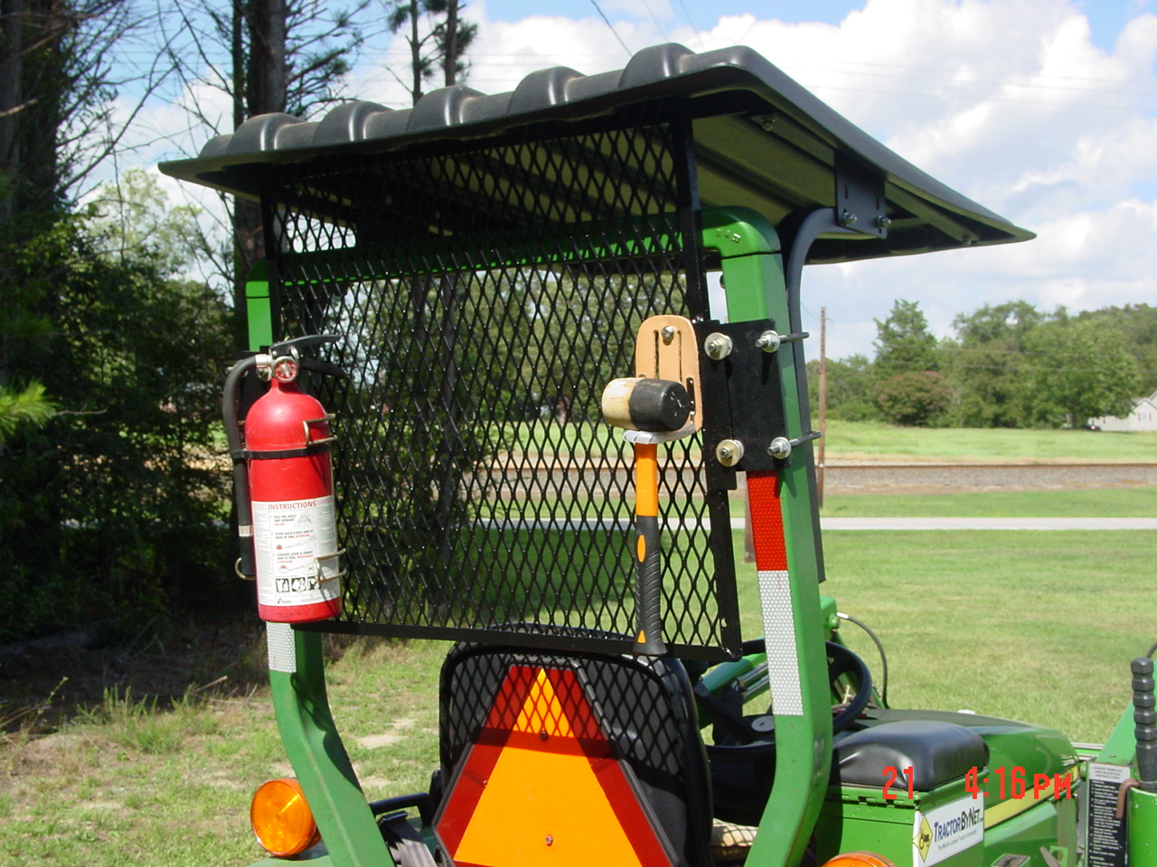

Here's a pic of the Best Top canopy and "FOG" (flying object guard) I added last year. The canopy is the best thing yet, keeps the sun from frying the top of my balding head. :thumbsup: You can see the new location for the fire extinguisher, much easier to get to! Also, I added a holster to hold a dead blow hammer for driving pins in/out.
Love the 790, great tractor! I've had it 10 years and still in the process of pimping it out. Up next is some LED light bars on the front and rear of the canopy.
