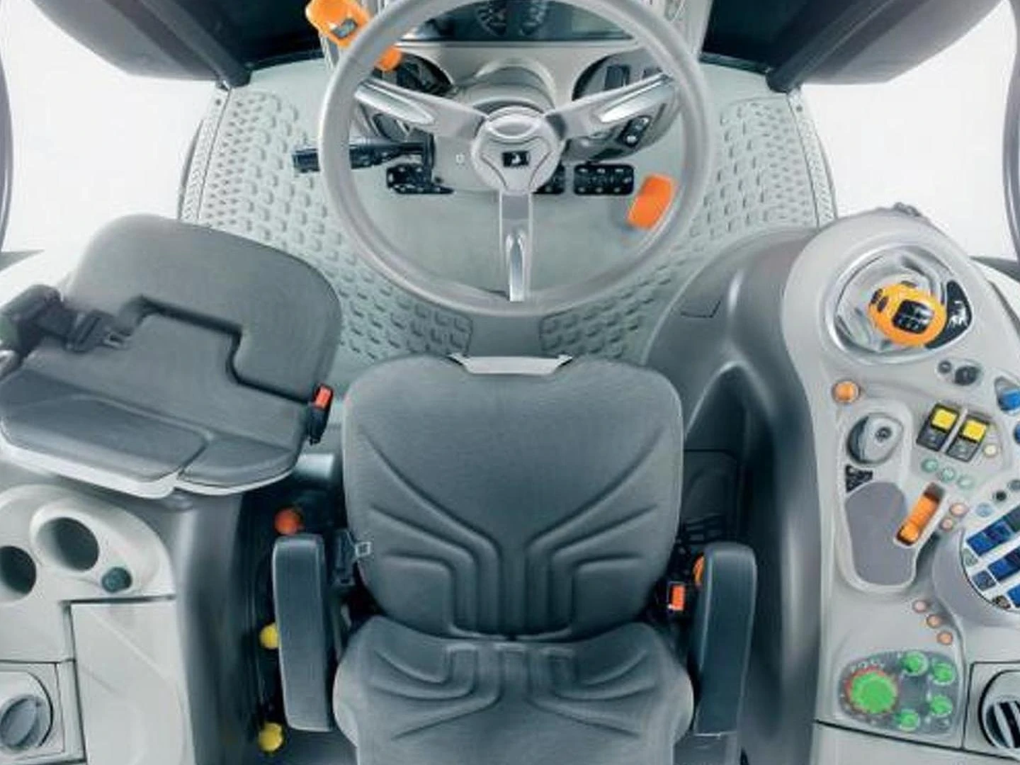

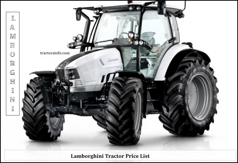

It is worth it for performance; I would not think you'd get more comfort; it is a tractor, not a sports car.....but you could spend a pretty penny & get a Lamborghini Tractor, I hear they ride smooth
