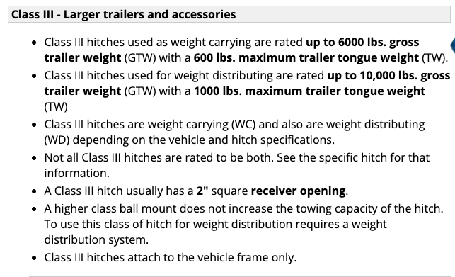

Yep, interesting. I'd wonder about the upward force on the hitch - pretty sure current hitches are not designed for such a continuous upward force with bouncing around. Conventional loads are downward with bouncing around.........
your hitch is rated for more as a weight distribution hitch then as a straight bumper weight,
that is a nice snazzy adjustable tag axle for pickups
/ Load divider dolly, #8
How do you know this? This snapshot says, 'it depends on the hitch.' It also says that the ones used for weight distributing are rated "up to......1000 lbs. maximum trailer tongue weight." This is still a downward weight rating. No mention of upward force ratings.....

Very true however I have never seen a receiver hitch that was not rated higher when used with a weight distributing hitch then when used as a straight drawbar pulling hitch.
Every equalizer hitch puts a lifting rotating force into the receiver hitch how else can it unload a rear axle and increase the front axle and trailer axle loadings.
For a long time, this was true. Some of the HD pickups have started coming with the same ratings, regardless of WDH use. I believe it was around 2018 or 2019 that started, coming from the factory.
/ Load divider dolly, #12
Very true however I have never seen a receiver hitch that was not rated higher when used with a weight distributing hitch then when used as a straight drawbar pulling hitch.yes, rated higher for a higher tongue weight - not for an upward force.
Every equalizer hitch puts a lifting rotating force into the receiver hitch how else can it unload a rear axle and increase the front axle and trailer axle loadings.i think we are missing some here. again, even for weight distribution hitches, the force is still downward on the truck hitch. The weight distribution arms just move the load rearwards so as to not put "as much" downward force on receiver hitch. In this trailer helper case (OP original post) it is actually pushing upwards.
