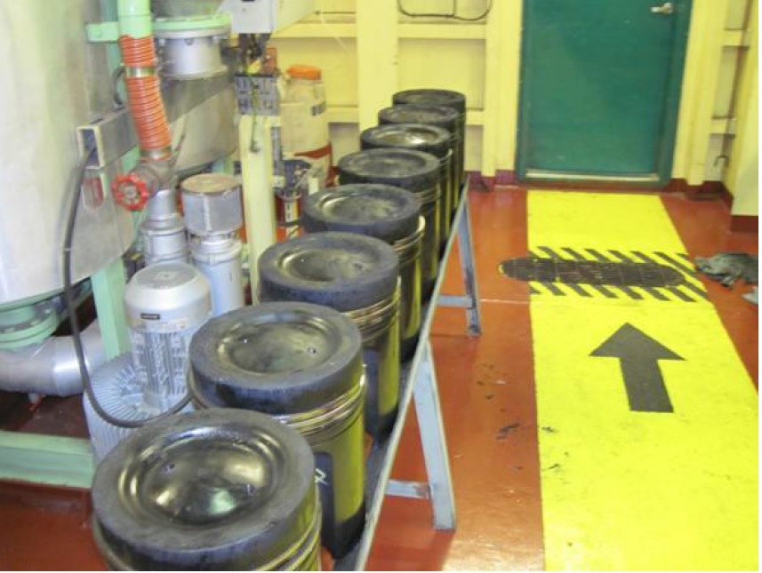

I work in the oil field as well, I'm offshore right now actually. We just went through a 24,000 hour overhaul on one of our 8 wartsila W26 V16 engines.
Heres a photo of all the A bank pistons set aside.
Well, as a fellow oilfield worker, I need to send you a PM, I've got something you may find handy for this project.
