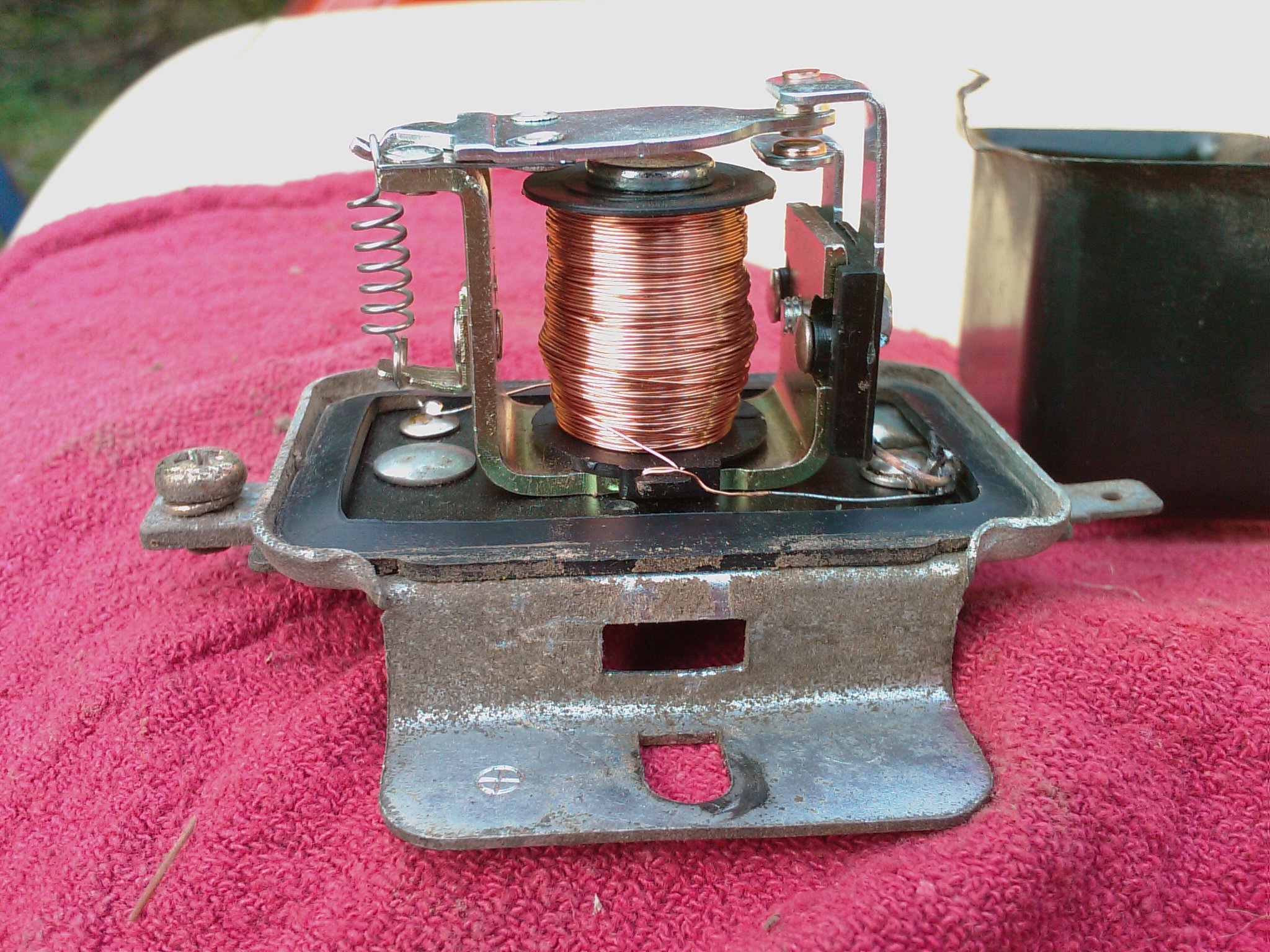

ok.. I was able to get some pics of the "regulator". I also was trying to trace the lines out of the original regulator... didn't take long for me to realize that I'm not too good with electrical stuff. I tried to do connectivity test on some of the wires out of the regulator and kept getting "everything is connected to everything" else results. I was able to check for voltage on the original regulator. The electrical diagram attached shows the I get 12v out of the blue and red wires when the key is turned on. I don't get any voltage out of any other connections at the regulator.
There is no voltage on the "field" connection on the alternator.
I hope you guys can make some since out of this.

Thanks for the pictures of the regulator insides. It tells me the unit is in good shape, the contacts look good, no sign of corrosion or pitting. When you put the cover back on, make sure it is tight the gasket is sealed well. I would also gently clean up the back side where the two wire wound resistors are.

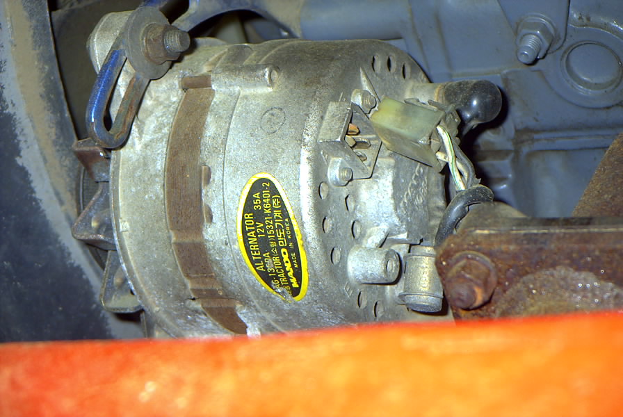

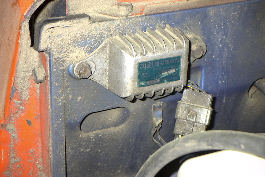

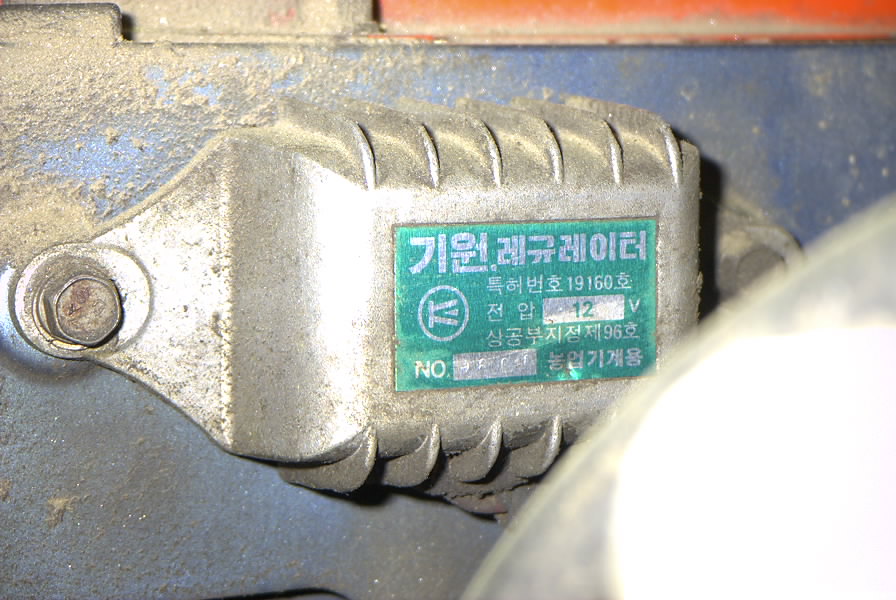

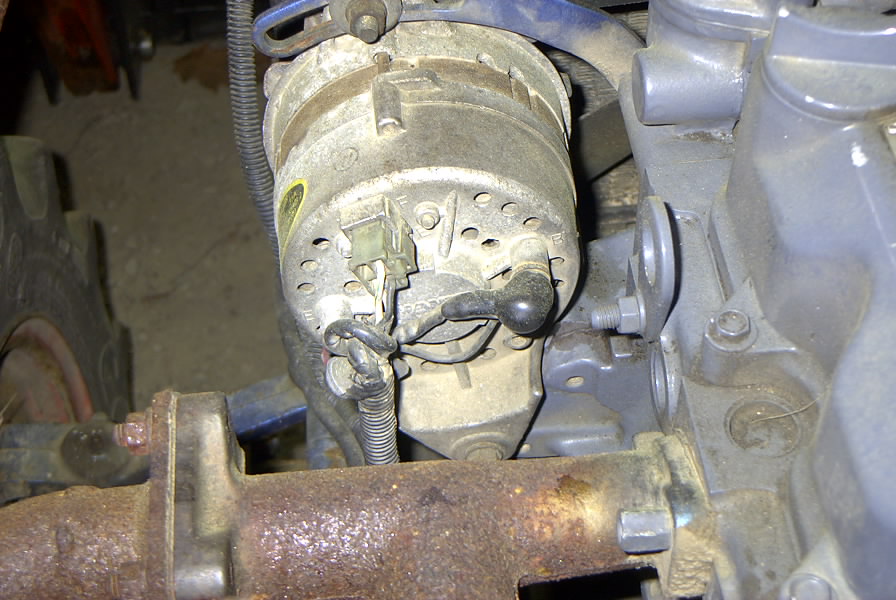

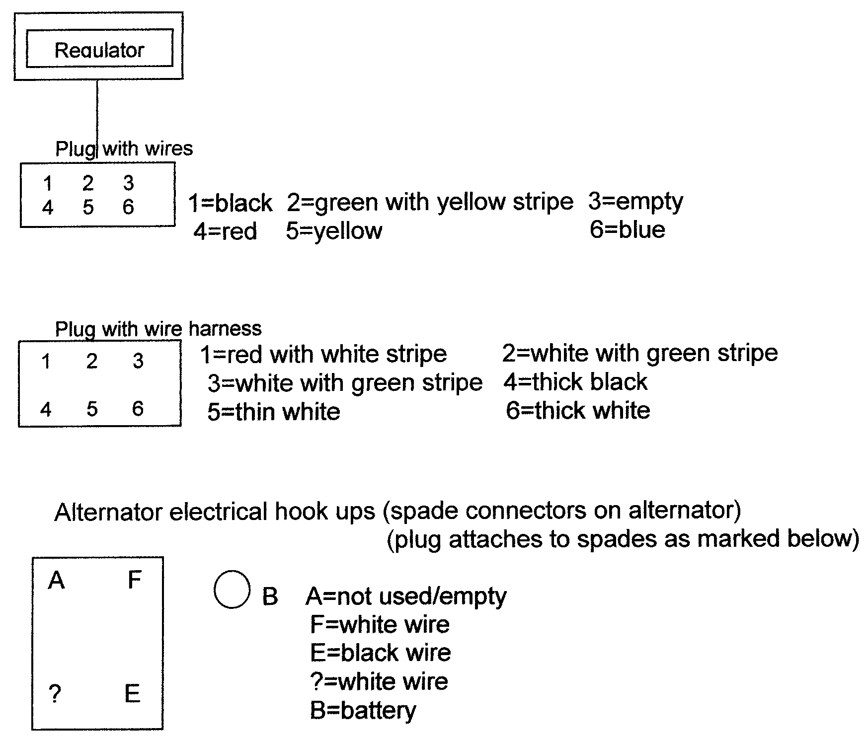

OK finally got to look at the machine so here's the info:
Alternator data off tag: AG1350A 12v 35 amp
"Tractor 15321-K6401-2"
My meter at the battery reads 14.8 volts while running.
I've attached some pictures for you of the regulator & alternator and also some crude drawings of the wiring harnesses. Hope it helps. Keep us posted.
John
Caught an error in my diagram - terminal F should be white wire with green stripe

Thanks John!
Those pictures and the diagram really give me something to work with. My wires from the regulator is very close to yours. I'll have to print all these out and see if I can make some sense of it. This really helps!!
After further review, I get...
white/green goes to "F" field
Black goes to "N"
white (or maybe white/blue) goes to "E"
right now i have 12v on white/green and white/red.....
I'm going to check these again to make sure
I got them right...
jb
