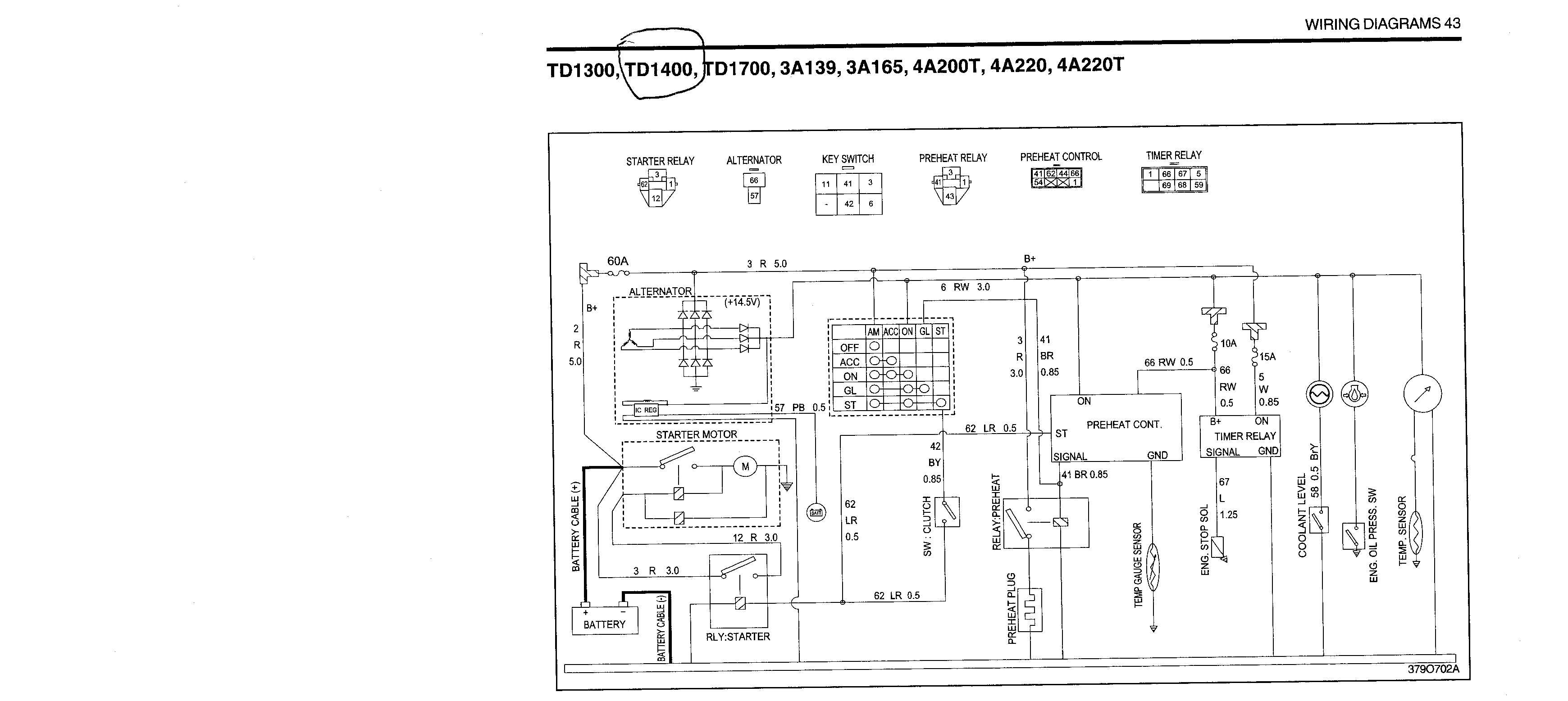

Jimmy, I will look at my machine when I get a chance (close by but I've been sick). In the meantime attached is the Electrical diagram from my engine manual - it differs from the LK3054 Owner's Manual Electrical diagram, but perhaps it's better.

Your diagram is the same as my CK30, it looks like the regulator is internal to the alternator, JB's is external. Where are all the service techs when you need one? :)

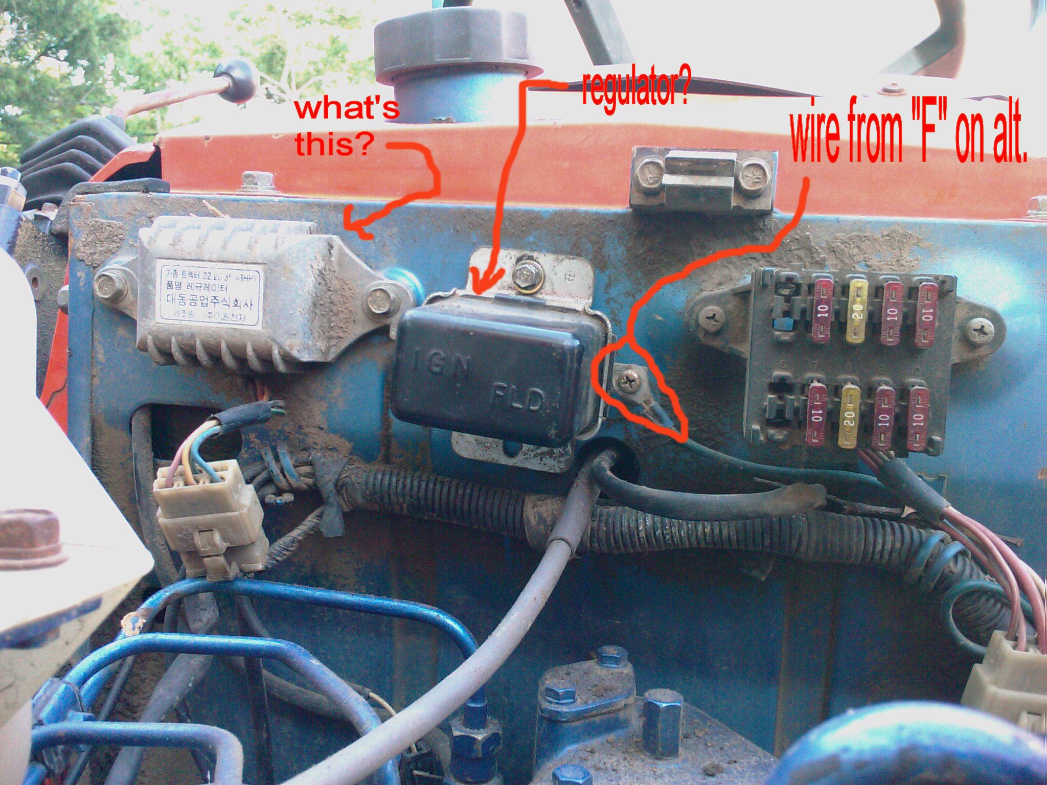

Thanks guys for your replys... and thanks kentrodngun for the diagram. I'm stil trying to figure all this out. I got out there this evening with my multimeter and camera phone... I checked the voltage at the battery before cranking the eninge and after... It was 12.34v each time. Checked again at about 1500 rpm and still 12.34v. I checked the "B" connections on the back of the alternator ang got the same. So it looks like maybe the alternator is not working correctly right? One thing I havent tried yet..(just thought of it) is to remove the positive battery cable after it's started and check the voltage on the alternator...
Here's a couple of pictures of the regulator (I think?) front and back. The wire from the "F" on the alternator is connected to the "FIELD" side of the regulator... There is no other wires connected to the regulator though... That doesn't seem right to me at all! What's the silver box with all the wires connected to it?
Thanks again for all y'all's help!!
jb

JB- Based on what you have said so far, there is no output from your alternator. I suspect after looking at your last pictures, that there is no input to the Field wire to the alternator. Next time you run the tractor, see if there is any voltage going to the "F" connector on the alternator, I suspect it will be zero. If so... that is where we need to start. I am guessing, based on mounting and wiring connector (ring lug), that what you have labeled as "Regulator?" is an aftermarket addon regulator. I suspect it is missing some wires and that is part of your problem. My guess, based on the wiring connector (6 pin molex) and the mounting, is that what you have labeled "What's this?" is the original regulator. It is still connected to part of the system, which is why you have the alt light on the dash, but no longer connected to the Field of the alternator and that is why there is no alternator output. If you notice, things that look original, are mounted to bumps stamped in the sheet metal, the suspected aftermarket item is bolted to flat sheet metal.
I hate to say say this... but at this point... I would trace out all the wires from the item you have labeled "what's this?" This would verify that it is indeed the 'old' regulator, we can see what goes where and what needs to be corrected. This is not going to be a fun task, but it is necessary before we put in a new regulator (which is what i suspect you need) and possibly blow it up, :( lets try and avoid that. :) After looking at all your posts again, it might be possible that your alternator is not the original one either... that is really going to muck up the troubleshooting. :confused:
It would be really good if some of the other 3054 owners would chime in and let us know what they have.

Thanks again or the input IXLR8.... It is all strating to make some sinse... The black "regulator" is only held on with the one screw on top. It's a "self tapping" sheet metal screw. That thing's been flopping around up there til I added some washer to it to help it tighten up. So it's very likely that "regulator" is doing nothing but looking ugly.?... I'll check the voltage on the "F" connection next time I crank it up. And I will start tracing out the wires on the "original regulator" and see where they are going.
So it is likely that the alternotor doesn't work at all and that I am running only on battery power. All other things electrical seem to work... headlights, flashers, dash lights... but I only turn them on for fun once in a while... I hardly ever work after dusk... so those things aren't really draining the battery.

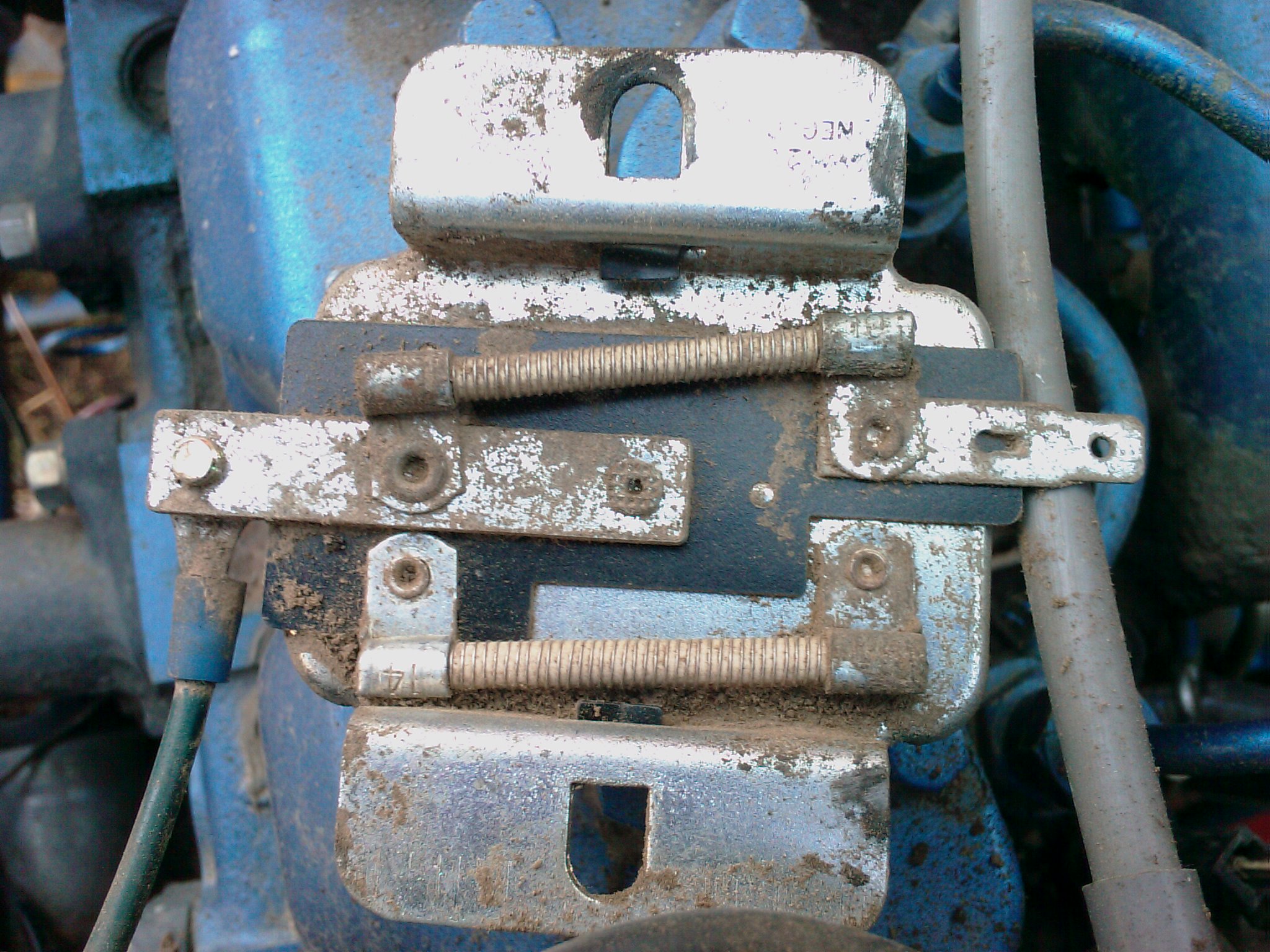

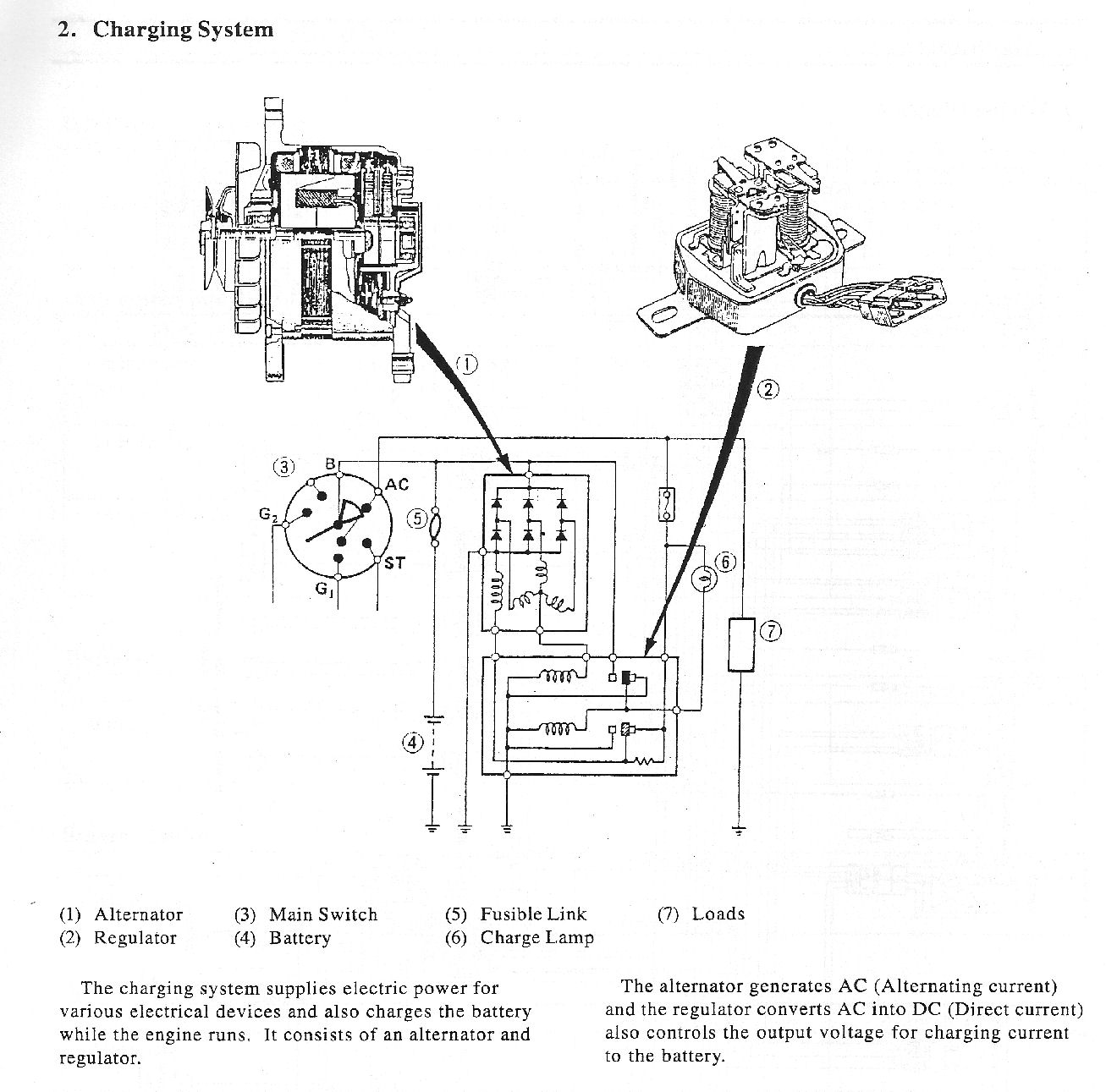

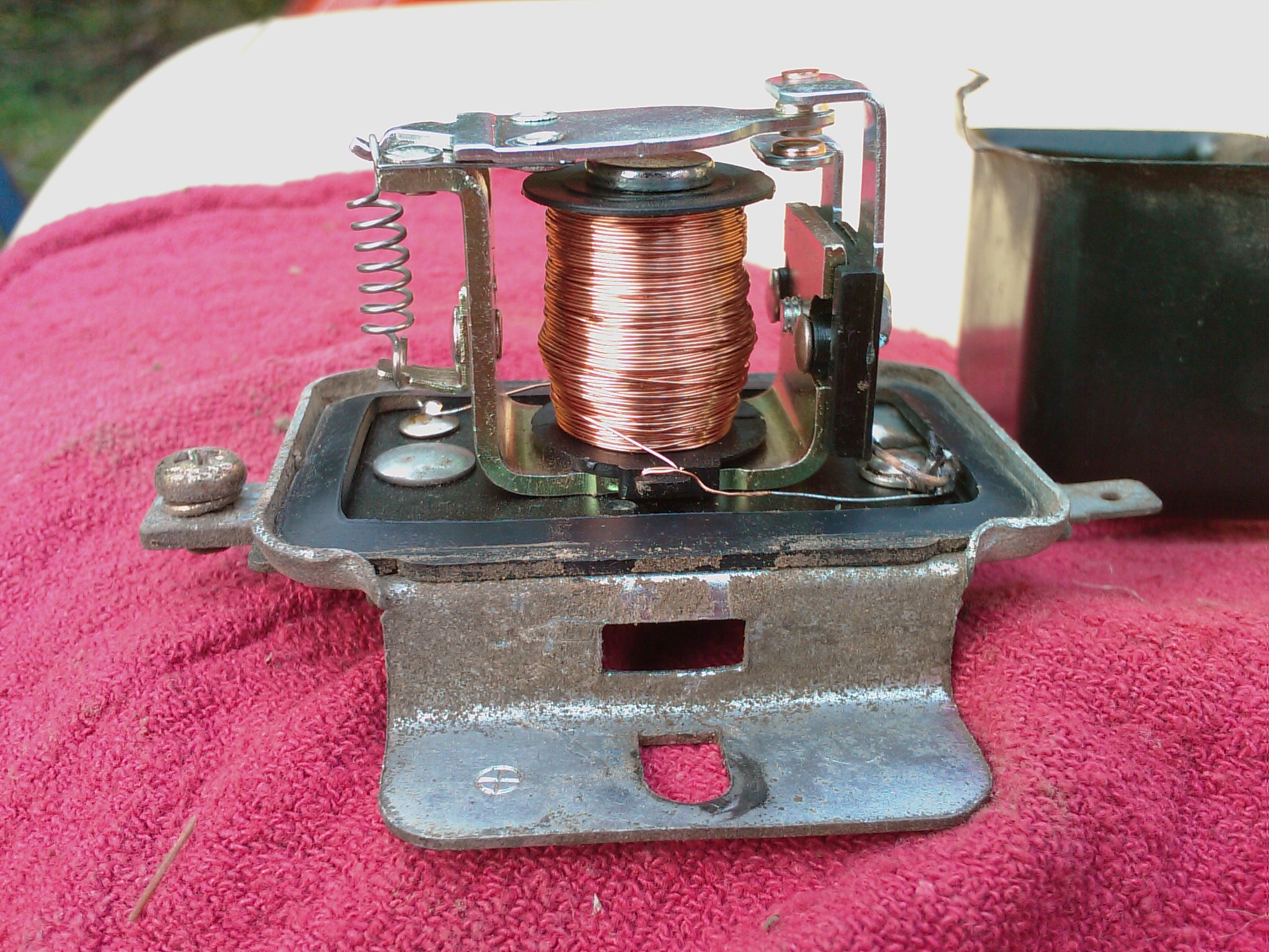

ok.. I was able to get some pics of the "regulator". I also was trying to trace the lines out of the original regulator... didn't take long for me to realize that I'm not too good with electrical stuff. I tried to do connectivity test on some of the wires out of the regulator and kept getting "everything is connected to everything" else results. I was able to check for voltage on the original regulator. The electrical diagram attached shows the I get 12v out of the blue and red wires when the key is turned on. I don't get any voltage out of any other connections at the regulator.
There is no voltage on the "field" connection on the alternator.
I hope you guys can make some since out of this.
jb
Did you put the voltage readings on the schematic you posted, along with the wire colors? I spent some time tracing the wires in the schematic... either the color coding is wrong, the schematic is wrong, or the wires change color between pt A and pt B. :( Makes it difficult to sort out.

Thanks for the pictures of the regulator insides. It tells me the unit is in good shape, the contacts look good, no sign of corrosion or pitting. When you put the cover back on, make sure it is tight the gasket is sealed well. I would also gently clean up the back side where the two wire wound resistors are.
I think the 12v readings you got on the Original Regulator are the battery input, red wire, and the field output, blue wire. I suspect the yellow wire goes to the alternator warning light on the dash, so I am a little surprised you didn't have 12v there as well. Although, the blue wire could be the lamp with the yellow for the field. Is there any sign of cut wires around the alternator, if so, what color are they? I would be looking for a blue or yellow wire. Is there a connector tucked away somewhere nearby? Since we don't know were these wires go.. I suggest we don't mess with this regulator, yet.

One the schematic, I did add the wire colors (and voltage of the red and blue) for the wires leaving the original regulator. Some of the wires do change color at that first connection. (green goes to white, blue to white/green, yellow to white/blue) and there are many splices and dead end wires down near the starter. tracing these would be a nightmare!

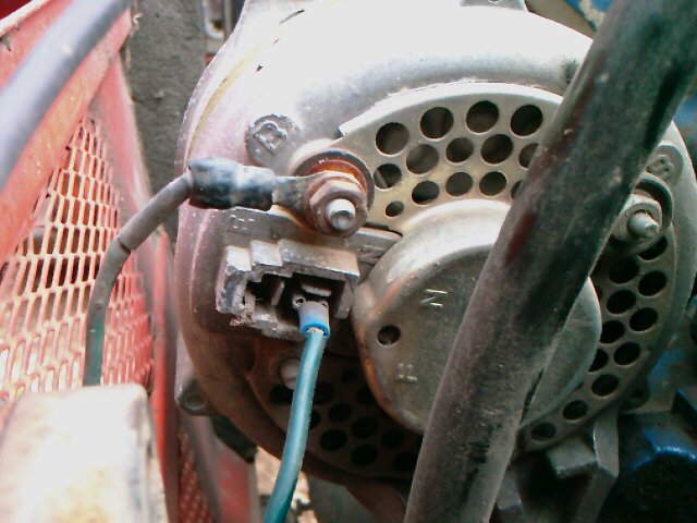

OK finally got to look at the machine so here's the info:
Alternator data off tag: AG1350A 12v 35 amp
"Tractor 15321-K6401-2"
My meter at the battery reads 14.8 volts while running.
I've attached some pictures for you of the regulator & alternator and also some crude drawings of the wiring harnesses. Hope it helps. Keep us posted.
John
Caught an error in my diagram - terminal F should be white wire with green stripe

Those pictures and the diagram really give me something to work with. My wires from the regulator is very close to yours. I'll have to print all these out and see if I can make some sense of it. This really helps!!
After further review, I get...
white/green goes to "F" field
Black goes to "N"
white (or maybe white/blue) goes to "E"
right now i have 12v on white/green and white/red.....
I'm going to check these again to make sure
I got them right...
