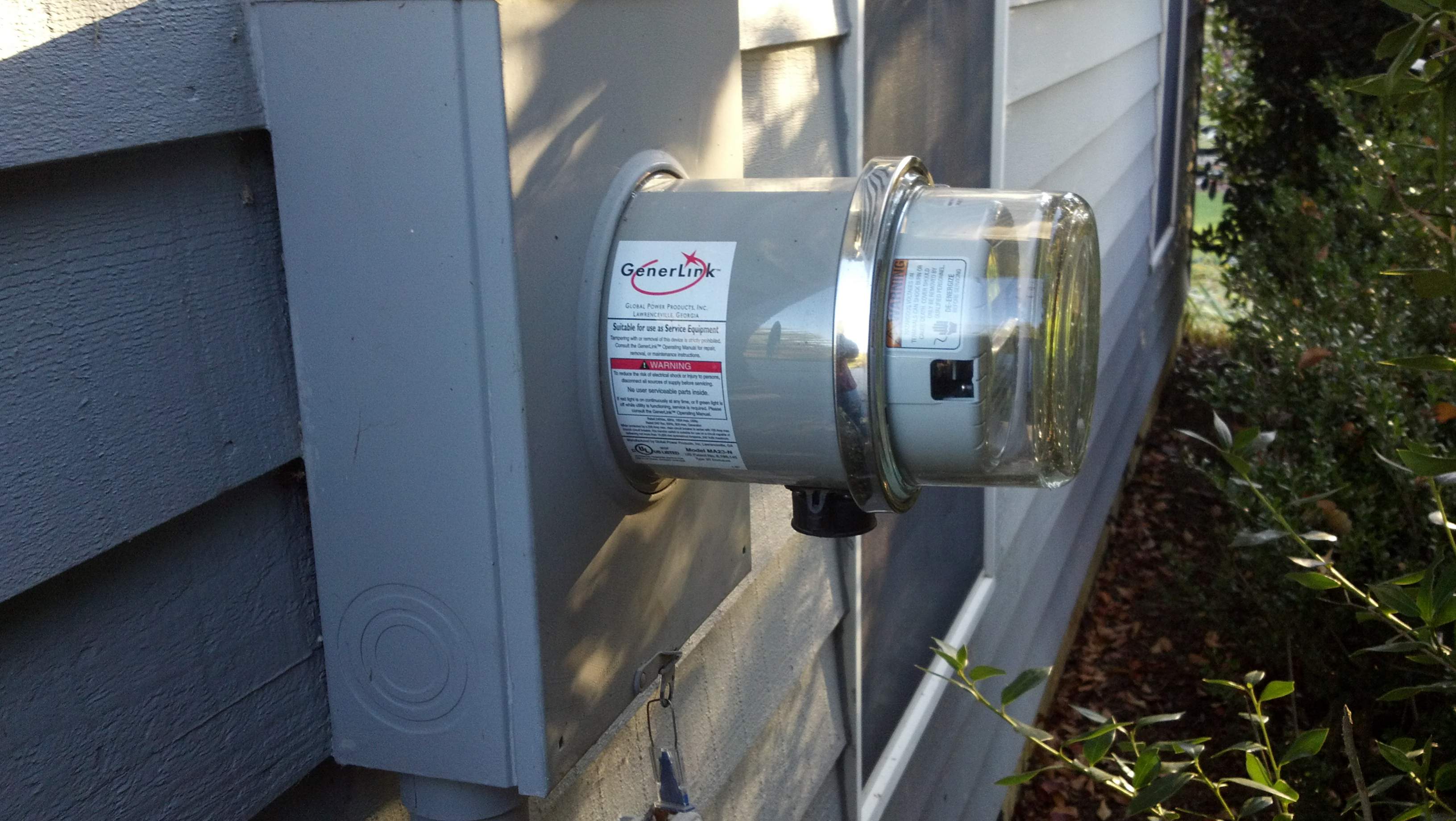

You might want to take a picture and post it up for suggestions. Whose your electric utility?
I ran into that situation. Underground fed meter box outside, with GE 200amp service panel on the interior side. Of course all insulated, sheetrock, and painted. So much so, that the Generlink was really the cheapest easiest option there.
   / Live in the sticks Generator switch?
#28
Howdy,
:cool2: going to have to look into this but it looks to easy. http://http://search.aol.com/aol/search?enabled_terms=&s_it=wscreen50-bb-ac&q=generlink
