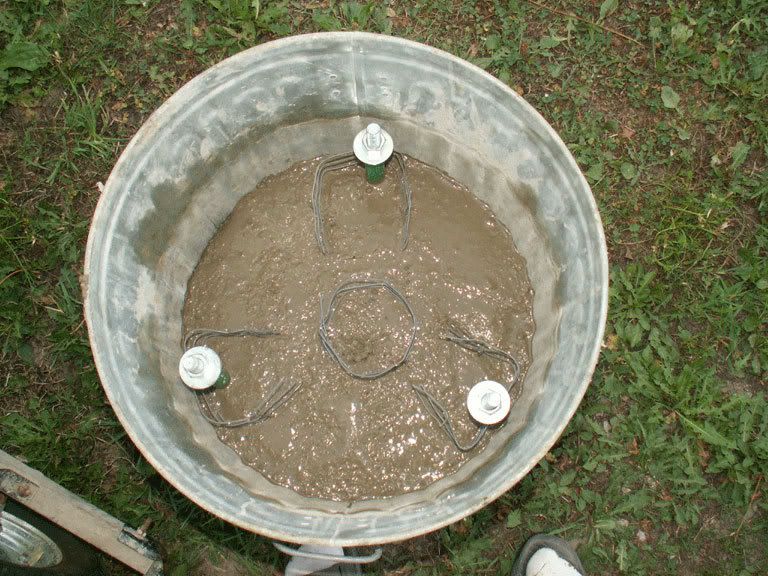

I then push the wood pieces tight in the trash can.
I then poured a little concrete in the the trash can.
I then added metal fence for reinforcement.
http://i187.photobucket.com/albums/x10/todd_and_katy/WheelWeight/WheelWeight2.jpg
Poured the rest of the concrete.
Put the handle (bolt) in the concrete.

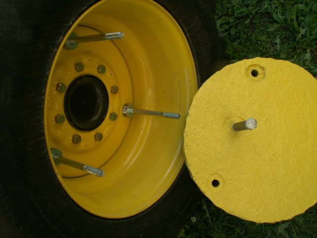

Attached the bolts to the rims using collars.
http://i187.photobucket.com/albums/x10/todd_and_katy/WheelWeight/WheelWeight3.jpg
Slid the wheel weights on the bolts and tightened.
Unscrewed the handle from the nut/washer embedded in concrete.
Weight is about 85 pounds per wheel weight.

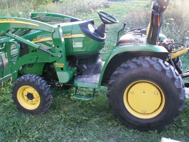

What does JD want for wheel weights, and how much did yours cost? Good job.
   / Little Concrete Wheel Weight Project
I don't remember how much the John Deere wheel weights were, but I remember I thought they were expensive. I think it was around $100 per wheel.
My total cost, just guessing, is probably $13 for the collars, $9 for concrete, and $13 for bolts, washers and nuts. So probably about $17.50 per wheel. The rest of the ingredients were just hanging out waiting to be used.
Thanks for the complements everyone.
   / Little Concrete Wheel Weight Project #8
Thanks for posting this simple yet very effective idea!!! I didn't want my rear tires filled and so far was too cheap to buy wheel weights for my tractor, because they would set me back by about $120 or so. DIY is the way to go. You should paint a smiley face on there with green paint. That is what I'm going to do.:) I made my weight box too for about $20 following suggestions from TBN members.

Hope you torqued those lug bolts before the weights went on, cause you ain't gonna get to 'em easy now.
   / Little Concrete Wheel Weight Project #10
I don't see the valve stem, or is it hiding on the back side of the wheel for some reason.
