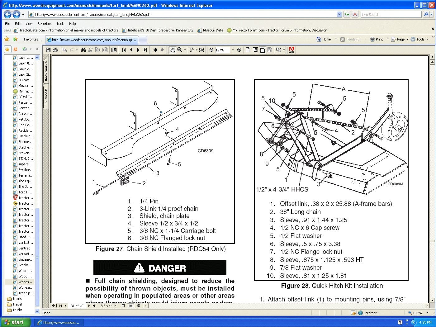

Runner, could you post a close up of the RFM adapter?
I have a 6' Woods, and use a Speeco floating top link, but it doesn't float enough....
I recall the Woods kit as being $100+, but have never actually seen one.
I'm wondering if it's something that I can rig up.
Thanks,
Jon

Galway,
Here's the parts diagram from Woods for the iMatch adapter kit:

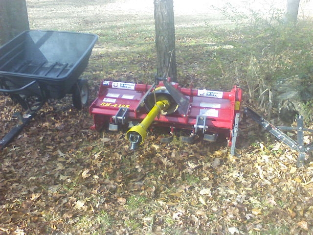

I have a sitrex RH -4125 tiller that worked "right out of the box"
