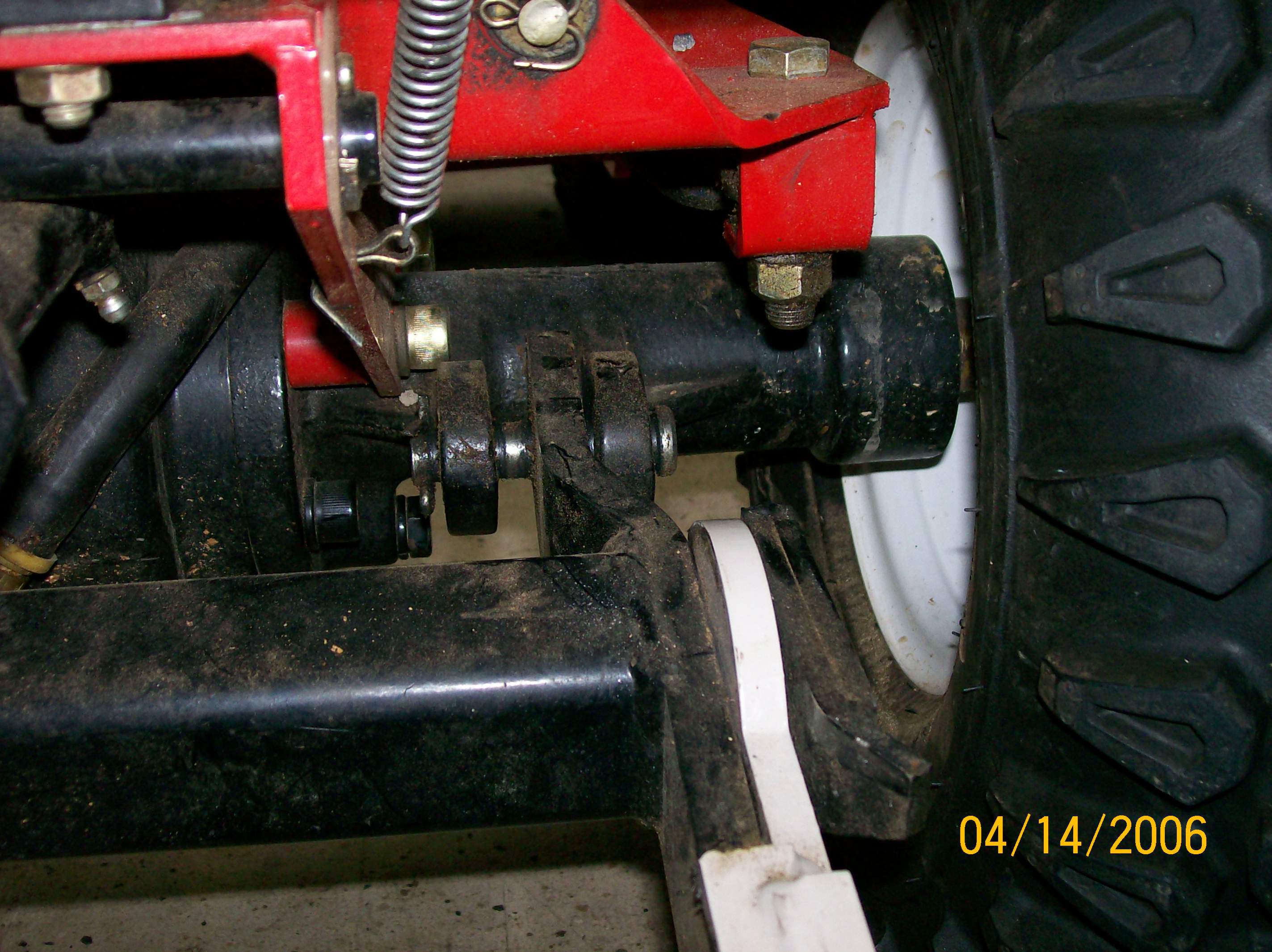

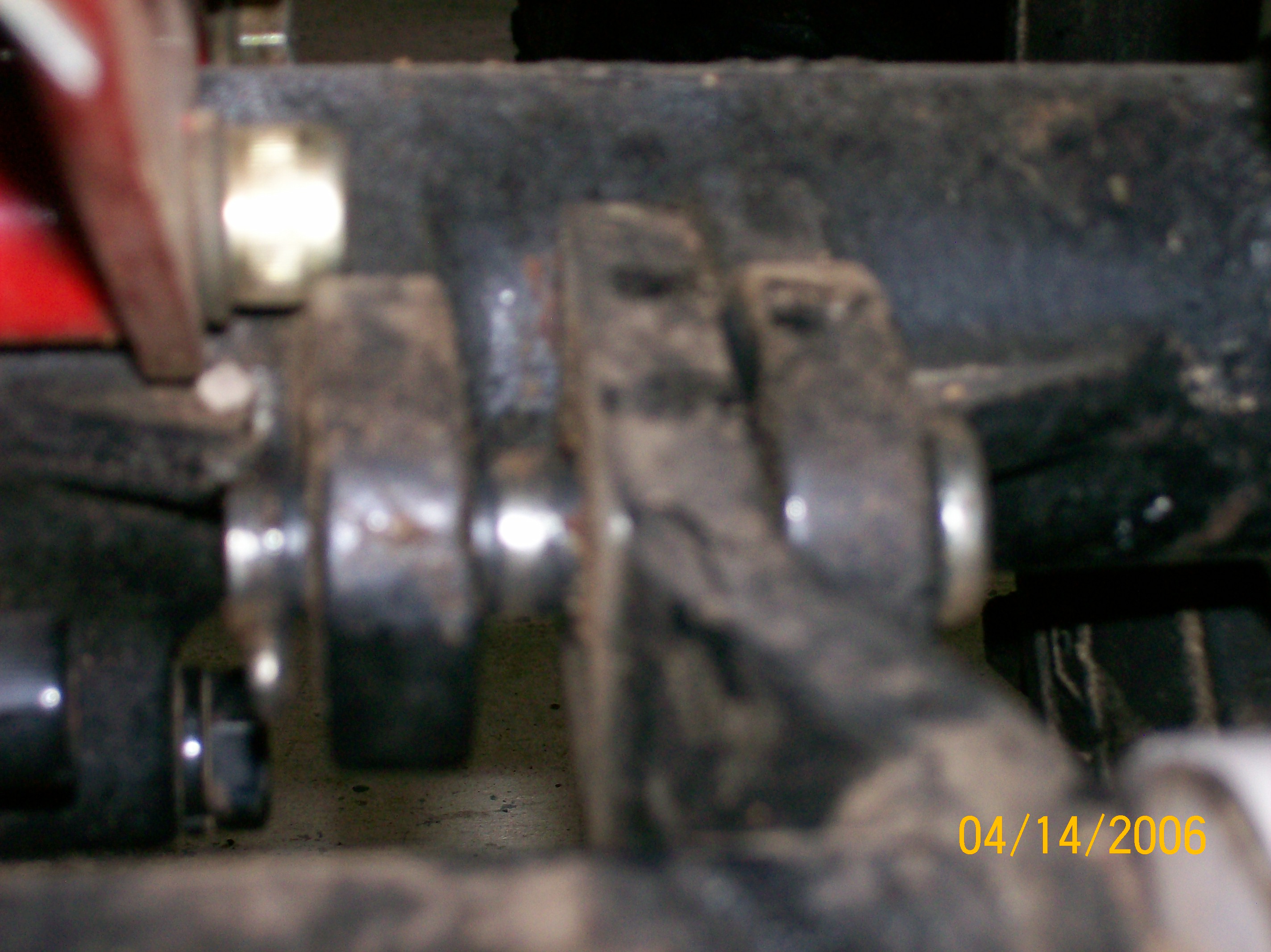

Since we are talking about Steiner and Power Trac, the pivot pins on the PT lift are bolts with with a nylon lock nut, am I right? My Steiner has pins with no grease fittings or anything to stop the pins from rolling inside the mount holes. Therefore, obviously likely to wear the holes lose. Do the pins/bolts on your machine move at all when lifting a heavy load? If I remember right there are grease fittings on the PT 1430, but not the PT 425?
   / Link to stump grinder project #17
Yep. Just bolts through sleeves through (can't remember the name) round joints. I spray them with lube every 8 hrs. 13 years. no signs of wear yet.
   / Link to stump grinder project #18
The 13 years sure did put it to the test, and I'll definitely keep that in mind with pivot points from now on. Thanks
