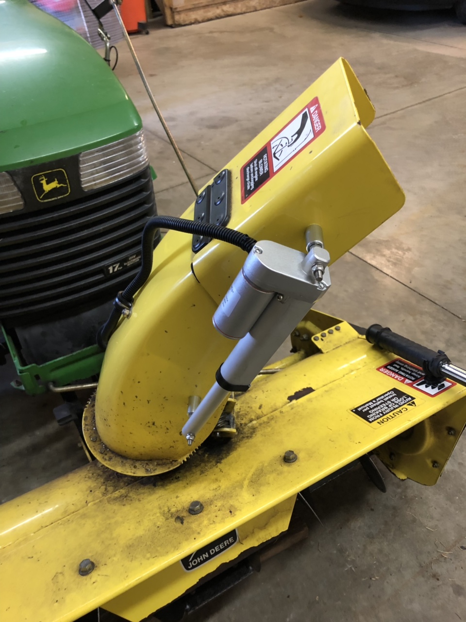

I have hydraulic chute rotation, but would like to be able to adjust the deflector on the fly, too. Would a linear actuator work reliably as a chute deflector adjustment mechanism?
/ Linear actuator #3
+1 on it should work. Some of those and get pretty pricey though. Plus, you need to run the wire so it doesn't get tangled or chaffed.
/ Linear actuator #4
I put a linear actuator on my 52 in snowblower 5 or 6 years ago. Works great. I used a 4 pin trailer plug male and female, because it was weathertight rubber and easy to take apart in spring to take snowblower off tractor. I ran the wiring thru a rubber garden hose from tractor to actuator on chute. So it was stiff and easy to weave where I wanted but not too stiff to give with up down motions. I think it can be seen in the attached old pic.

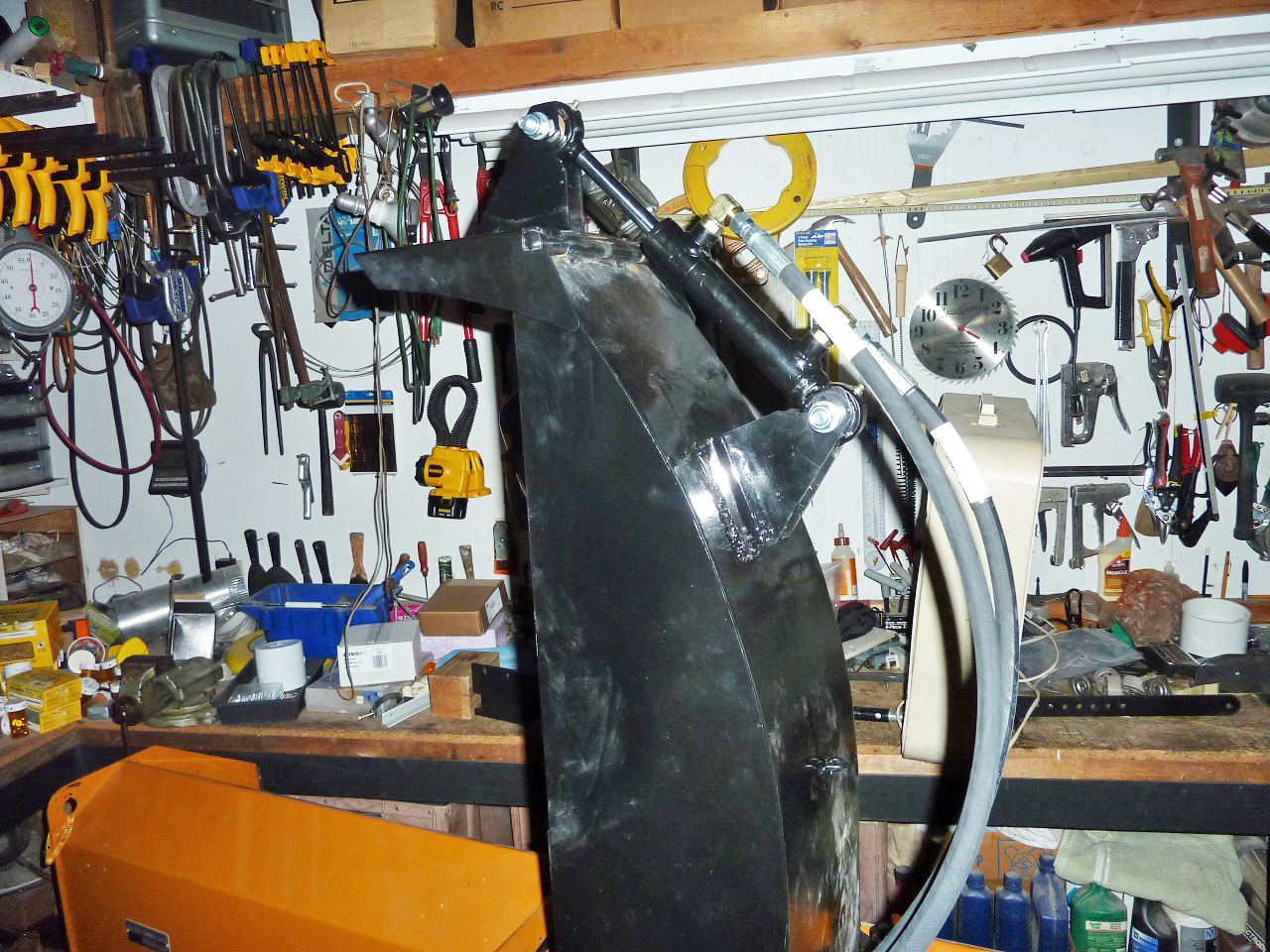

Since you have hydraulics on your tractor for the rotator, why not use a small hyd cylinder on the deflector such as this kit:
It comes with the hoses so the cost would be comparable to the parts necessary for the linear actuator. It might be less work to install if you have a spare hydraulic port.
I converted the manual deflector on my Woods SB72 with this kit:

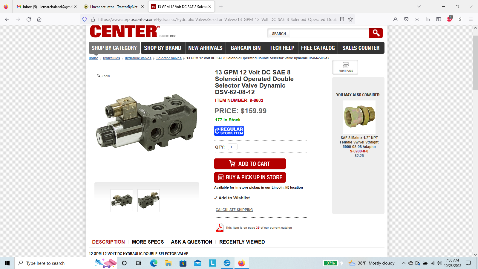

When I bought my blower it had the same setup (hydraulic rotator and manual chute deflector). I didn't want a linear actuator because of the slow speed. Instead I bought a 12v solenoid operated double selector hydraulic valve with an on-on switch placed in the cab. I have been very happy with the speed of the deflector and the lack of maintenance required. It is a very robust system.
