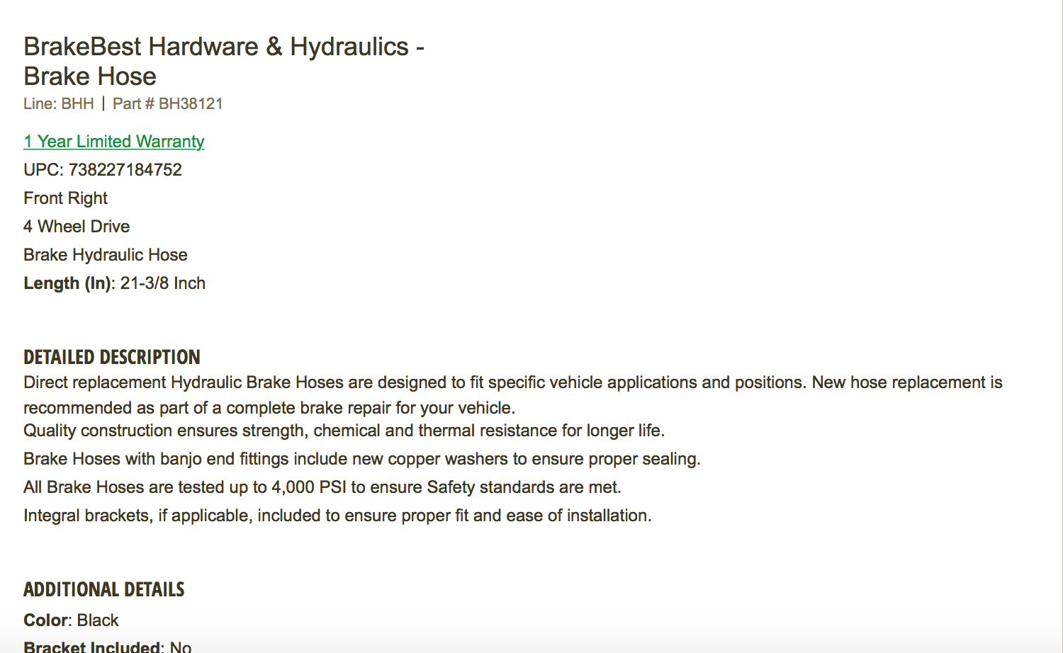

I just looked up a typical brake hose, in this case for my old 92 F250 7.3L IDI truck, they are "tested" to to 4000psi, so they are obviously expecting the average working pressure to be much lower.
Yes, the OP did say what his tubing is spec'ed at-and that does sound usable in this case, but the average steel brake lines are NOT rated to what he posted-hence my first reply.
Here is a Dorman "kit" for a GM truck, again notice the rating at 4000psi:
Dorman Products - 919-116
Here is a few brake line gauge kits, notice the pressure range on them:
Brake Pressure Tester Gauges : Brake Pressure Gauges : Racing Brake Pressure Tester Gauges
Brake Hydraulic System Pressure Bleeder Pressure Gauges - Free Shipping @ Speedway Motors
Auto Meter 4426 | Buy Auto Meter Ultra-Lite Gauges at JEGS
Fact are facts sir, your just not going to generate that high of pressure in an automotive braking system.
