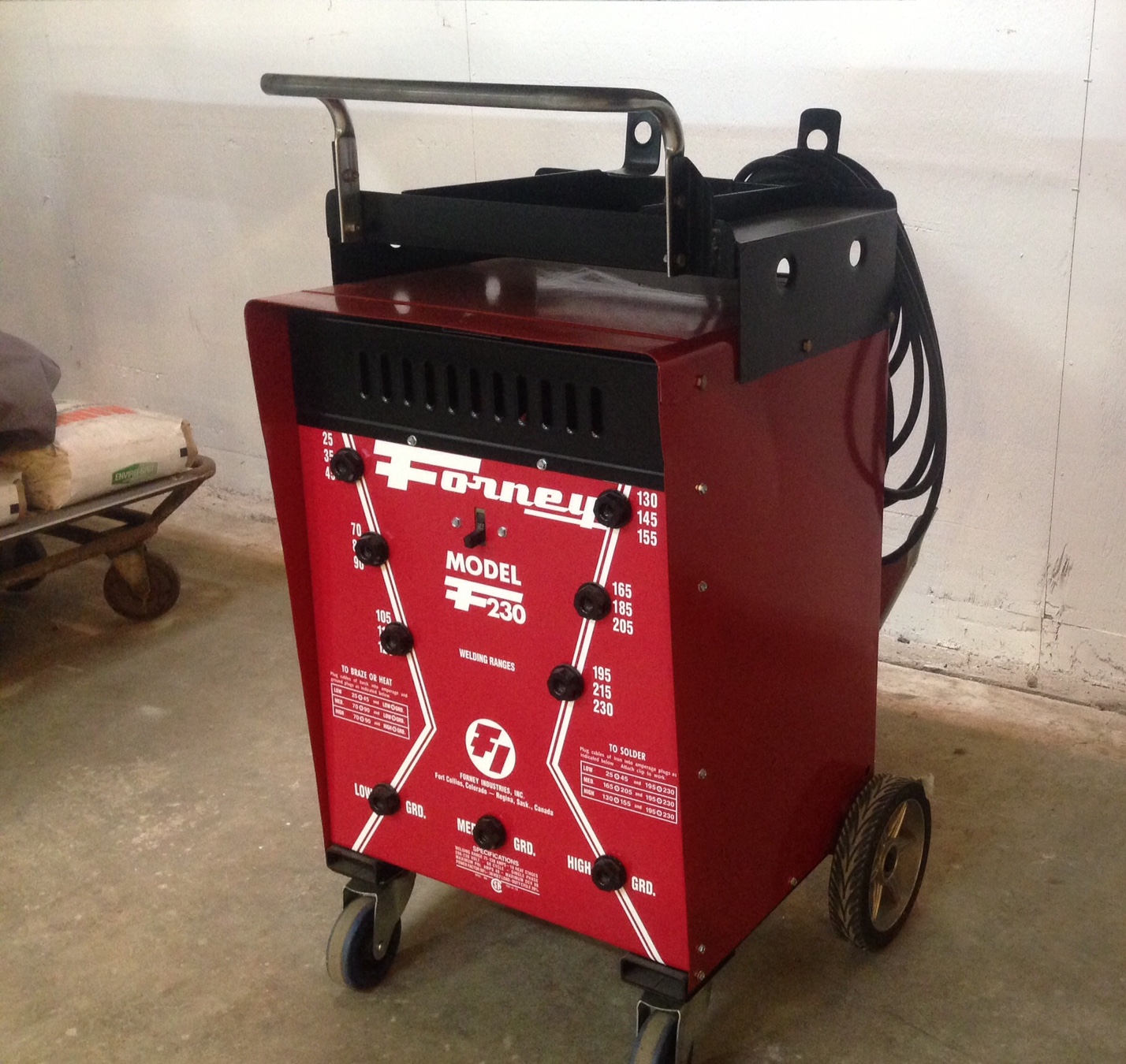

We bought this buzz box new in 1965 and the ONLY problem I had in over 50 years was one loose connection inside the box.
Here it is today. Just keeping it for sentimental reasons...
