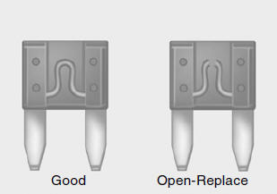

Tractor is back home!
I got my tractor back this morning and it is fixed. If I understand things correctly, the headlights and the tail and brake lights came from the factory, all on the same 15 amp fuse. The wiring itself is big enough to carry over 20 amps, which is good, but when a 20 amp fuse was put in, the fuse itself got hot. To fix the problem, the tail and brake lights were moved to a spare slot and now have their own fuse. One again, I'm neither a mechanic nor an electrician, and hope I'm stating this correctly. My dealer really went the extra mile necessary to track down and fix the problem. For their efforts, I'm really grateful.

To state it another way, they re-designed the circuit, by offloading some of the potential load onto another circuit with a separate fuse. it sounds like the original circuit design was marginal at best for the possible loads that could be placed upon it. That is why the fuse did not blow catastrophically, but in a slow overheating mode. This is why I asked about an examination of the blown fuses to start with, which would have indicated a slowly overheated fuse and not a "dead" short to ground. I sincerely hope they are correct in their diagnosis, and you have seen the end of your electrical problems. :thumbsup:

That's a good fix. The 20 amp fuse might have handled it even though it was running warm. That is what fuses run at near full load do. However splitting the circuit up is better. And if one fuse blows you still have some lights.
Yes, originally, there was a pretty heavy load on the fuse that kept blowing. The halogen headlights are something like 60 watts each.
