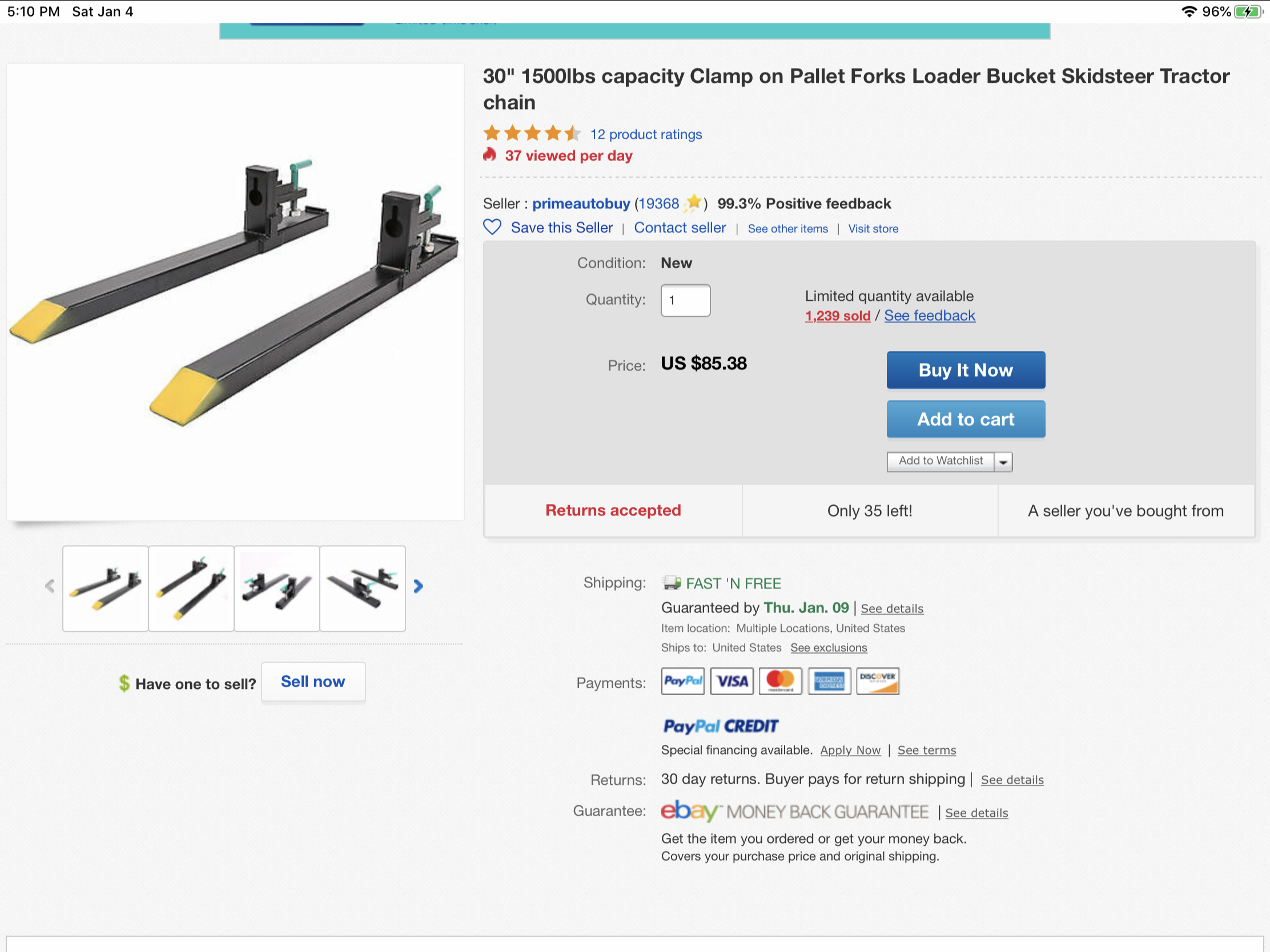

Thinking some forks would be really handy for unloading occasional deliveries. Kubota L3600 loader load limit is something like 800 lbs as I recall and with forks out farther should probably limit to about 500 so 1000 lb forks should be good. Have hear the stabilizer bar is a good thing to have. I saw the Northern tool ones are stamped rather than square tubing. Maybe ok but wanting to get some feedback on recommended suppliers.
Ebay is where I got mine. I got the long ones because I pick up pallets. Use on my 2400 as I have a fork attachment for the 6530. You are very correct on the brace bar to keep them parallel if your load will allow you to use it and also your taking into account ft x lbs....if the feet go out the pounds have to come off is absolutely correct.....limiting factor on small tractors and even moderate loads.....besides requiring adequate rear end weighting of some sort.
