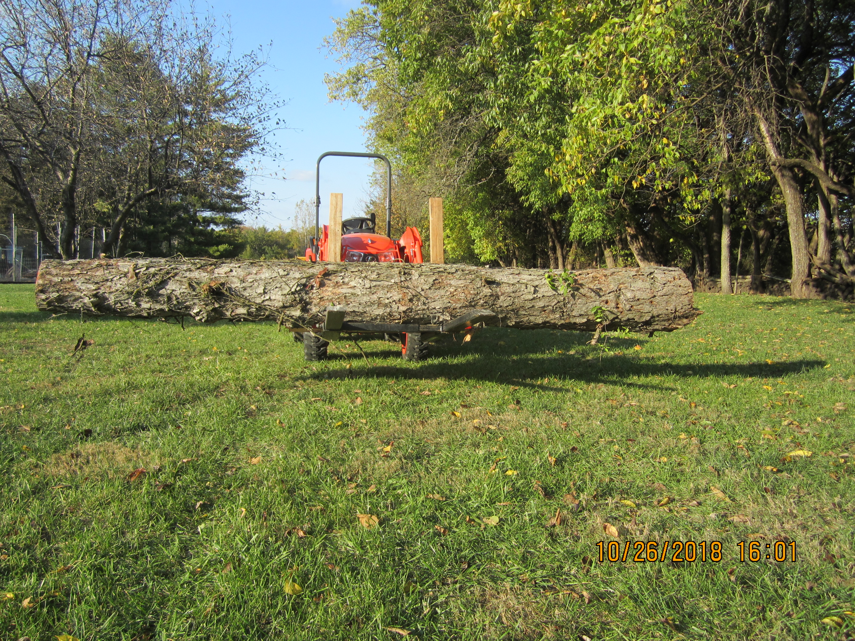

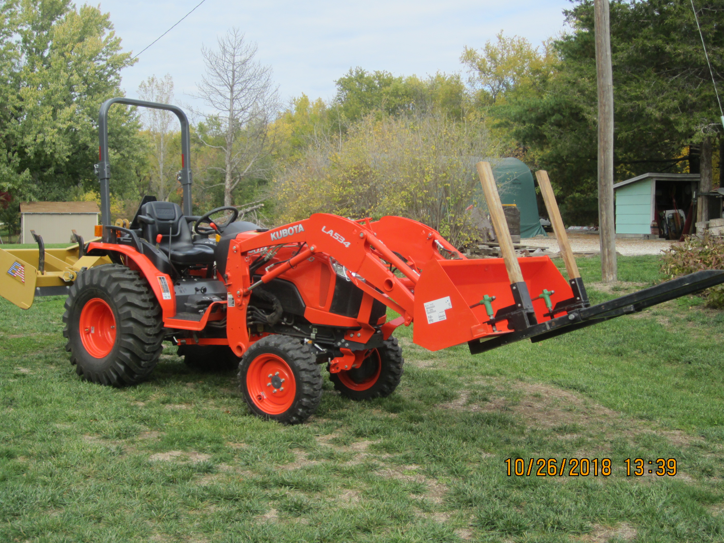

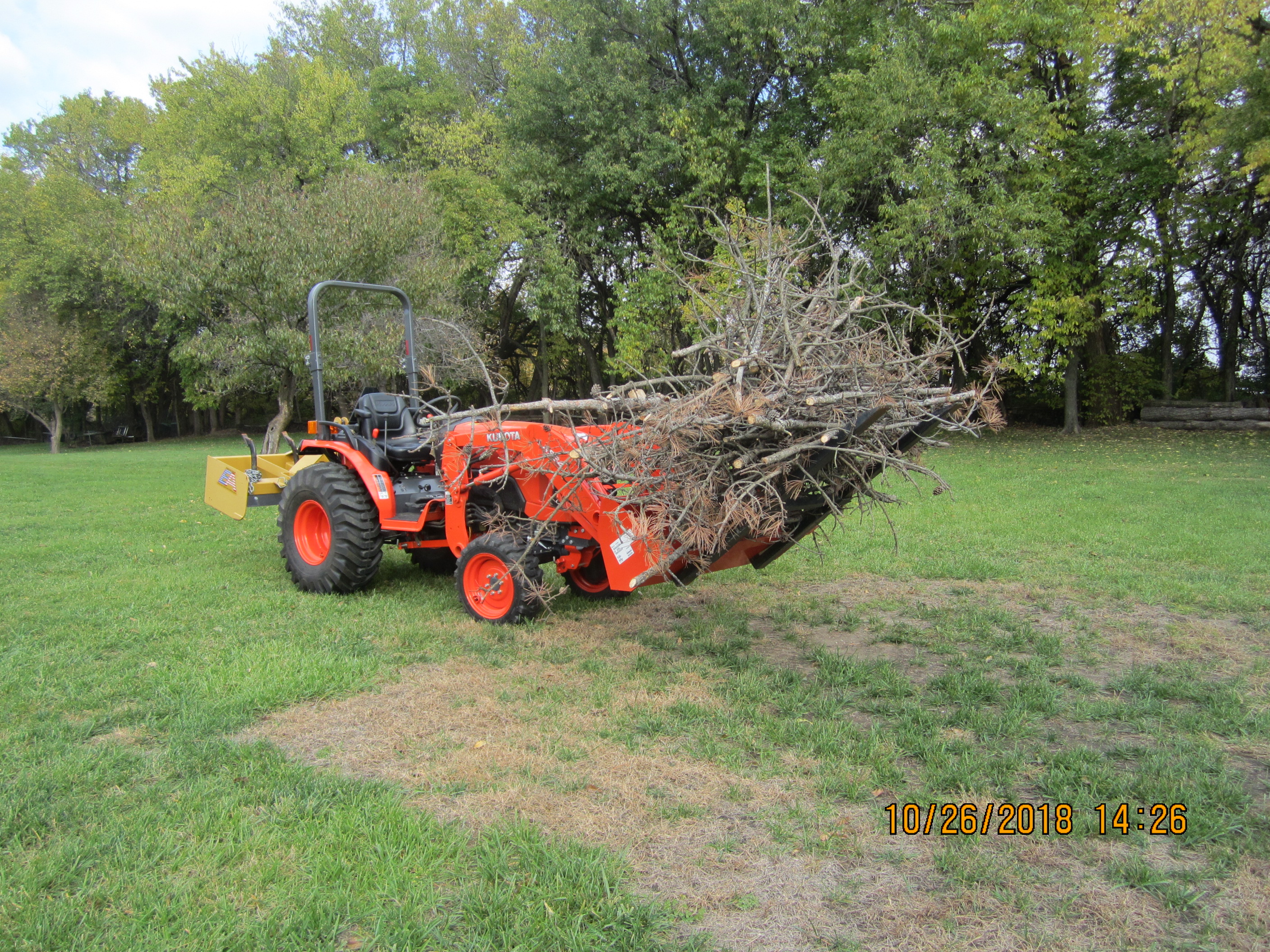

I have found that clamp on forks are quite handy. Although I have lifted some very heavy load, my bucket has never been distorted...just some scratch marks where the clamp heads mount. Bucket Solutions are the manufacturer. 009.JPG006.JPG012.JPG
Cheers,
Mike
