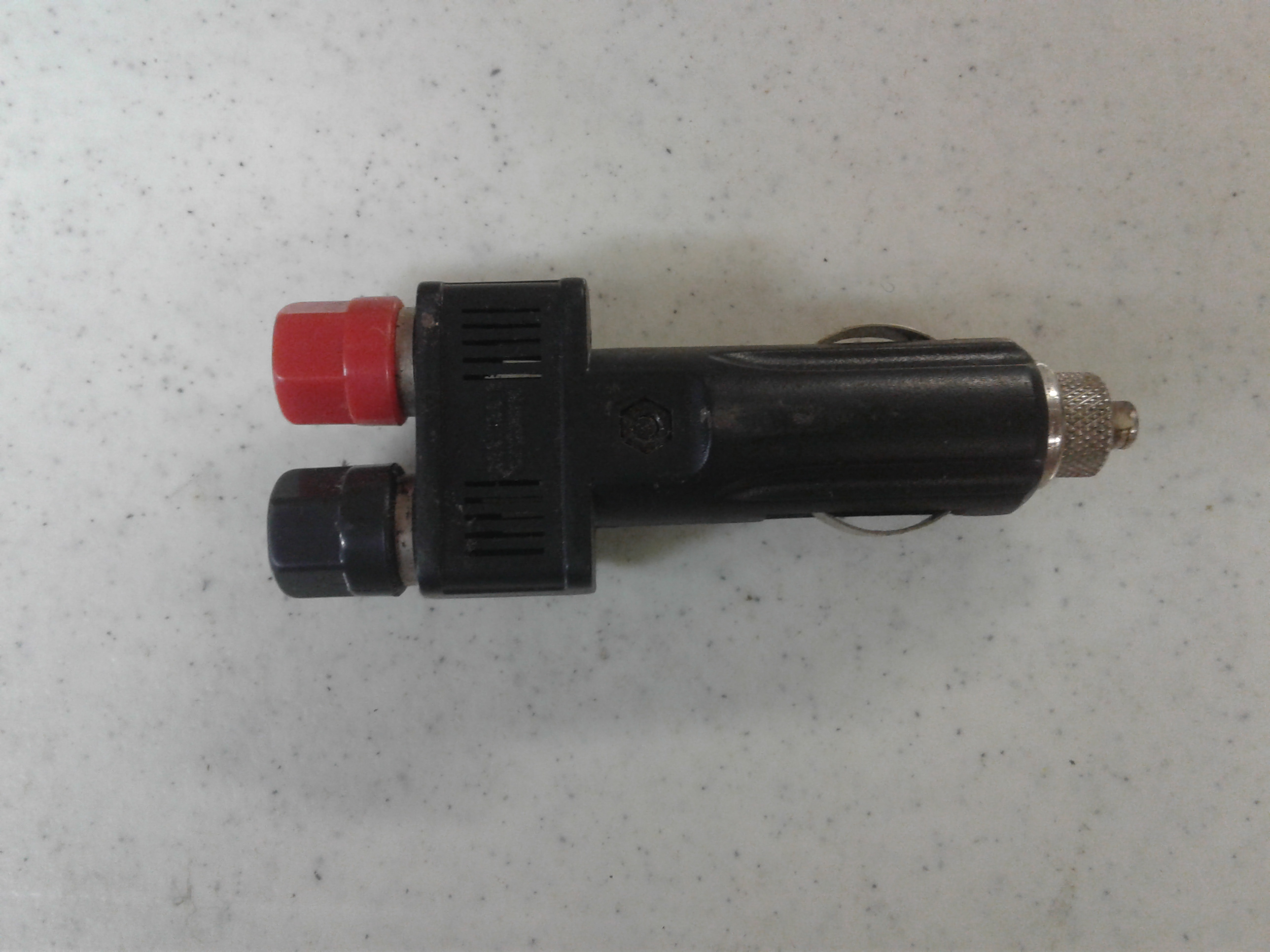

Debating setting up a couple lights off a cigarette plug or wiring a dedicated fuse block and switch.

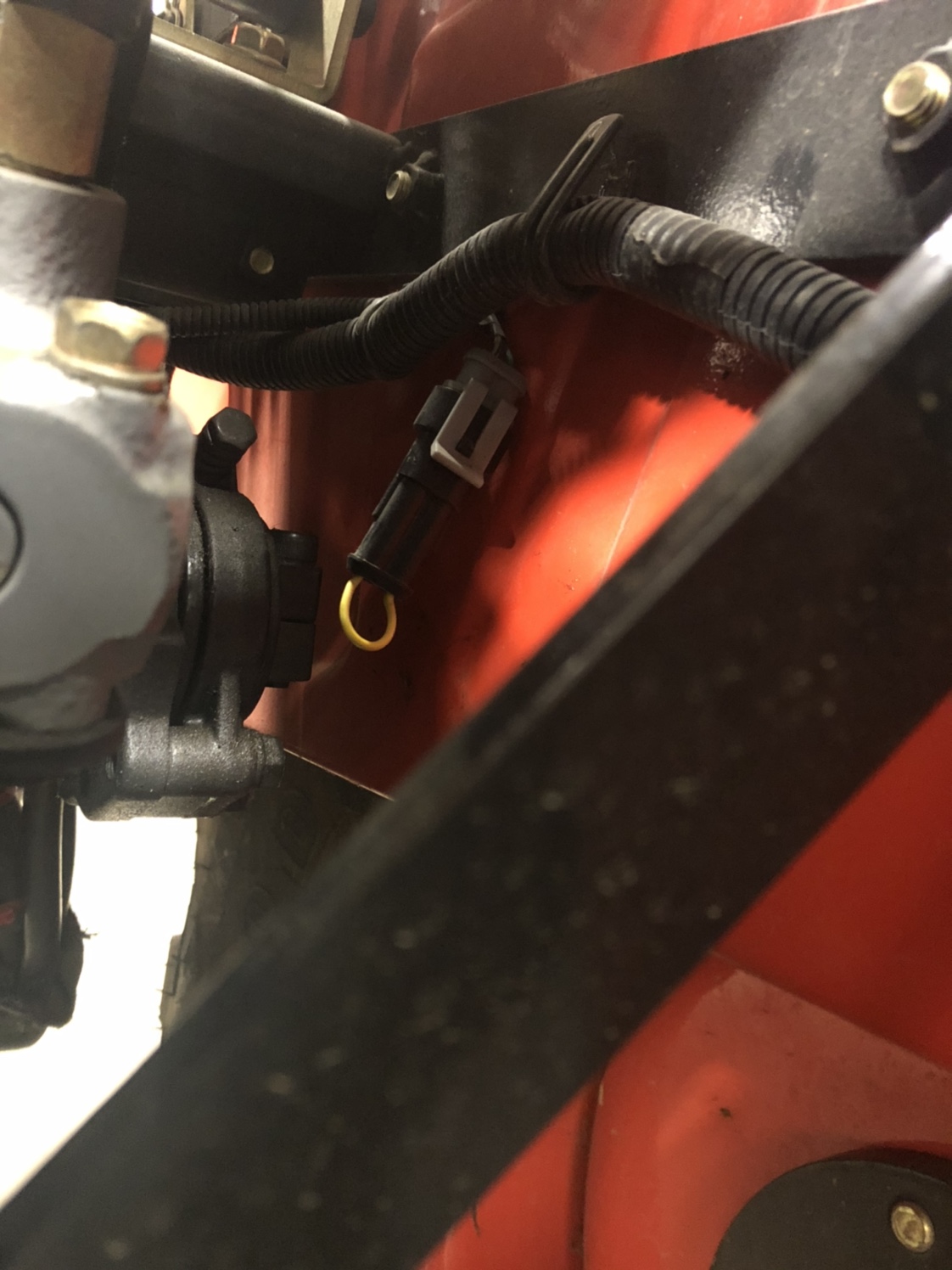

Hey guys so at the back of tractor I found this wire harness wondering is this like a power source I can tie my LEDs into or? IMG_4431.JPG
   / Light bar #36
Hey guys so at the back of tractor I found this wire harness wondering is this like a power source I can tie my LEDs into or? View attachment 674934
It probably is and could well be already 'hard wired' to your Light-Selector switch, which means that the circuit is fused... I know that this is the case with my 4105 and I connected a, ROPS mounted, 6-lamp LED light bar to my connection.
A volt meter will confirm when the Light-Selector switch is turned to the correct position.
   / Light bar #37
I don't think it is a power point. It has a jumper connector shorting the two wires. Probably a seat safety switch connector for a model which uses a seat with pressure switch.

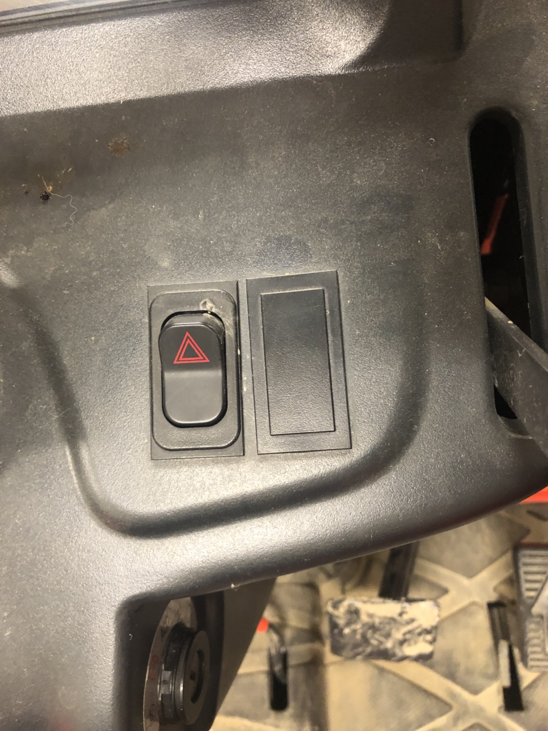

Hey guys so just wondering if anyone knows if kioti has a factory 2 way switch that I can put in this blank spot for my lights? I want it to look clean so was hoping to have a switch that fit right in this blank spot with out having to cut anything. IMG_4433.JPG
