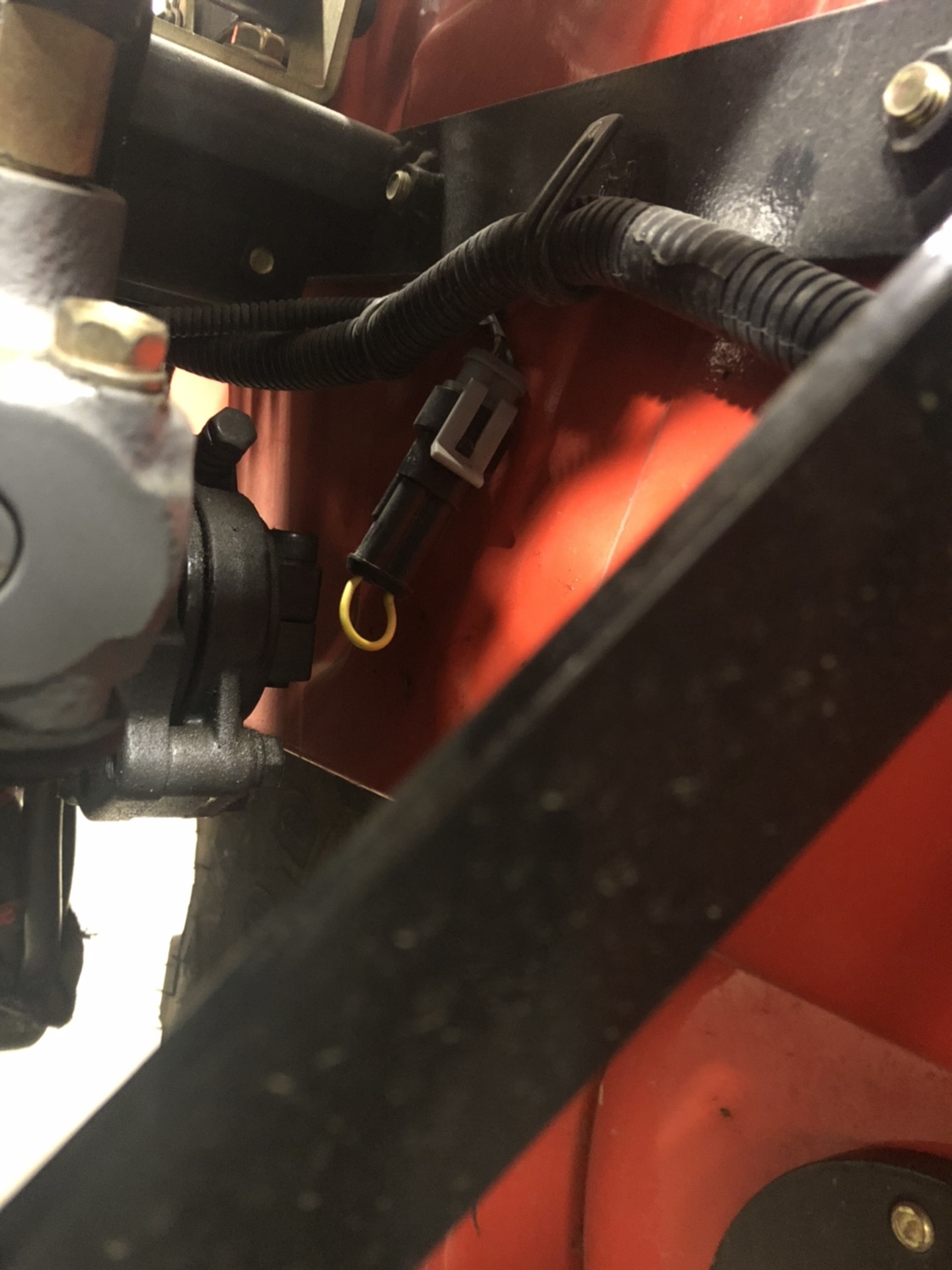

Hey guys so at the back of tractor I found this wire harness wondering is this like a power source I can tie my LEDs into or? IMG_4431.JPG
/ Light bar #36
Hey guys so at the back of tractor I found this wire harness wondering is this like a power source I can tie my LEDs into or? View attachment 674934
It probably is and could well be already 'hard wired' to your Light-Selector switch, which means that the circuit is fused... I know that this is the case with my 4105 and I connected a, ROPS mounted, 6-lamp LED light bar to my connection.
A volt meter will confirm when the Light-Selector switch is turned to the correct position.

I don't think it is a power point. It has a jumper connector shorting the two wires. Probably a seat safety switch connector for a model which uses a seat with pressure switch.
