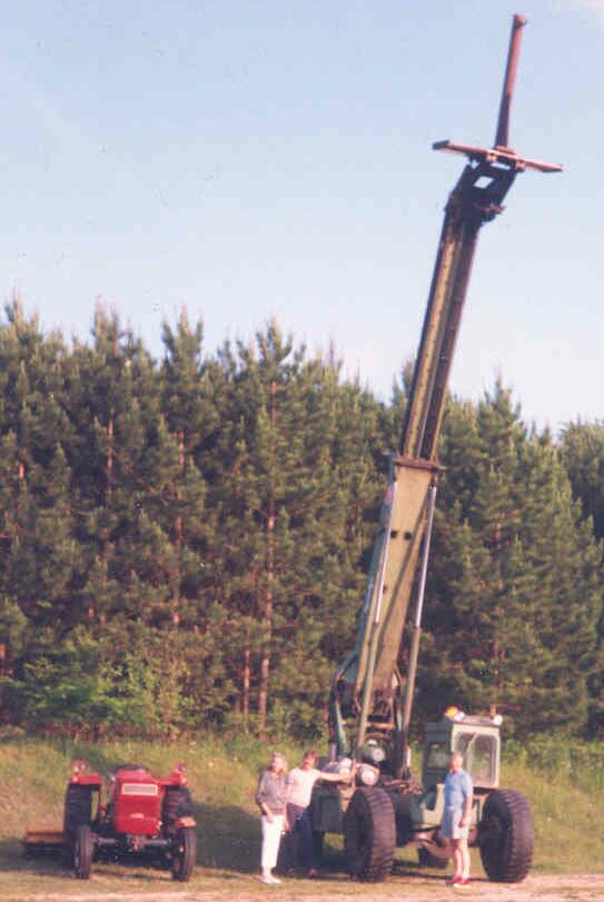

We had the Tractor on the Left as our only machine for Decades with no FEL. Then upgraded to the machine on the right. lol 8000# Lift.
We used a Boom Pole a lot on the tractor, but of course it is no good for pallets.
