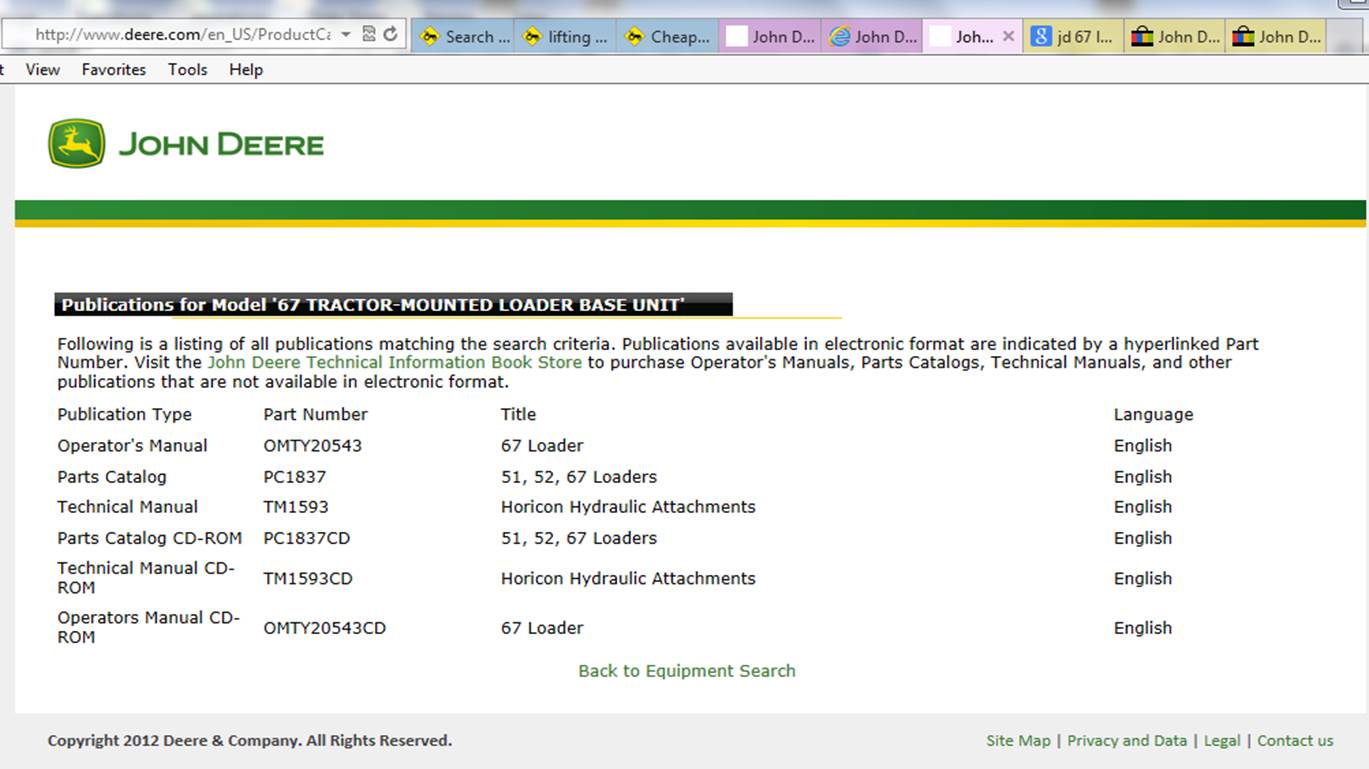

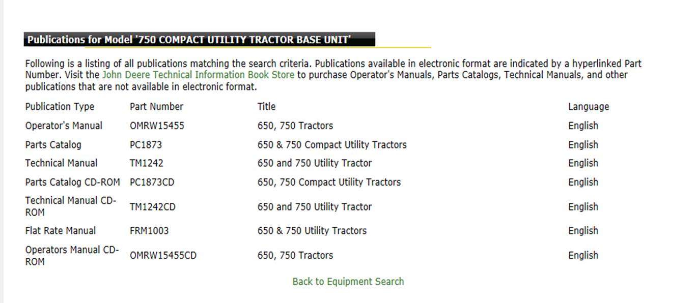

Chris . where did you get the manual for the loaded ?
I did a few searches , but didn't come up with anything .
thanks
Joe
/ lifting capacity JD 750 with Model 67 loader #9
Maybe this will help. They might be available from your JD dealer. Or course you can always search ebay.
John Deere Ag - New Equipment: Technical Publications - Publications Search
FYI... If you push the control lever that moves the loader arms downward forward enough it will go into float and release all downward pressure. If I remember correctly there was a detent in the stroke, so there was some tactile feel the FEL is in float.
/ lifting capacity JD 750 with Model 67 loader #10
FYI... If you push the bucket down control lever forward enough it will go into float and release all downward pressure.
I think you meant to say if you push down the left lever, which controls the boom, not the bucket, it will put the boom in float mode.

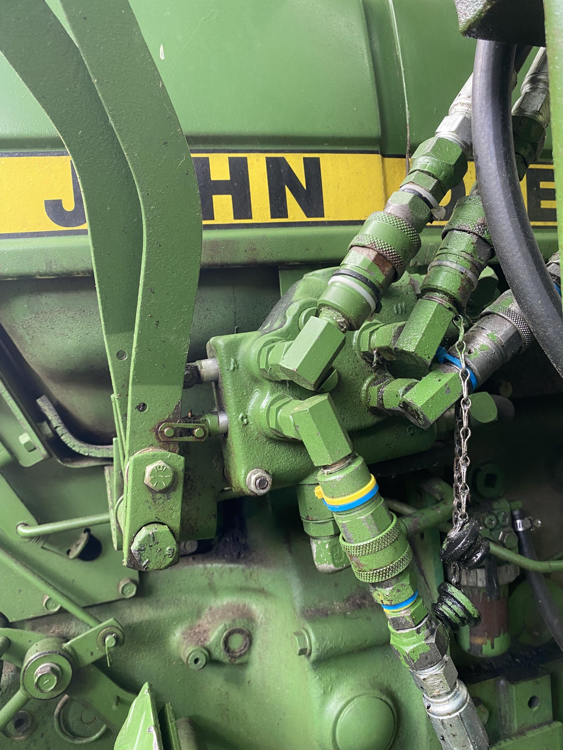

I've got the same set-up as the OP: JD750 with JD67 loader.
My selective valve / levers don't have any detent for float on the boom (left lever), nor does it have the small piece that would have been the mechanical block for the float option.
Anybody tried to rebuild one of these 2-lever SCVs? I've looked around but haven't found a parts / rebuild kit.
Would love to know what other folks have done over the years.
/ lifting capacity JD 750 with Model 67 loader #14
Post a pic or two showing the SCV valve that you have. Might come up with some helpful suggestions..
/ lifting capacity JD 750 with Model 67 loader #15
Doh! Should have thought of that.
Pics attached.
