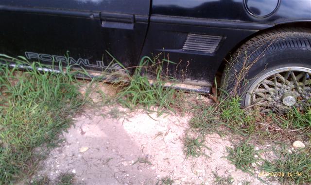

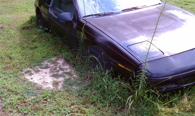

some good feedback, thanks. the car is a fiero, i left that out somehow in my original post.
the thing is sitting right down on the frame all around. I will take a pic next time I am over there.
he's in no hurry to move it, which is how it ended up in this condition anyway.
airing up the tires will not do it. i was worried that digging around it to try to get ramps in place might wake it worse.

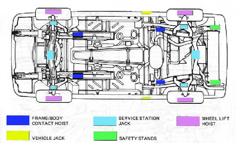

I also found there can be an issue with the cooling lines if the car is improperly lifted (below from wikipedia)
A second problem has become common since more Fieros are being serviced by auto repair shops that do not know their design very well. The underbody coolant tubes are positioned in a manner that a casual glance underneath the car may not suggest their fragility. As a result, many of them have been crushed by shop lifts, resulting in a near complete lack of engine cooling. The age of the car suggests that even General Motors dealerships may now be unaware of the proper jacking methods.

If you use the forks under the rocker panel remember there are some stainless steel cooling lines along the side.
To jack there is a spot right in the middle of the rocker panel as the jack point. The whole side lifts up. There are also rear and front cross members as well as the bottom of the A frames on the suspension.

Here are a couple pics. I will inquire with the local Fire Dept and the County Heavy Rescue to see if they are interested in doing it as a training exercise, that's a good idea.
