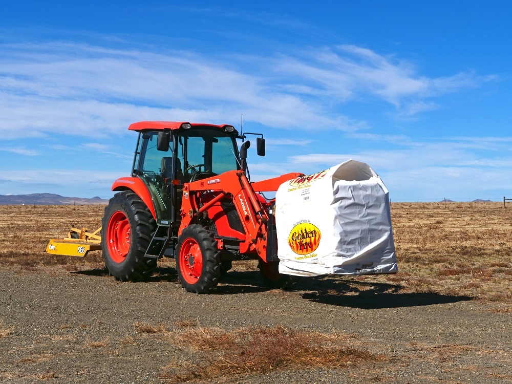

I unload my wood pellets with my Kubota M7060HDC12 every year. I have to have my rotary mower on the 3-point hitch or all I do is lift the back of the tractor in the air. Keep in mind all that weight is several feet in front of the front axle - tremendous leverage taking weight off the back of the tractor. And if I don't pump up the front tires to at least 30 psi, when I lift the pallet the tires look like they've gone flat.
Either one of my M9's will lift and stack (I stack then 2 high in the barn) no issue with nothing on the back end, never been a problem. I do have it in FWA however. No loaded tires either but I do have the factory cast centers in the rear wheels. ATI SSQA pallet forks. Never had issue one with front bearings either and I'm regularly shuttling 4x5 round bales around fiekds and loading them on semi trailers too. All that has ever been replaced is one king pin and bushings on the left side of the open station M9 last year at 5500 hours.
