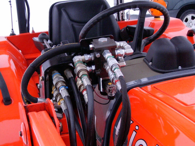

It wouldn't be hard to add an electric diverter valve to control the 4 in 1 up front. Cost a few hundred bucks.
   / Lift kit for tractor #43
Something like this 12v electric diverter valve, plus some fittings and hoses, and some wires and a button on the joystick would allow you to make one of your existing joystick motions do double duty. For example, you currently have lift/lower and dump/curl functions on your joystick.
Install this valve out on your loader arms in a safe location (put a guard over it to protect it if necessary). Disconnect your hoses feeding your dump/curl cylinder and connect them to the P1 and P2 ports on this valve. Then run two new hoses to your dump/curl cylinder from the A & B ports on the new valve. Then two more hoses from the C & D ports on the valve to the cylinder(s) on the 4-in-one bucket. Finally, run the wires to the 12V and a momentary or click-on-click-off button mounted on your joystick ball (by your thumb or index finger would be nice).
Then, click the button once and you have normal dump/curl function. Click it again and you can open and close the 4-in-1 bucket. Click again and you're back to dump/curl.

I have the same or very similar valve setup for angling my snow plow.
I have normal loader control, push and hold the button use my loader control to angle the snow plow, release the button and I'm back to normal loader control. HPIM1550.JPG

On Power Tracs we have a third valve on the loader valve that operates the quick attach. But the lever is down by your right knee. The quick attach cylinder hoses have quick disconnects, so if you need to power something like my power angle snow plow, you move the hoses from the quick attach cylinder to the plow cylinder and operate the angling from the knee lever. I'd like to put in an electric solenoid like the one I've linked to and operate it off of the dump/curl circuit with a thumb button mounted into my joystick ball handle. Some day when I have a spare $250-300 I'll do it.
