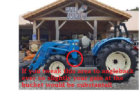

I can't find a good detail of the loader mount but if all you load is light stuff like mulch while on level and stable ground look at tweaking the loader mount a little. An ever so slight backward tilt will be multiplied many times at the bucket. It's going to shorten the reach, but not as much as it will increase the height. Remember, this advice is worth what you paid for it.
EDIT to add: You could accomplish the same thing by firming up air pressure in the fronts and lowering air pressure in the rears.

Take a look at Kubota's larger loaders. They have two positions on the towers for the lift cylinder. The upper position adds lift height at the expense of some capacity. From the picture in square1's post it looks like it would be pretty easy to do. Messicks has a video on the M7060 I believe that Neal points out that feature. That might be the cheapest solution if you have the capacity to spare.
