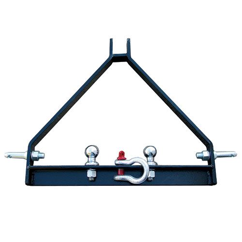

Jeff, don't see why the boom pole wouldn't work. I'm assuming your pulling harrow off the hitch?
Yes. Pull Ring on Chain Harrow goes over trailer ball on Handi Hitch. We could easily pull the Chain Harrow from the center drawbar, rather than the Handi Hitch, freeing the Three Point Hitch for a Boom Pole.
Any suggestions on rigging?

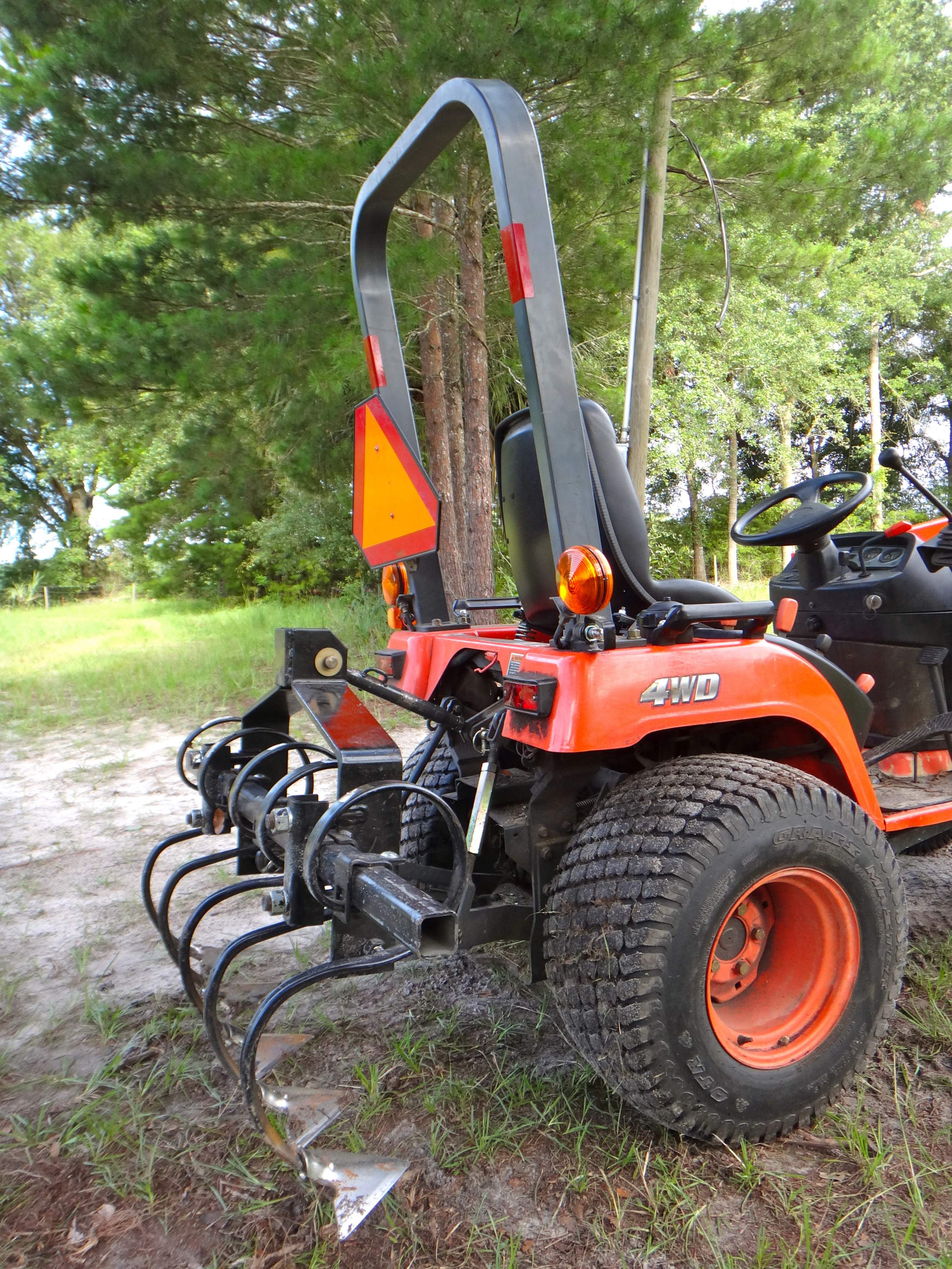

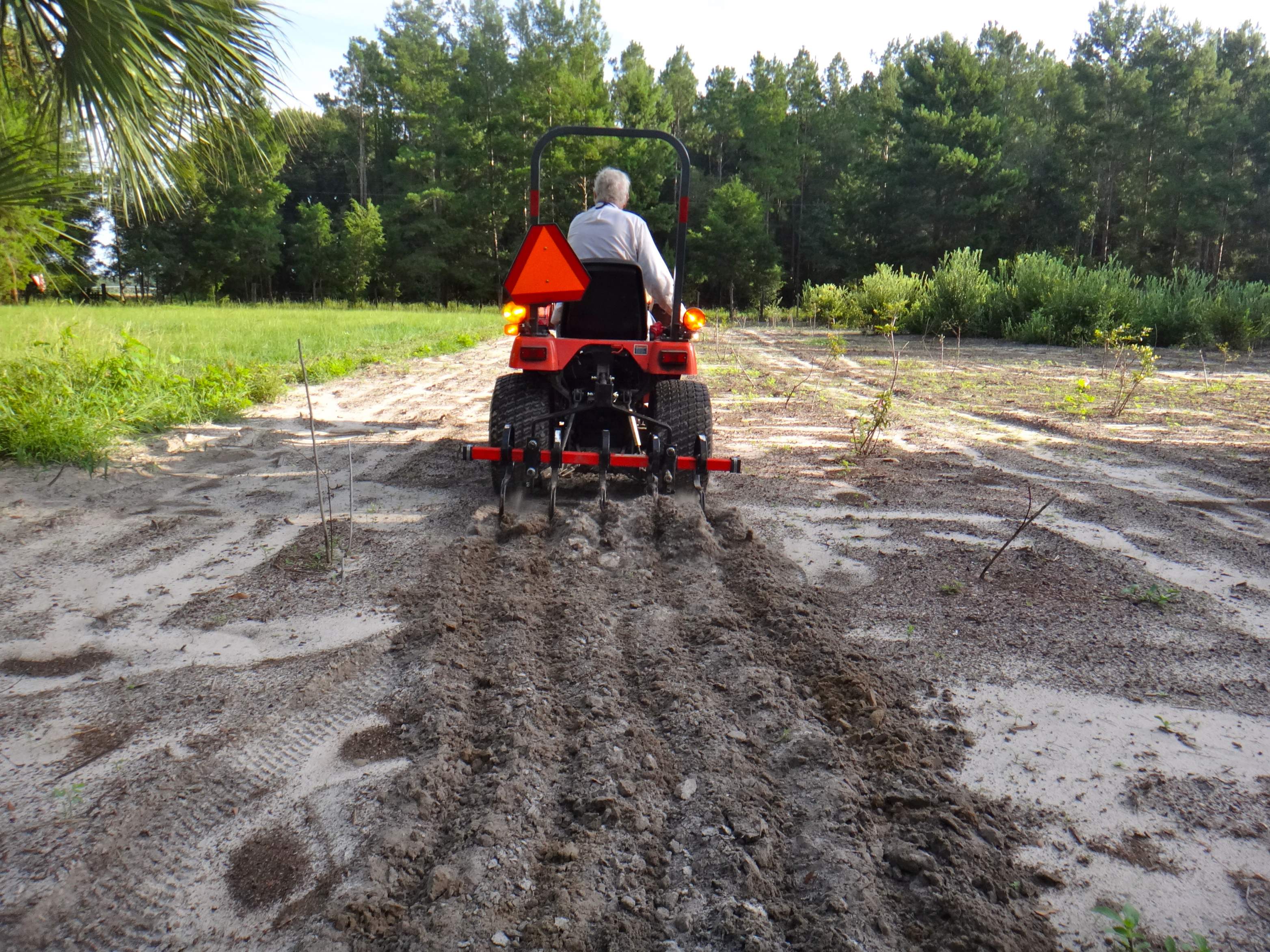

The Blueberry patch has used a TSC 'Loyal' (brand) Chain Harrow in size 4' X 4' for three years. Teamed with a Woodward Crossing's (brand) Tool Bar Cultivator for deeper rooted weeds, the two implements have served well for organic weed control in the rows. All we need is a mechanism to lift the Chain Harrow so we can shake out accumulated weeds and Blueberry trimmings with less human commitment.
I power a Korean Hoe for close-in weed control. We sow Buckwheat near the plants in the Spring to shade/crowd out weeds. This is pretty effective March-June, when the Buckwheat has cycled and dies. Then back to the Korean Hoe.
Based on the contributions to this thread, especially BCP's video in Post #15, TSC's CountyLine (brand) Three Point Hitch mounted, lightweight Boom Pole appears a practical solution: inexpensive and two functions, mat lift and 1,000 pound capacity crane. As the Chain Harrow mat is only 4' wide, with the boom in the middle mat overlap will be scant 2' on each side of the boom, so the boom-to-mat mounting chains will be close to vertical.
Fortuitously, TSC sent me a 10% OFF coupon last week.
Fine fabrication evident in your two photos. :construction:
