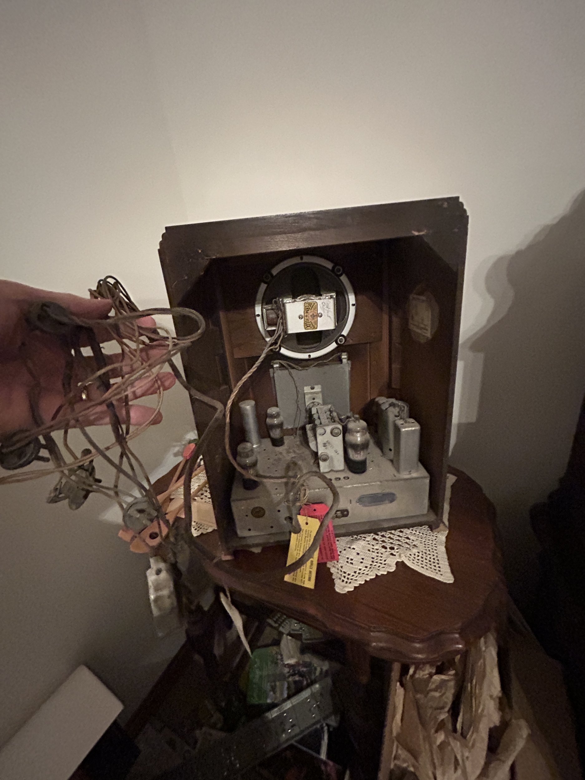

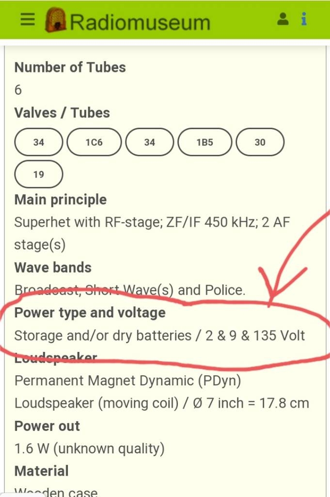

That's beautiful & I collect & repair old radios. If it's battery power it probably takes an A-B battery, heater filaments low voltage (1.5,3v,) and B+ (90v)for cathodes.
If I know tube numbers I can tell a lot by that and if battery connector has 2 or 3 wires.
Maybe a picture of the backside?

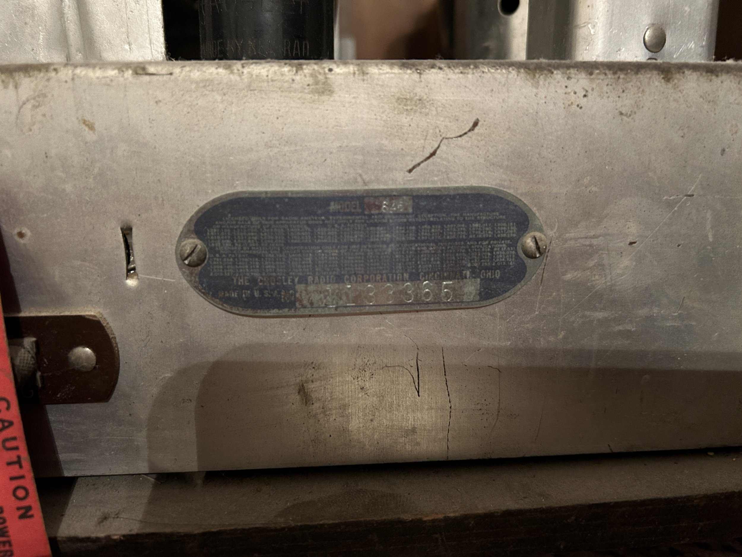

Crosley radio corp, Cincinnati Ohio
The cable has 2 big alligator clips, 5 other connectors.

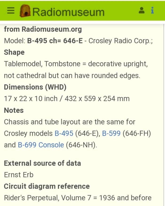

In the 80s I bought an antique radio guide book by Martin Bunis. I see books now on Amazon by Marty...probably his son. I called Martin and traded him transistor for tube radios one for one. He would say your Crosley "tombstone" has maximum value because it's complete and in excellent condition. Collectors don't care if it works.
It's possible it works but really needs tubes tested first. Batteries you're better off making a power supply:
