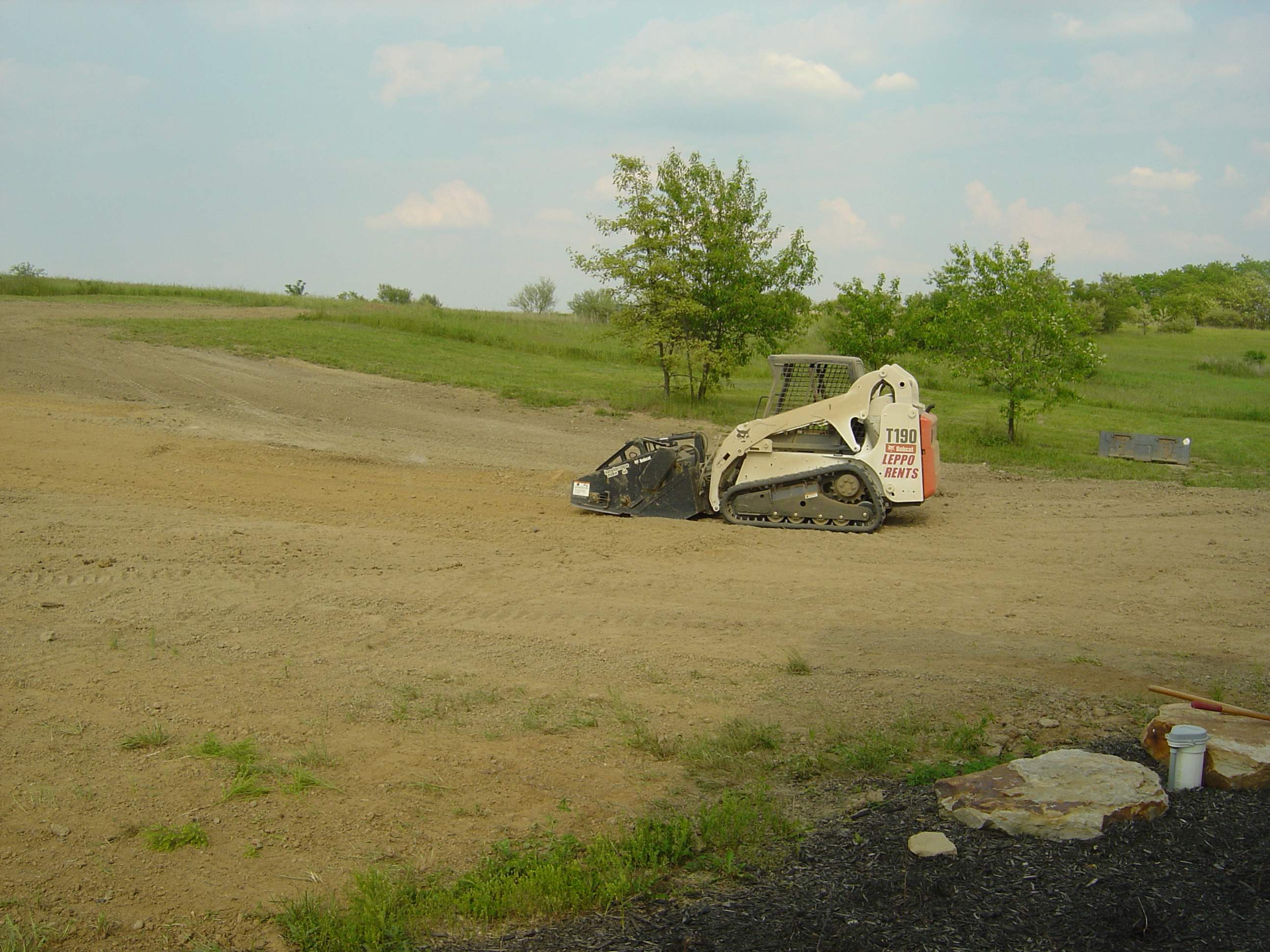

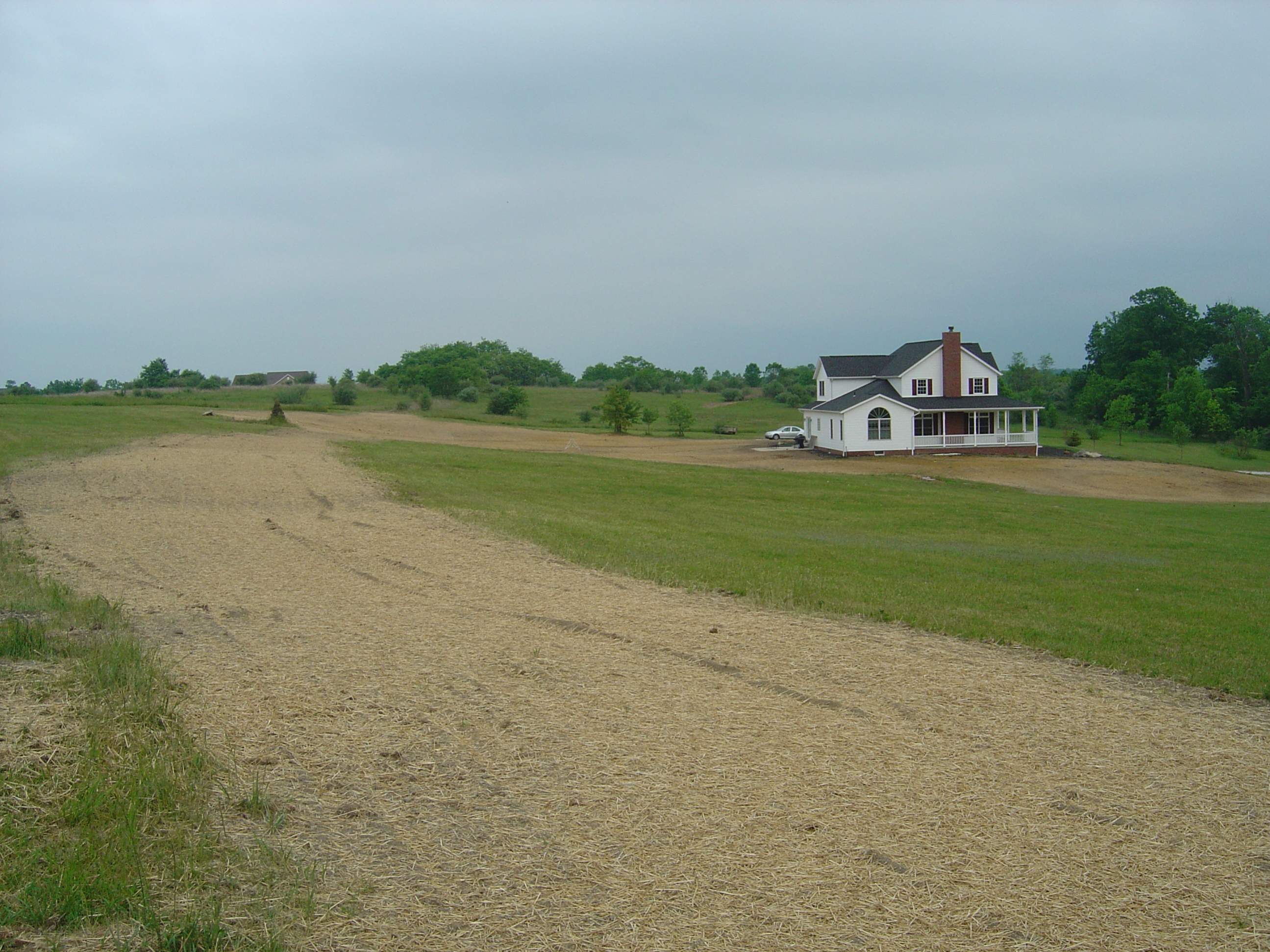

I have used both in extensive plantings at my house. I built on reclaimed strip ground, so moving earth, removing rocks, and adding/smoothing soil were all jobs I encountered in doing the work. As posted above, the box blade works best for leveling and moving dirt, and the rockhound is best for removing the rocks along with prepping the soil. The pulverizer works extremely well, but I had way too many rocks to remove to use it effectively.
The rockhound I used (I think there are several types) was a rental attached to a bobcat (see picture), and removed rocks and prepped the soil.
I was able to rockhound the entire area you see pictured twice (some areas three times) in eight engine hours (my rental agreement). It is a fast and efficient tool.
So, I guess my longwinded advice is use both.

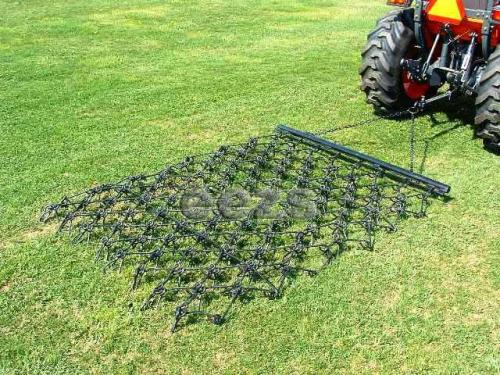

All good suggestions. I appreciate them. What would happen if I drag a chain harrow like this around a couple of dozen times. Do you think it would level the land an inch or two?
I'm somewhat torn between renting a piece of equipment and buying this. I could use this later to groom the atv track. What do you think? I found this harrow here
I forgot to add, rocks are not much of an issue. When I tilled a large area last spring there were virtually no rocks. Perhaps the farmer that owned the land before me removed them, that or they're just big rocks. I've found several large rocks. The soil is a sandy loam (Canfield loam?). It's easily broken up in the spring.
I'm somewhat torn between renting a piece of equipment and buying this. I could use this later to groom the atv track. What do you think. I found this harrow here
That could work too.
A couple of dozen times ? Yeah, maybe.
You would be ripping out grass and weed roots, disturbing rocks (that you could then pick up), etc. and as you say, buying something to keep and use again and again.
The required skill level is minimal, i.e. you would be hard pressed to worsen things with a chain harrow.
One thing you would NOT be doing much of is fluffing up the dirt/soil and that is something you would have to pack down again if you did almost any of the rock-hound, box blade, tiller, dozer alternatives.
If you DON'T pack it down the go-cart will quickly rut it up pretty badly, so whatever you use plan a compacting/rollering phase somewhere near the end.
Chain harrows can usually be reversed and/or flipped over to get two or three degrees of "cut", the finest of these would be good for a Spring time raking and re-leveling.
