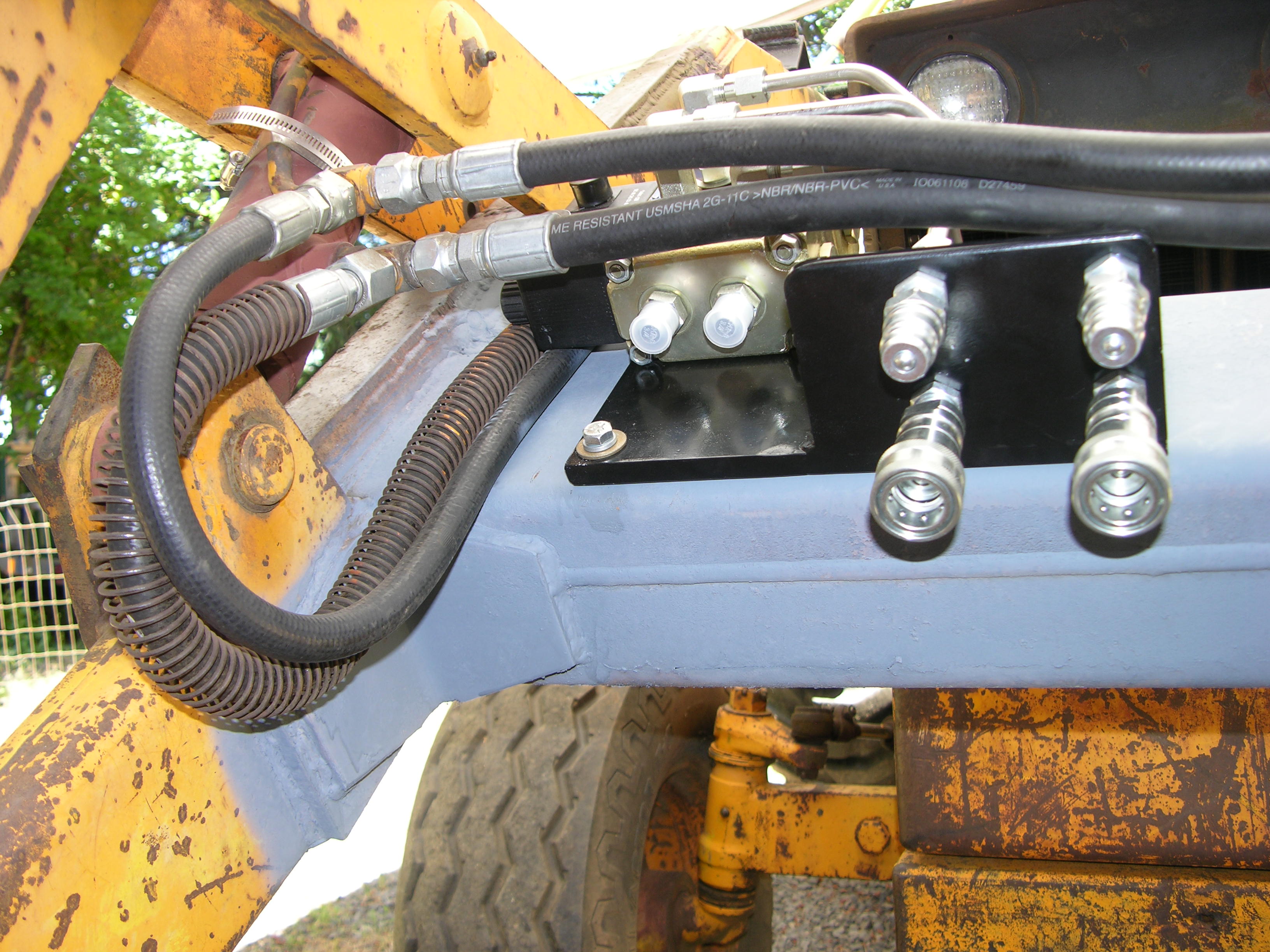

Richard, if you're confused then so am I - (as in, I agree with all you wrote) - when I get back to finishing my hydraulic mods and QA loader mods, this is what'll be mounted ala your New Holland comment
Neither of my non-backhoe tractors have FEL's, right now the Long has just a single remote (toplink at the moment) and the Allis has a mechanical diverter for its single remote, currently used as TnT. Soon as I get the ripper cylinder rebuilt on the Gannon box I'm gonna want a "3rd function" :laughing: so I'll replace the mechanical diverter with a PAIR of these
6.6 GPM 12 Volt DC Double Selector Valve DFE:D | Selector Valves | Hydraulic Valves | Hydraulics | www.surpluscenter.com
Still to be ordered - there's nothing on that rig that needs speed (those valves are SAE 4), plus it's hard to beat the price - they're stackable, so I'll fab up a plate similar to the other pics. The ones in the pics (for the 580B) will be controlled with a Scorpion handle; 1 trigger switch and 2 push buttons, it'll replace the knob on the loader joystick. Haven't got around to a scheme for control of the new diverters yet.
I had bought a 4-valve stack for the Allis (used for Gannon, 6' tiller, etc) but decided to steal that for the 580B (got a few small cylinders and plans for articulated brush cutter, + a thumb)
Warning for those new to hydraulics - do NOT think those cheaper diverters are a cheaper option if you do NOT wanna limit something ELSE's flow; the function you "borrow" has to go THROUGH the diverter to do its original "thang", so you do NOT want a lower flow diverter than the other valves on your tractor... Steve
