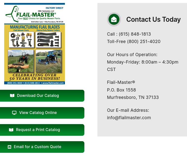

Hi I am hoping someone can point me in the right direction. I have a Seppi offset orchard mulcher that takes the SMW hammers and am looking to replace them and the bolts and nuts that hold them in place. I have bought from flail Master in the past but they are out of business and was hoping that someone had a place they were getting hammers from. Can anyone point me in the right direction?
   / Let's talk flail mowers #7,928
Website:
   / Let's talk flail mowers #7,929
Flail Master is alive, well and doing business.
Hey thanks for that do you have a contact number? I found them today and will call them later today. Thanks again!
   / Let's talk flail mowers #7,930
Website:
Thanks for your help!
