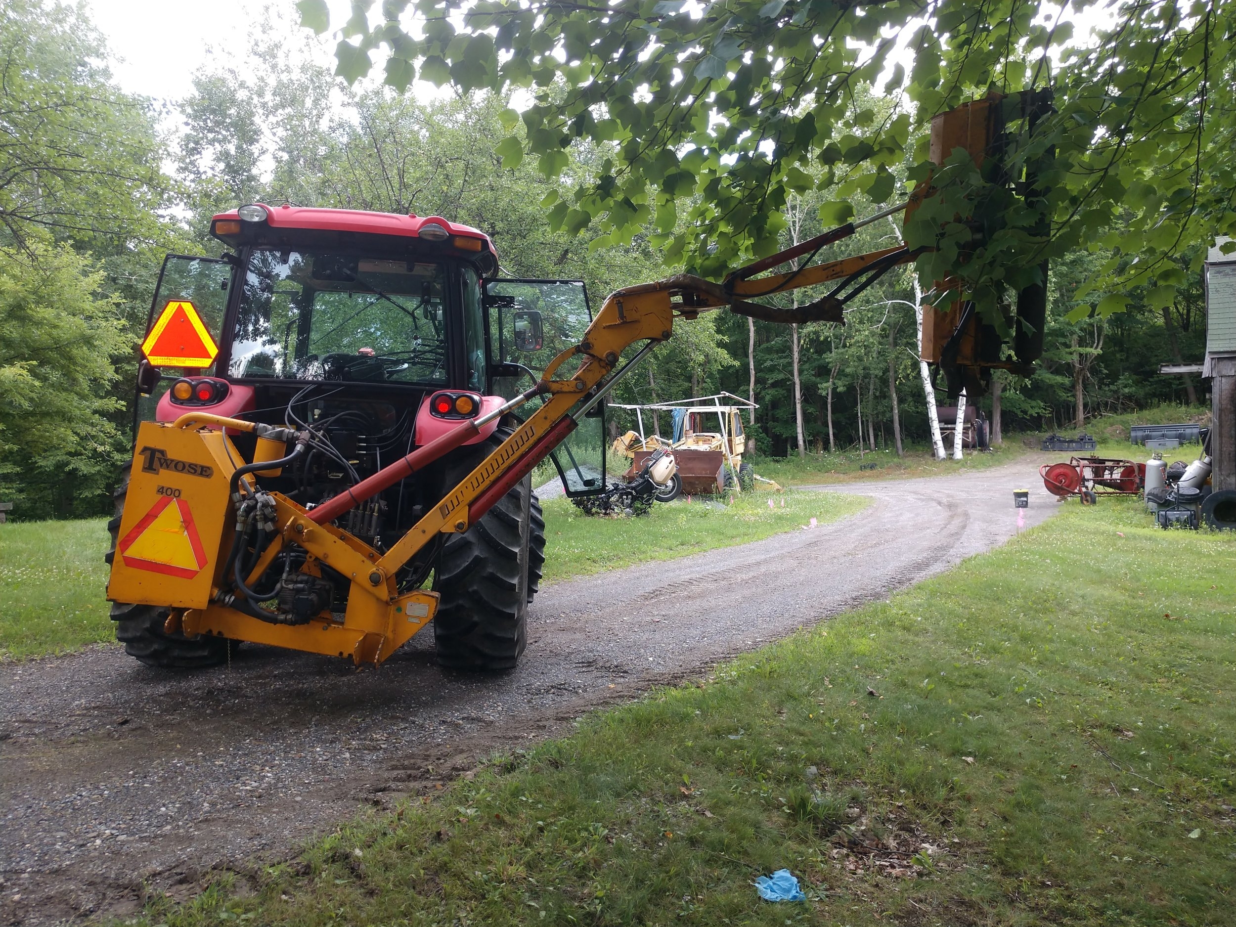

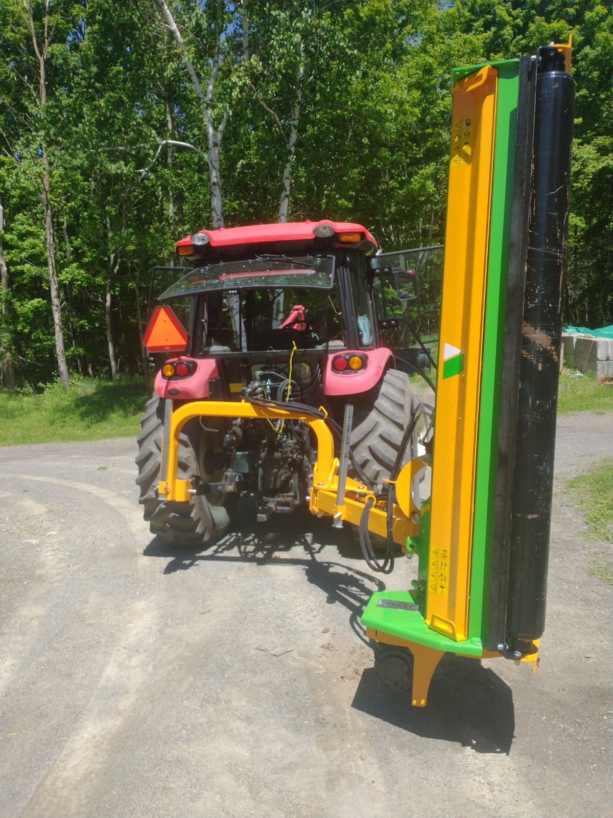

My flail mowers can mow in the vertical position,
one of them is a 78" and it bounces a 10,000 tractor around,
the other is a 48" boom arm mower and it also is the maximum mower I'd want on my tractor.

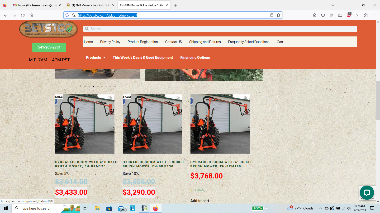

I wouldn't recommend these types for a tractor your size.
They do make sickle bar mowers that will trim smaller sized brush and limbs.
FH-BRM Boom Sickle Hedge Cutter | Betstco Sales, Parts, and Service:

That sickle is interesting, looked a little fussy in their video, but I'll think on it a little.

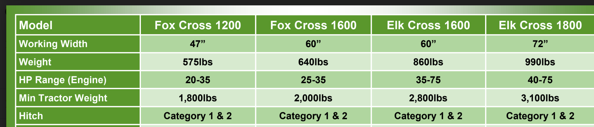

Yeah, I'm just getting advice all over the place, trying to compare apples to apples. Peruzzo lists pretty mowers as compatible with smaller tractors. My advice from a Del Morino dealer was more conservative. I'm not trying to be argumentative, but the only chart, or rule of thumb I have is the one attached.
