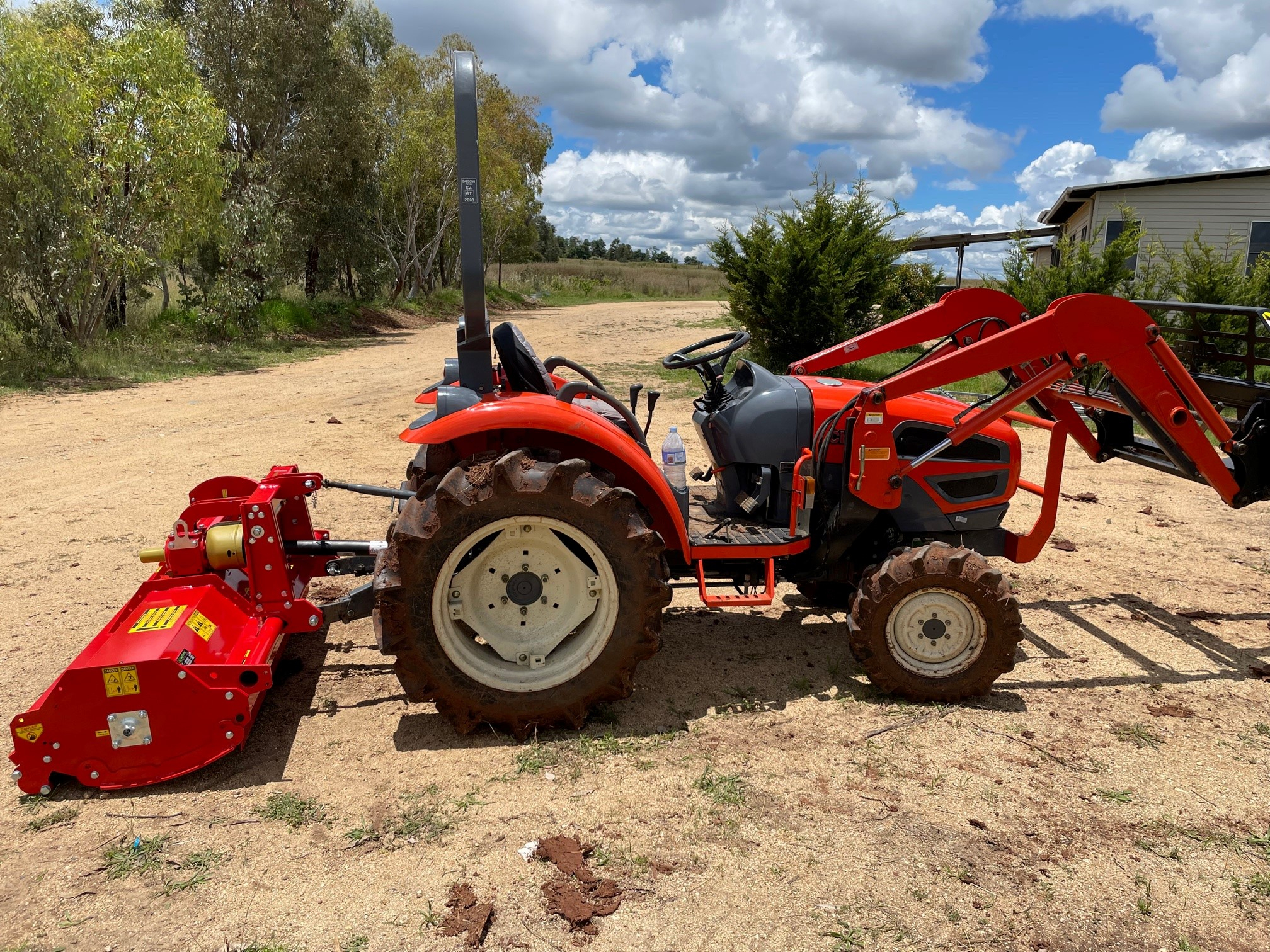

Hi Guys,
I had hoped to get to the end of this thread before I posted my request for opinions ... currently on page 535, but have found myself in the situation where I need to make a decision ... so ...
I have a CK30 - gear tractor with 23PTO HP ... 3PL lift at 1764 lbs
As I am in Australia, we do have a somewhat limited range of available flails ... and due to current conditions, an even more limited range of what's actually in stock (or in stock soon). Looking at the manufacturers recommended specifications, most (if not all) recommend a higher PTO power than what I currently have, but using the mantra on this forum - "if you can lift it, you can turn it", and "5hp per foot" ... I am looking a 5ft wide mowers.
I have 30 acres of flat to sloping ground. It's an equestrian facility, so we have horses to do alot of the pasture mowing. As horses are fussy eaters, they tend to eat parts of the paddocks (2.5 - 5 acres) down to 1" ... and leave parts to grow to 8". I intend to use the flail to mow down to about 2" ... mulch and spread the manure piles, and then leave the pastures to recover to about 4" before putting horses back. The property is fairly good, with only small areas of some woody weeds, and a couple of blackberry patches I am trying to control.
So .... my choices seem to be between
Hayes - Chinese made - just over 5ft - manual side shift - weights about 1124 lbs - recommended HP @ 35 = around $5000
Muthing Eco-Top 160- German made - manual side shift - just over 5ft - weights around 770lbs - recommended HP @ 30 = around $8500
Del Morino Flipper 152 - Italian made - manual side shift - 62" - weights around 635 lbs - recommended HP @ 30 = around $6000
Berti Park/P 145 - Italian made - manual side shift - just under 5ft - weights around 825 lbs - recommended HP @ 25 = around $9200
all have hammer blades - seems difficult or special ordered (read: 4 month wait) to get Y blades.
Very interested in everyones feedback and opinions on the best options, and if I will "be able to turn" these effectively
Thanks
Andrew
Del Morino Flipper 158 delivered today ... and hooked up for a quick test flight!
I did a quick run around the outside of the small paddock, and it all seemed great. It handled the long grass with ease, and didn't strain the tractor whatever even going over the thick windrows left by the previous slashing ... although I did take it very slow and easy. As it's hammer blade equipped it didn't seem to mulch as much as I had originally thought, but there was lotsa grass (about 4ft high). I'll need to fiddle a bit with height adjustment (currently a bit too low), but I reckon will be a good unit.
Once it stop raining, I'll need to re-adjust the belt tensions and give it a couple of squirts of grease and I'll be flailing away .... lotsa grass to cut here after all the rain.
This thread has been great in helping me make the call on the right unit
Thanks
Andrew
