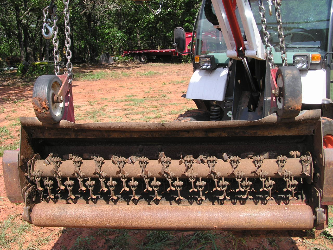

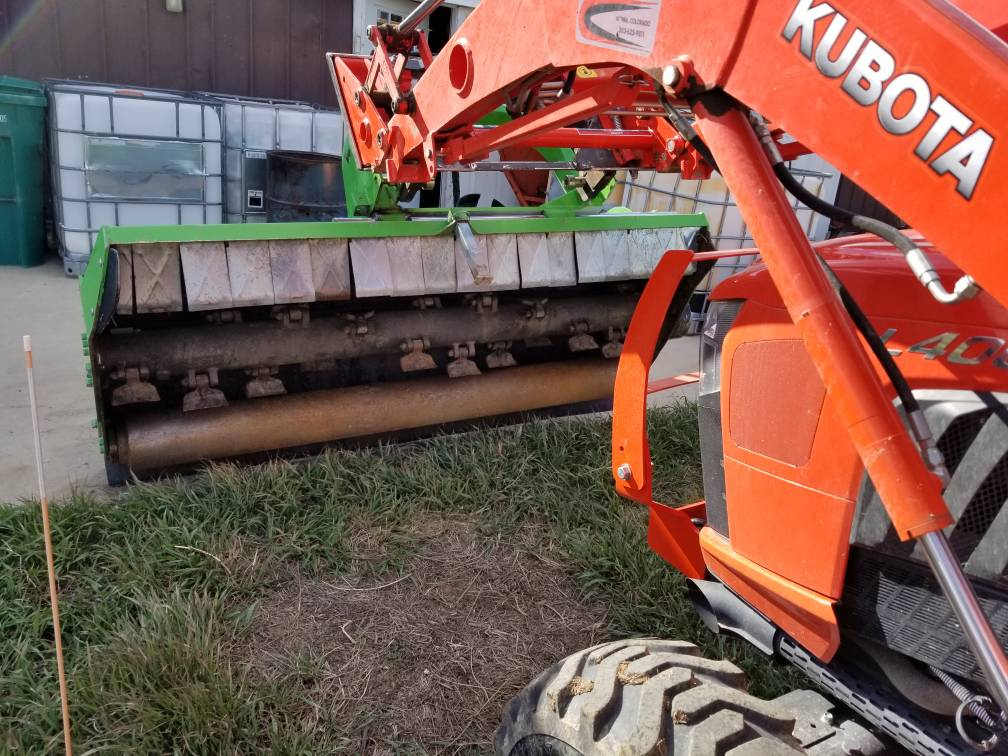

Hello all. I’ve read through much of this thread. I recently inherited a 10 year old Caroni TM1900 with Y knives. It seems to be in good shape other than the blades are mostly worn to nubs. Has anyone found a way to access and replace the blades by tipping the entire unit forwards or backwards? I’m really not comfortable working from underneath it. I’m fortunate to be near an Agri Supply store. What an amazing place :p.
   / Let's talk flail mowers #7,387
Hanging from the loader works:

Hello Jethro,
You do not have to lift it that high to work on it. You can drain the oil out of the gear box and then lift it enough to set it on its back to do all the major surgery.
Check the knife hangers as they are automatically suspect when you mentioned the knife condition as you probably need new hangers, bolts and nuts.
The best tool for this if you do not have smoke wrenches or an impact wrench is to use 12 point metric sockets and 12 point box end metric wrenches to remove the bolts and nuts.
You can use a 36 inch 1/2 inch drive breaker bar, 12 point metric socket and hard wood blocks to rest the wrench against to hold it in place.
Once you have the nut broken loose you can use a ratchet with a shallow socket to spin it off unless you have a 3/8 drive 90 degree impact wrench.
You will be able to tell whether you need to replace all the nuts and bolts with removing the first one. Use Blue loctite to secure the new nuts and bolts in place.
