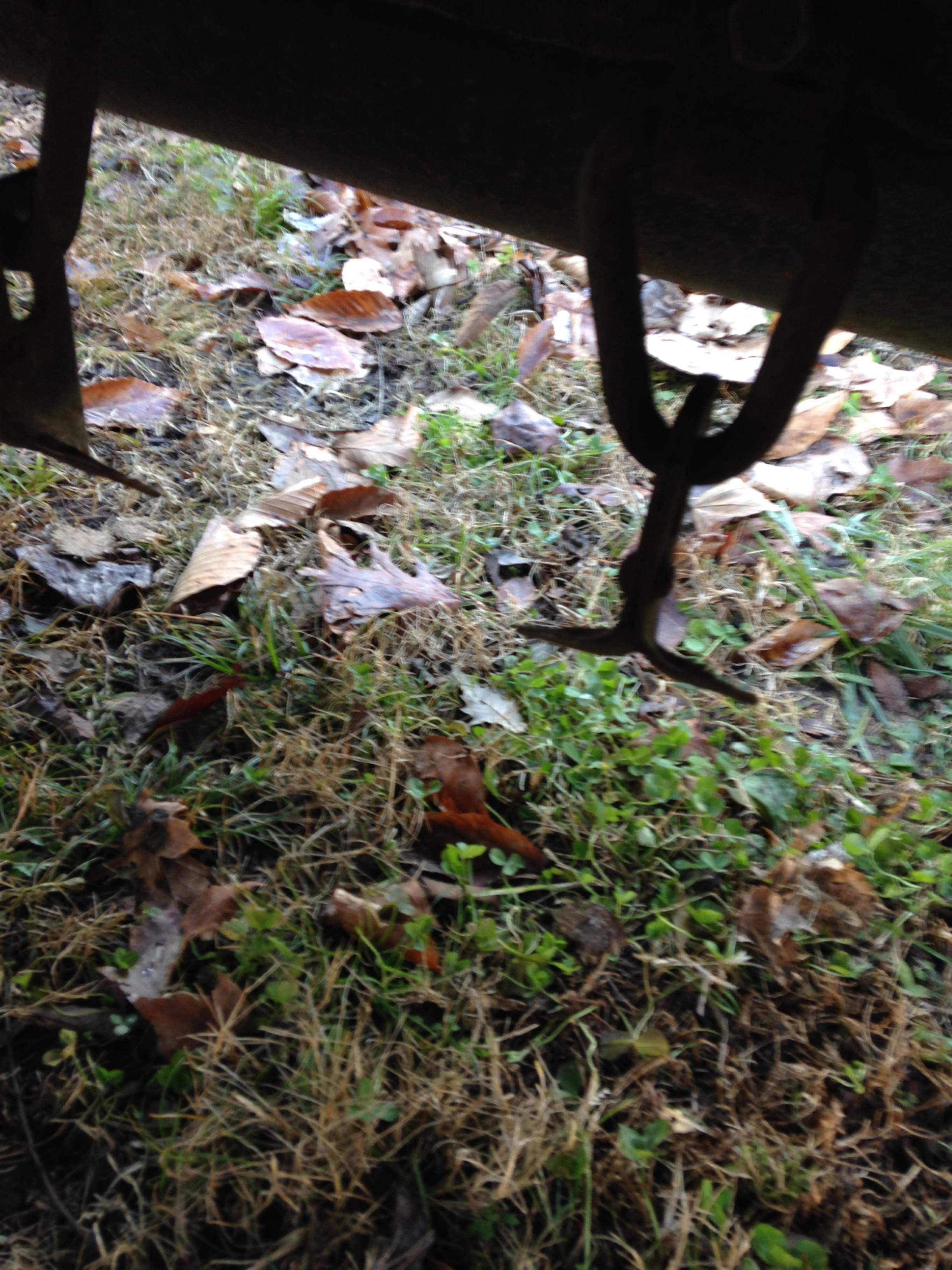

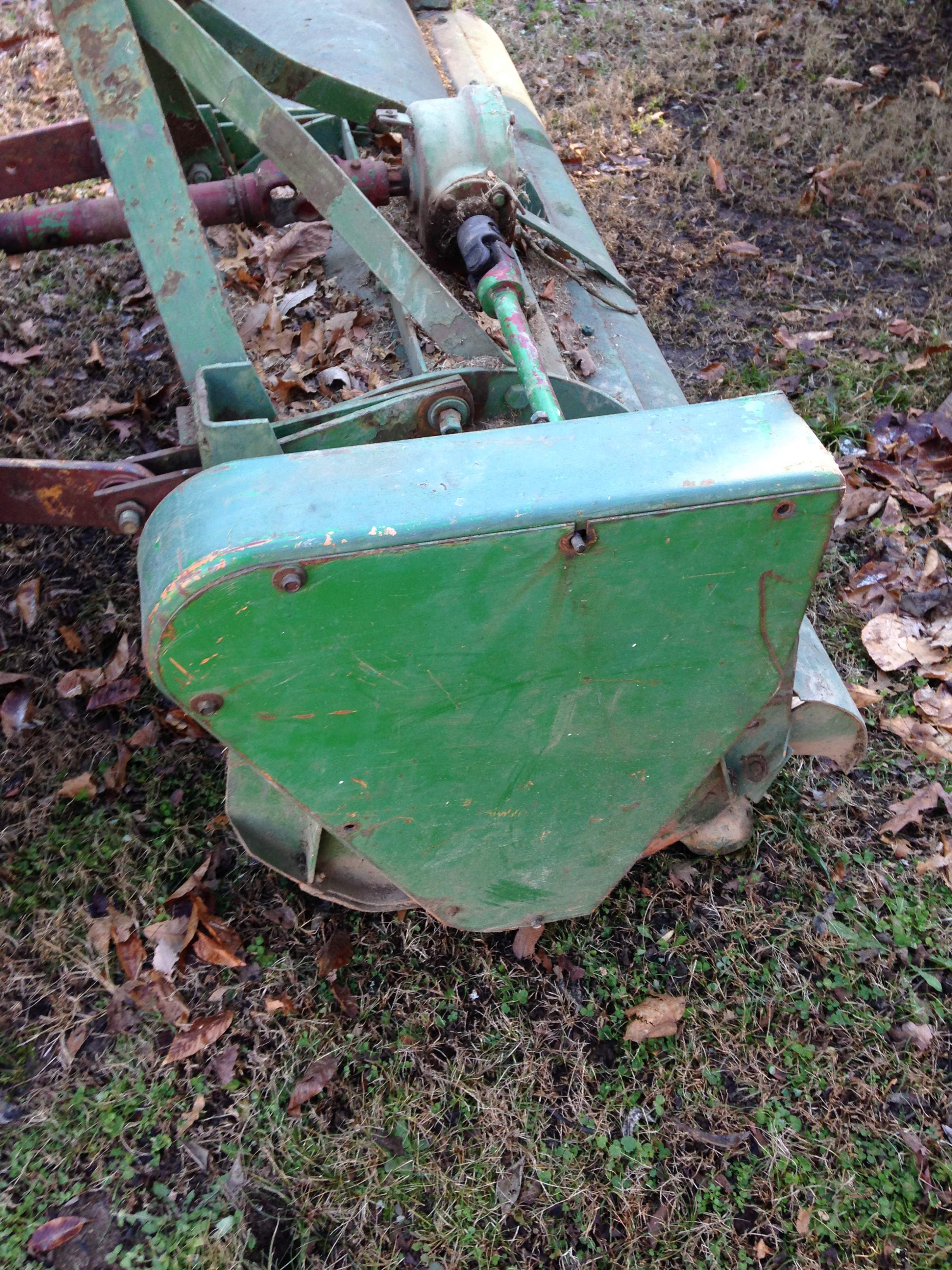

The old saying goes "what goes around comes around". Kinda true in my case with respect to this thread.
I started this epic flail mower thread back in 2008. I had become intrigued with flail mowers and wanted to know more. Well, as the thread started to unfold, I started to talk myself out of the idea. I owned and had owned rotary cutters for years. I knew how to use them and the low maintenance was and is attractive. The more I read in the earlier parts of the thread, the less I wanted a flail mower. Hydraulic oil bubbling out, belts breaking, difficulty in getting them set up, etc, etc, scared me away from the idea. I dropped out of the thread and did not follow it for most of its life.
Fast forward to late 2013. I ran across an old 917 Ford flail for sale. I decided what the heck. I'm not getting any younger and I guess a flail was still on my bucket list. So I bought the 917. I then proceeded to go back and read "Let's talk flail mowers" from beginning to end. Yep all 145 pages.
The mower is at my hunting property which is two hours from my home. It runs because the seller had it hooked up to his tractor and let me have a short test drive. He had recently replaced all the cutting knives. I plan on replacing the belt, checking the bearings and hopefully get it operational without a lot of work. We'll see. I will use it to cut the yard at my hunting cabin, some trails in the woods, and some food plots. It won't get a lot of use, but hopefully it will turn out to be useful. If nothing else, I will be able to make a check mark on my bucket list. As questions arise and I need advice, I'll be back. I know all you flail gurus will be here to help.
Here are a few pics.

Keep the bearings greased and it will outlive you. Good luck.

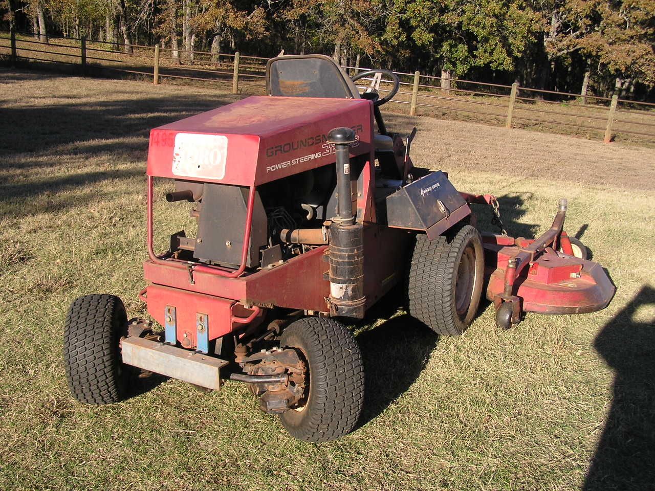

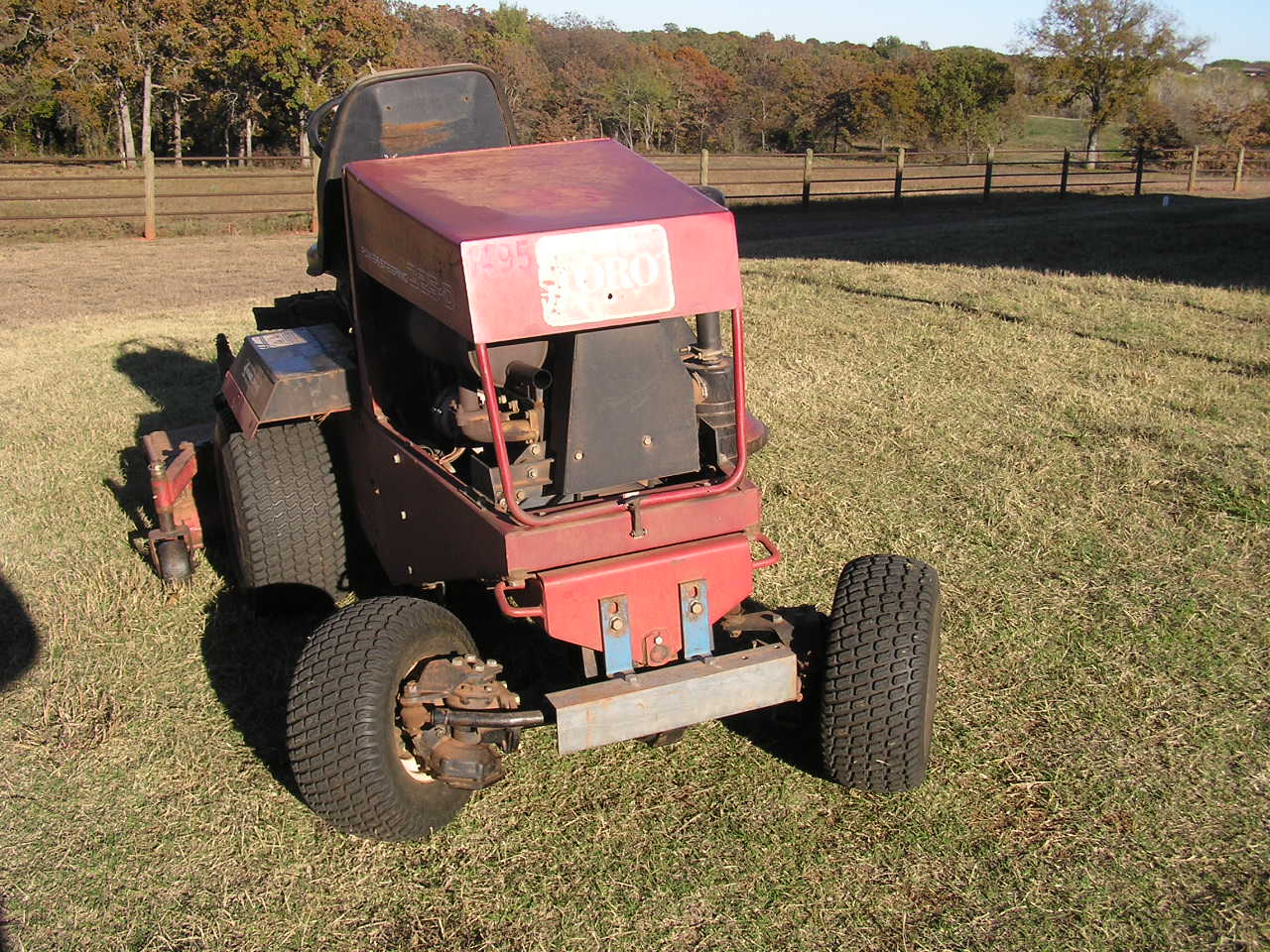

If you like your JD front deck, try to find a flail for it.
Here is my front deck 4WD TORO.
And the front flail deck that fits it.

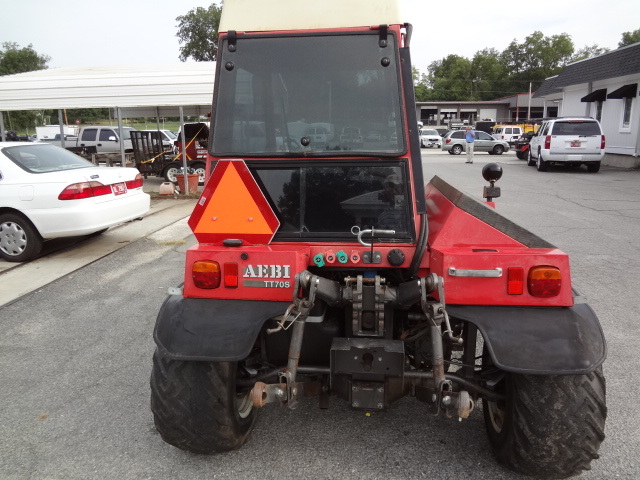

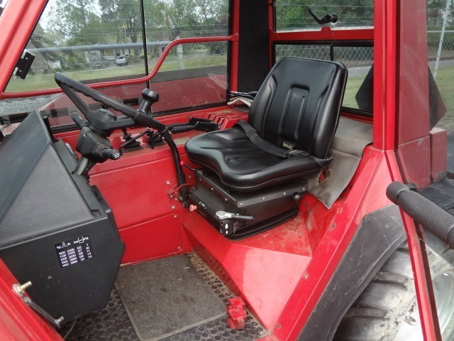

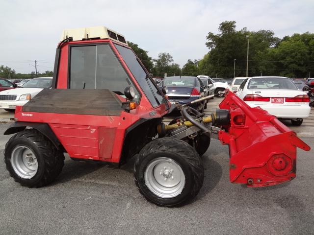

If you don't want to keep the JD, this would do the job. :laughing:
Pictures from an eBay listing.
